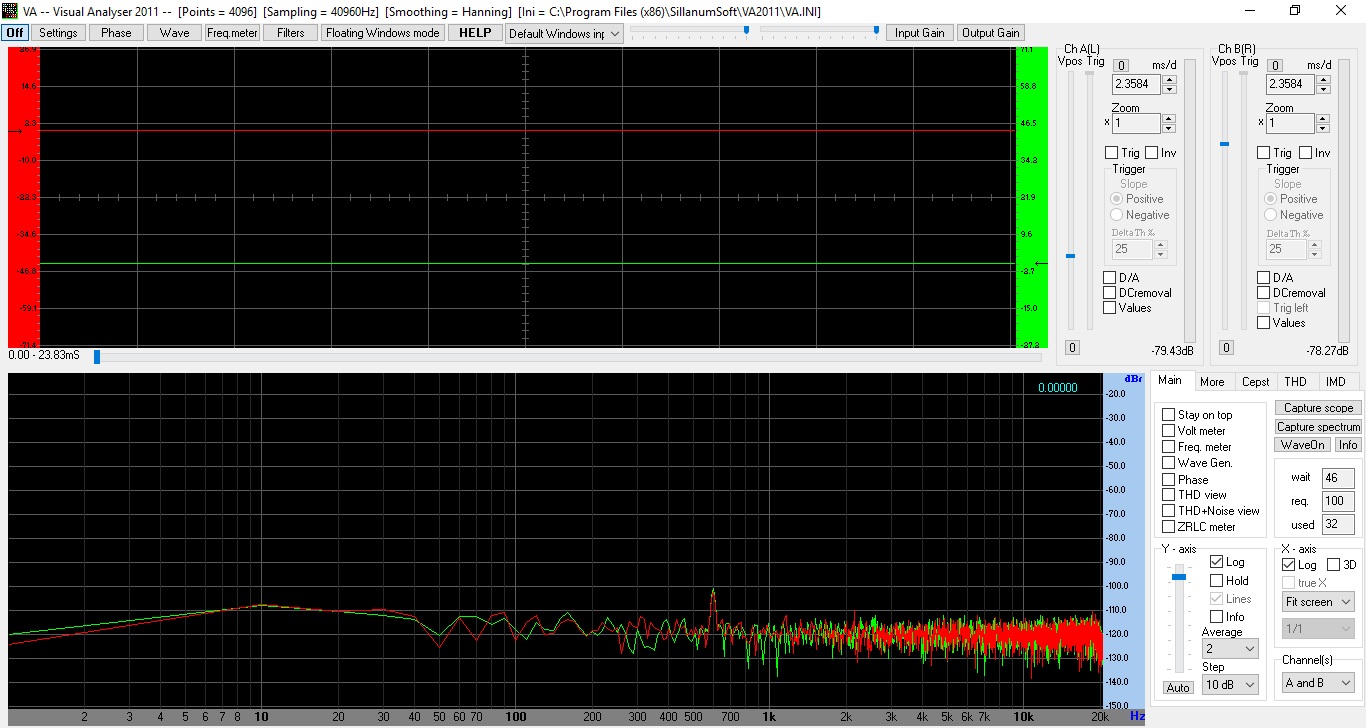

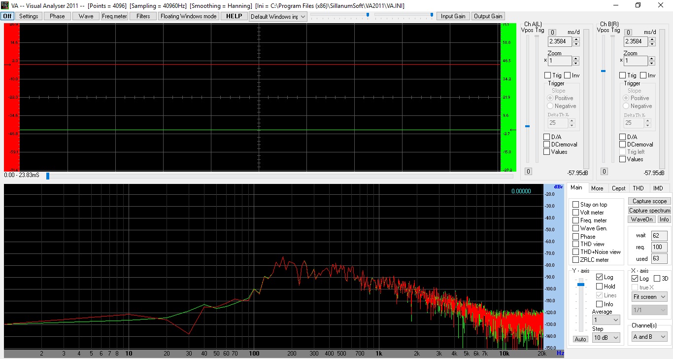

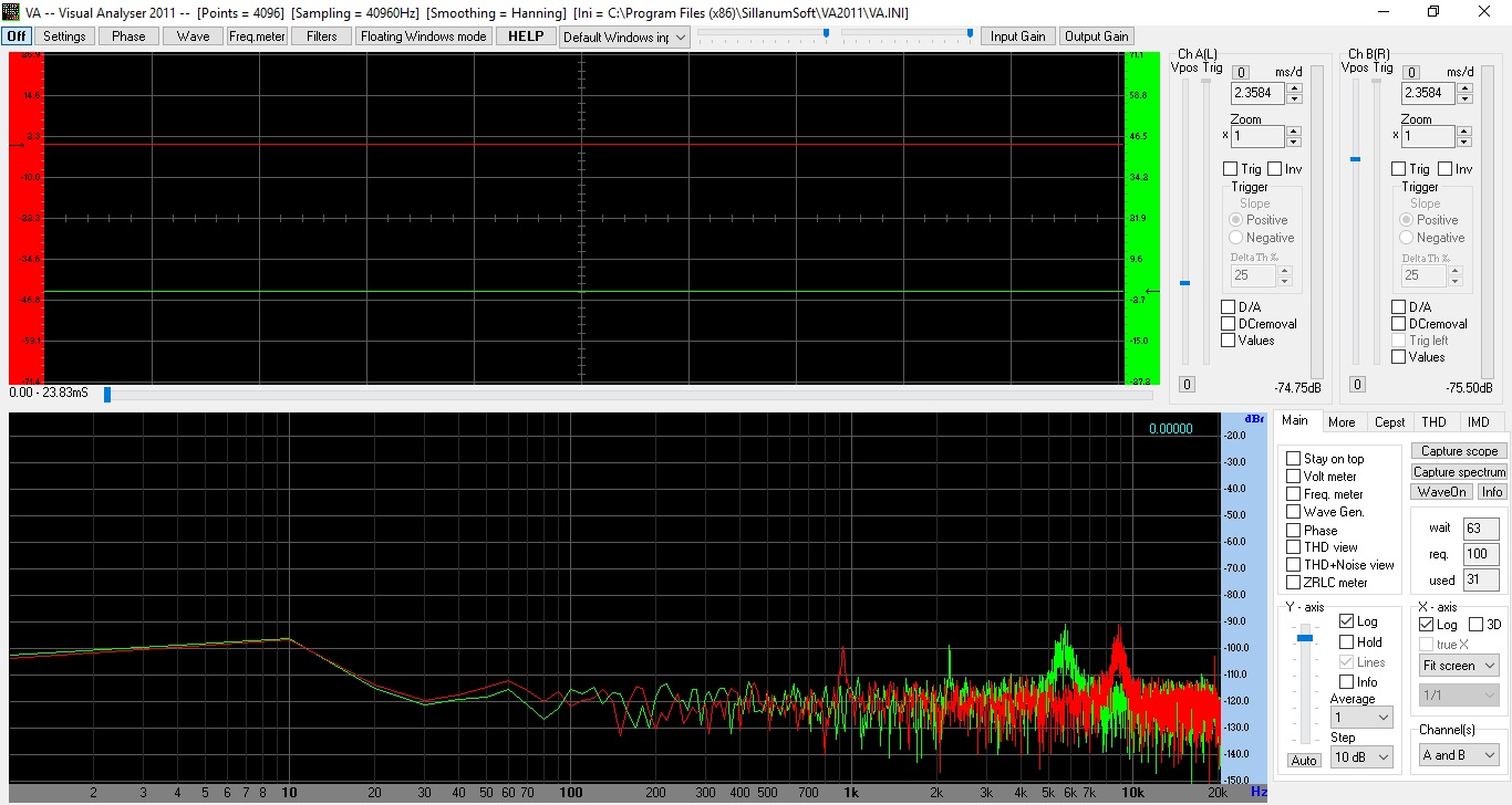

I've been looking at a few solutions for doing testing of my audio gear at home. My "play" laptop, an Acer Aspire One is the test mule. With the inputs shorted, the laptop sound card noise levels are about -70db -- not good enough for measuring anything. The first USB sound card I purchased, an M-Audio Transit USB, measures about -90db. Better, but still not great. The newest sound card I purchased, a Behringer UCA-202, measures around -110db with one weird -100db peak at 600hz. That I can live with. Both of these sound cards cost me less than $20. On the test bench this weekend is a Technics SH-9010 equalizer. I just recapped it and I'd like to list it on eBay. I'm curious to see what the S/N of this vintage piece of audio equipment will end up being. The original S/N was spec'd at 90db. I'm almost finished building my Pete Millett so I can start measuring my diyaudio amplifier projects.
Make sure you are talking apples to apples wehn measuring noise. The spectragrams are misleading when talking numbers. SNR is a measurement from either max level (just before clipping) or a reference level to the integrated noise over a defined band. Many times its a-weighted noise which means a very specific range of noise is what is measured and the range below 300 and above 6K is filtered out.
I think RMAA can make those tests pretty automatically. And its free. For line level stuff its pretty useful. Not so for power amps or phono/mike preamps without some special stuff in the middle.
Thanks for that. I'm still learning about taking measurements. I'm building Pete Millett's interface as the "box" to go between my soundcard and the DUT.
