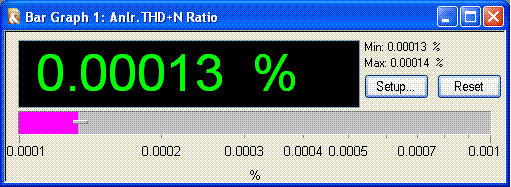

OK Martin, I played with the AGC trimmer, connected a jumper from the chassis to the ground on the AP and used the shortest BNC cable I have. The box for the 4402 isn't plastic, as I had mentioned previously.

Your KH4402 looks like it needs a tuneup. My KH4400 is consistently .0003%. Its box stock. Every time I feel like hot-rodding it I realize I have 2 ShibaSoku oscillators (earlier versions of this http://www.shibasoku.com/download/avc/ag15c_e.pdf ) that are 20 dB better (less than .00001%) and what's the point? Any of these are better than anything we build that is useful.

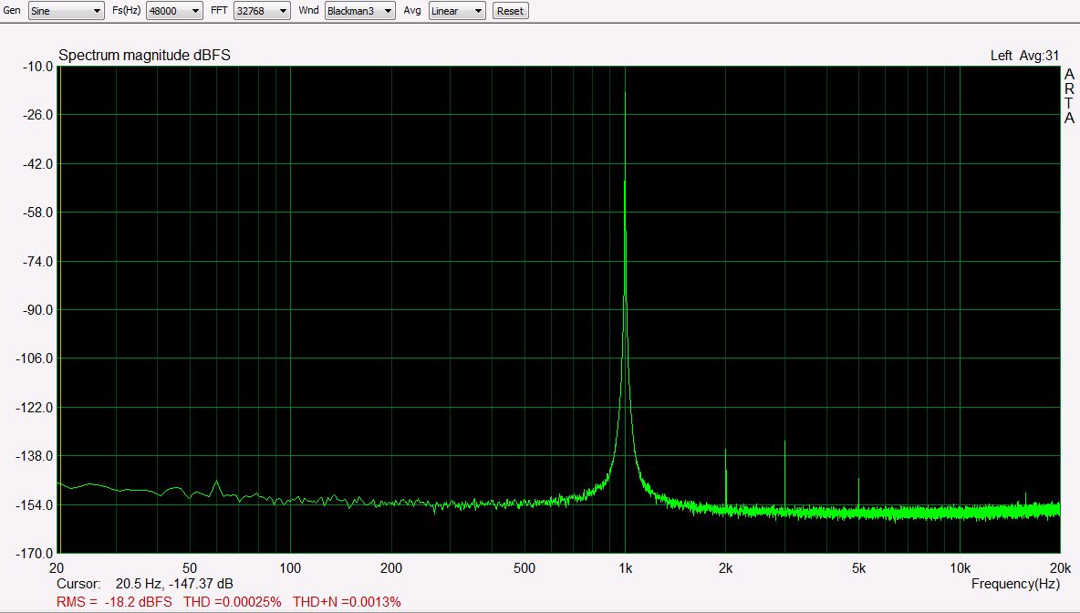

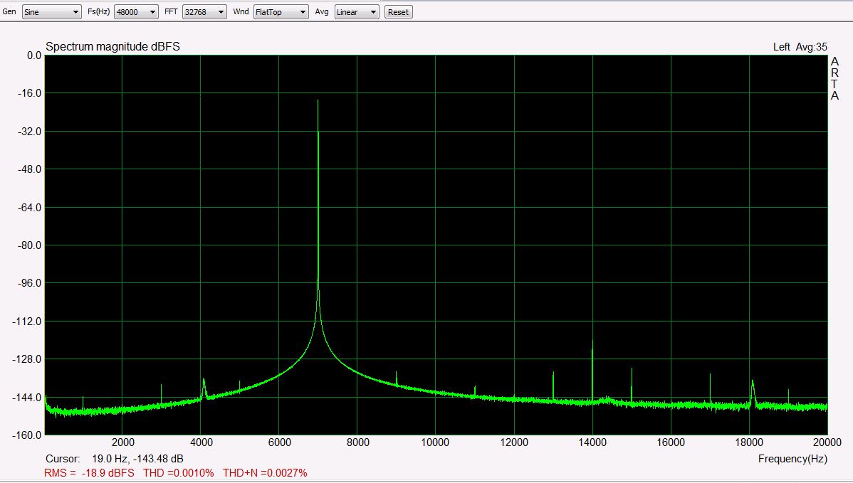

The measurements are not as impressive as user ghg has posted, thd of 0.00005?!? I still wonder how his Krohn-Hite 4400A could have such small distortion. But anyway, my measurement with a sample frequency of 48kHz. The chain was:
laptop -> EMU0404 USB -> 0404 balanced analog output 1/4in -> pcm4222evm balanced analog input 1/4in -> pcm4222evm s/pdif/aes3 digital output -> 0404 coax digital input (set on aes3) -> laptop running ARTA spectrum analyzer v1.7
The pcm4222evm was set as master via the S/M dip switch, and laptop was set to be slave in the 0404 software.
The pcm4222evm was powered via an analog regulated supply +- 15V, and +5V. A note of caution: before earthing this power supply GND output the pcm4222evm had huge noise. all over the place.

Do you think adding a DIT to the EMU in a similar fashion that the PCM4222 EVM does and using a balanced digital cable between the units would be worthwhile?
Sorry, I don't understand the first question. I don't have a balanced digital input on the EMU, so couldn't test if it would be better than the coax unbalanced input. But I did noticed something wrt cables. I had two sets of RCA cables. For some reason there was a lot of high frequency noise when I used one of the cables for the digital connection between the pcm4222evm and EMU. Couldn't understand why, but when I used the other cable all that noise disappeared.
