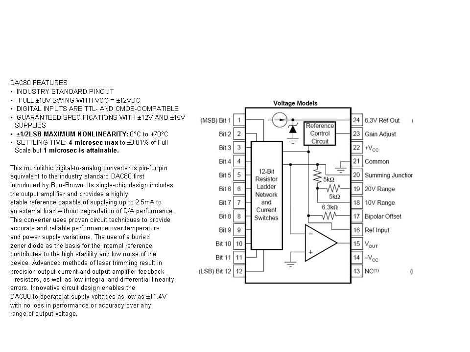

I found a Burr Brown DAC80 chip yesterday. It has a 12 bit D/A, all separately accessible on bit-level. Adding just 4 bits with current sources (FETS) would really make a rather discrete 16 bit DAC. Excellent settling time.
Any ideas someone?
regards albert
http://www.analog.com/en/prod/0,,774_1082_ADDAC80,00.html
the V (voltage out) type.Bernhard said:Is it -V or -I model ? -V is a problem...
What's the problem (the summing I expect).
albert
Bernhard said:Yes, the summing.
Now an odd suggestion:
as pin 20 is plain out (in the logical diagram, I admit, not the physical) thus would provide Real Current for external I/V IF and only IF the internal OpAmp would not provide the current dump (in its I/V work).
Now, to do that, this would imply shorting it with a 1 Hz filter. If you understand what I mean.
albert
Perhaps look for something else.
My experience is that instrumentation DACs are not as good as audio DACs. So far.
But they look pretty 😀

So a discrete dac like the burr brown would allow a real solid line to be set. 12 bits, and either go to 14 bits with 4x oversampling (could sound as good as NOS 16 bits in my opinion).
2 bits, on the bottom (the LSB is now 400 so much micro amperes. So it can easily be extended there.
And yes, if there is some nice converter to 16 channels, then just pumping these devices at 44khz to 88 khz or even 186khz would not hurt them a bit. --> Discrete 16-bit DAC (CS8412 input receiver, mode 5 output format) for start with... does anyone have a board that outputs this and can be fed directly inot the Burr-Brown (the 12 singular bit entries)?
2) Stil thinking how this -vVersion of the DAC-80 can be converted into -iMode! Actually just floating the output on 10k or even 100k would just swing it to either rail. This should give the current out in all freedom.
--> if that were true we also would have a solution to get the 1-bit chips free of the output summing opamp that is in the chip!!

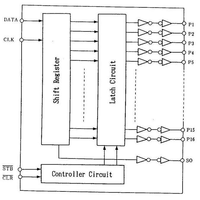

How about using a chip that inputs serial and outputs parallel each bit separately. I found this chip: NJU3716M, 16 bit output producer. (an 18bit version also exists.)
This would provide an output directly, allow adding an output stage of any configuration you like.
The chips works up to 5 Mhz input rate, fast enough I think.
regards
albert
