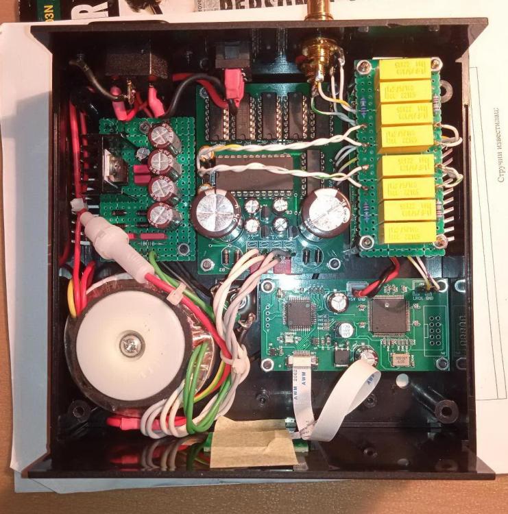

Also, what is the magnetic shield can made of? Soft steel? How thick is the metal, 18 gauge?
GOSS - grain oriented silicon steel. This manufacturer where I buy wraps a couple of layers around the "belly" of the transformer. I put them very close to the PCBs, there is no trace of hum.

i think the aliexpress shield cans are probably steel or iron

The magnetic armor should be Iron or Steel with as little carbon content as possible.
