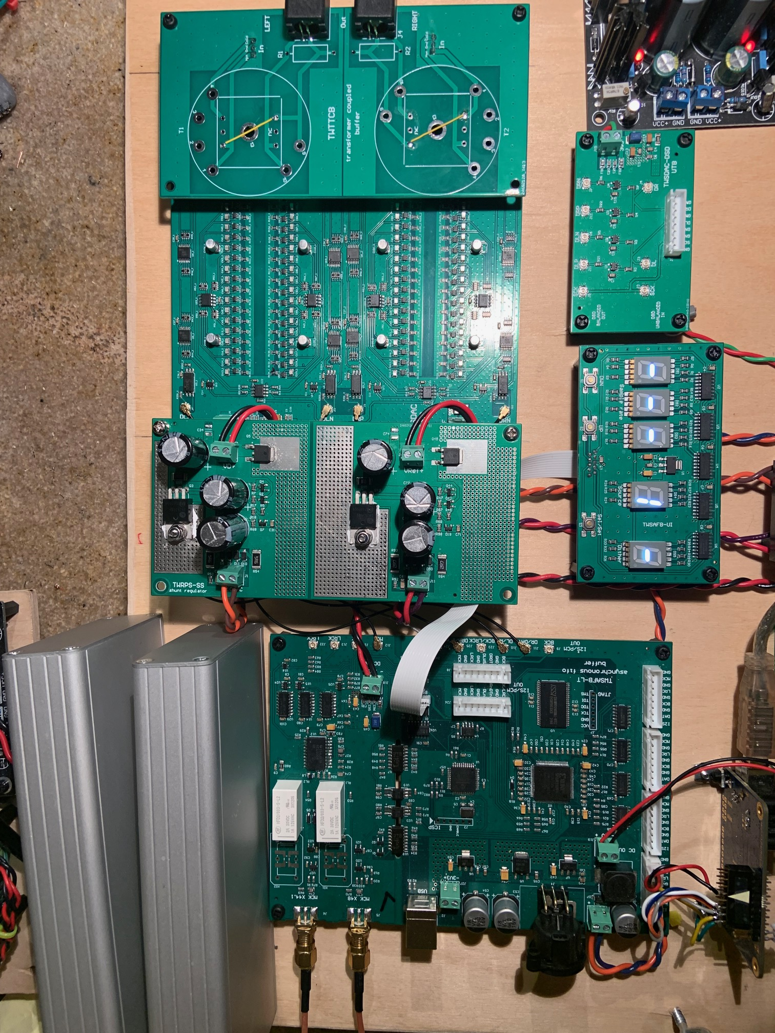

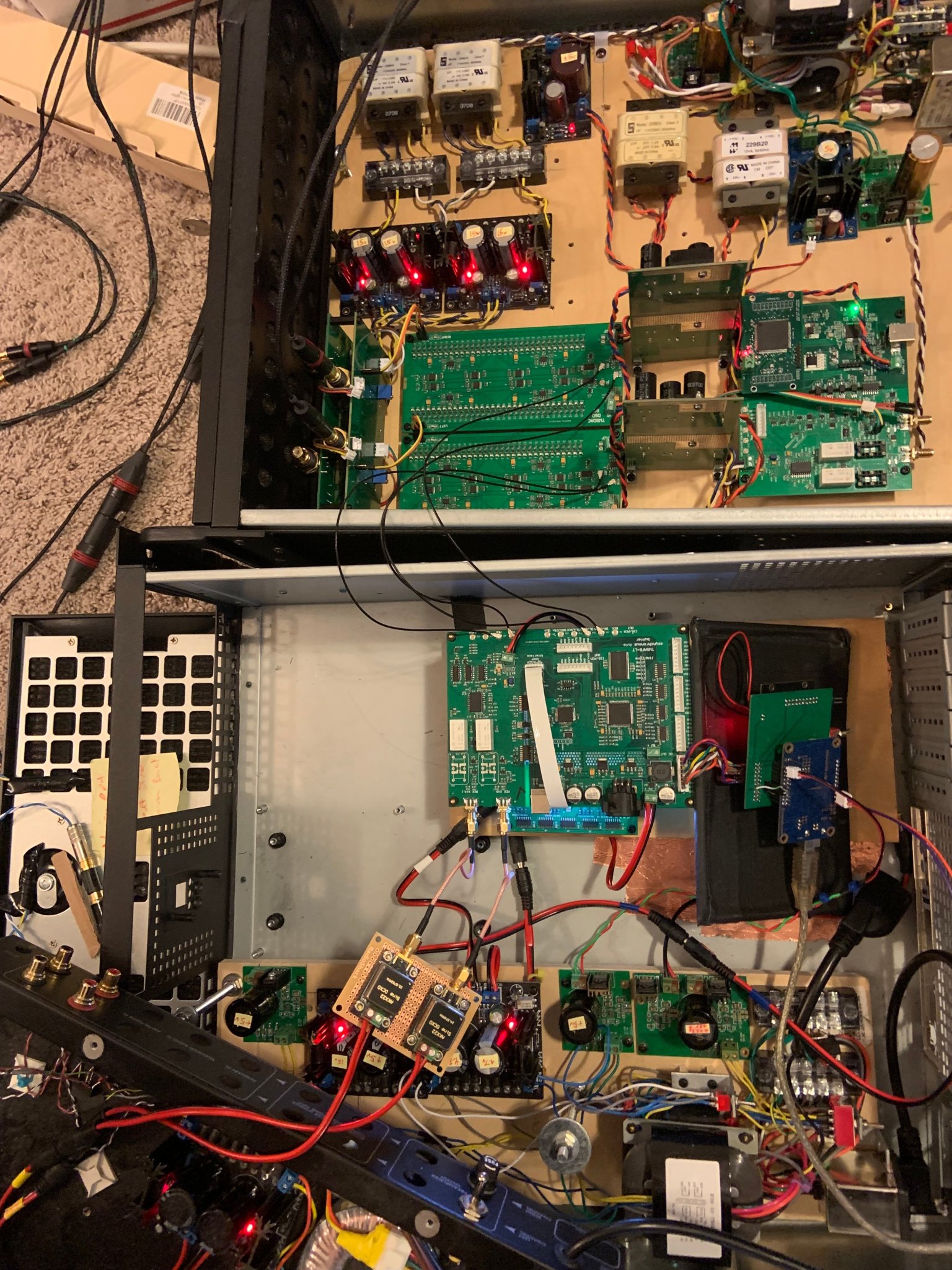

You can also pay more and connect boards from TheWellAudio. I use some of their stuff in my experimental dac, and it sounds very good. Of course it looks like a lab experiment too. Not done experimenting yet, is why.
Attached below left is what it looked like at one point, fairly neat. Now it looks a lot messier but sounds considerably better.
The black rectangular object seen in the lower right between the USB board and PCM2DSD converter is a metal plate covered in gaffer tape so it won't short out anything. It shields the board on the left, a FIFO buffer and dac controller board. There are steel walls between that stuff and the dac itself along with its reference voltage regulators and discrete output stage shown in the upper part of the pic.
