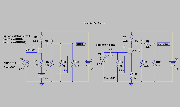

Hi Lars
what is the output impedance of your schematic? If I'll build it, I have to omit the 7k resistor (R5)?

Hey Tolu,
The 7k symbols your Lightspeed😉. Had to put it there to check the circuits behaviour with the IRL load. You can add a 470k to keep C1 uncharged with nothing connected.
Also C1 could be tailored to suit your needs, 10u gives you a -3dB of ca 2Hz with your Lightspeed. You could as well use a 4,7u, but not less!
Have not checked Zout but it should be well below 100ohm, ~1/Gm.

Tolu said:Perhaps Lars' finds a trick to use only one JFET
If you really want just one jFet you can still use the circuit I linked to in post 31. The dac board we're discussing in this thread has capacitor-coupled outputs - so no problem.
Lars' direct-coupled solution is probably +😎 though.

I will try your schematic as soon as I get my DAC board that I ordered tonight. 🙂
I just need a nice circuit for a suitable PS. With 30V I have to discard my battery power approach. Have you simulated lower supply voltages in respect of distortion, too?
Hi guys,
The 1 transistor solution is to place the Lightspeed directly after the DAC and the gainstage after the volumecontrol.
This sadly leaves us with 2 caps in the chain. The DAC will not have any problems driving the VC(albeit there will be some more signalloss as the AC-load is now 620ohm) but the output cap should be enlarged to 5-10u.
The FET after the VC should then by locally feedbacked to have a gain of ca 12-15dB. Something like the JFET BOZ but tailored to fit Tolus combination.
So you have to choose between two FETs/ one cap or one FET/two caps. I personally would choose the first.

Hey Lars
you are very quick! Thank you very much!
I like the left circuit more!
Is it right that the DAC output is connected directly to the gate of the JFET? No series resistor between? And no EC mod anymore?

Off course you should have the EC mod with 680 V and 3V bias😉 . Its the heart in this circuit.
The symbol for signal that says source is 680ohm with 2,2V DC.
You could add a gatestopper if you get stability problems.
Will do a new schematic to clarify. Also note this circuit should be soldered into the DAC as an integrated part.
