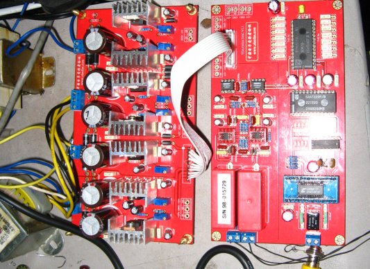

it's OK¡£look my TDA1541A dac 100$.

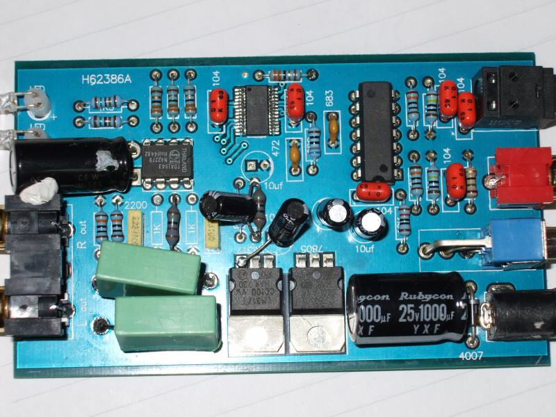

Did I mention I also have this dac.
The mod list
1. replace the output cap with Vishay mtk1822 -> big improvement.
Yes, give the mkt1822 a try, it is very good.
2. up the voltage to 7.5V (change the resistor of the lm317)
and change Vref resistor to 1.5k and I/V resistor to 2.2k.
3. replace most of the decoupling cap, the most important is next to tda1543.
I used blackgate which I have on hand, others to rubycon zl.
This will give exceptional value dac for the money.
There are other ways to improve it of cause as discuss in above posts.
Other suggestion which I haven't done (I move on to the deq2496/tda1543)
1. replace the lm7805 to shunt lm431. maybe add a separate power for the 74hc00 and dir9001.
2. add input digital transformer for isolation
3. replace the 74hc00 to 74vhc00 or even better with ds8921 (not a direct replacement, google this)

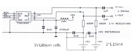

I have the same 1543 card lying around and want to try it.
If ECs biasing method sounds better I think this would be the way to do it.
One question though: Is the biasing current 2,3mA total or for each output?
Lithium cells are 3V and are said to be the best for biasing tubes, so they should be useful here too.
Feeding the signal without caps directly into a FET SF or tube CF would take care of the impedance problem. Personally I think the output level of just above 0,5V rms is good, the common 2Vrms is always to high.

What I don't understand is the 3V battery and R3. Why don't you go directly (with a series resistor) to the gate of the JFET? Why do you do I/V conversion first? Why do you take 2 JFETs? Wouldn't it be enough to use the Fetishizator but with 180 Ohm for gate and source resistor?
Hey Tolu,
You asked for a FET-buffer with 12dB gain(4x), capable of driving your 7kohm load. This is what is needed😉 !
The "thing" on your sketch does not have any of these qualities. It has high gain, high distortion and high Zout. I´d say it is totally useless at these voltage-levels!
About the 3V and R3 it is the I/V and part of ECs novel design.
I asked about the sensitivity of your amp was but didn´t get an answer😕? Would rather see a sourcefollower instead of the above and higher sensitivity in the following amp. This to eliminate one gainstage in the chain......

I think I will give Lars' schematic a trial. Or I try the JFET BOZ after the EC mod of the output of the TDA1543. Perhaps Lars' finds a trick to use only one JFET (->KISS)!
