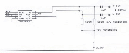

I've been using it with an active solid state I/V stage, but this evening I reverted to passive I/V by modifying it along the lines described towards the end of this post by ecdesigns: http://www.diyaudio.com/forums/showthread.php?postid=1813308#post1813308
The result in my system is a very noticeable increase in clarity and realism. A simple mod, well worth doing I think.

Hi John
the ss stage is way too complicated for this little DAC and for my skills. The ecdesign seems to be more interesting.
I am not sure how to mod the circuit of the TDA1543 pcb with the ecdesign I/V-stage because i am not an electrician.
Is that the relevant part that has to be done on the pcb? Where have you put the ground of the 3V battery?
Yes that's it. I put the ground of the 3v battery to the -ve pin of the cap that connects to pin 4. Ecdesigns also shows a small 2n2 cap between +3v and earth. I put mine directly across the battery connections.
The ends of the I/V resistors (1k on the stock board, I think) that formerly connected to ground are lifted, then joined and connected to +3V from the battery. If you keep the 1k resistors you will get a slightly higher output than with the 680R shown.
You need to remove the resistor that connects to pin 7.
The output caps can remain as they are.
Hope this helps.
John
1K will result in a distorted output signal, 900 Ohms (2Vpp output) is about maximum with 5V power supply. Vref also has to be increased to approx. 3.6 ... 3.8V when using I/V resistor values higher than approx. 680 Ohms. This could be done using 3 NIMH batteries in series. batteries have to be used because mains-power supplies are to noisy, and they aren't "floating" like with a separate battery.
The advantage of this slightly modified passive I/V conversion is that Vref pin can stay unconnected. The Vref pin will pick-up noise / hum, and route it to highly sensitive DAC analogue circuits. This will cause pollution of the DAC output signals (sound smearing).
Vref was intended for providing a reference voltage for external OP-amps, and for adjusting bias current. In practice this pin is best left un-connected.
The 2n2 is only for decoupling the battery power supply (high frequencies), best caps I tested so far were 2n2 silvered mica caps. ceramic caps may have piezoelectric effects that degrade performance. When using film caps, stacked versions (with lowest inductance) are preferred.
I used small WIMA 1uF / 50V output coupling caps (2.5mm lead pitch), these are small and provide very good performance. They even appeared to produce a slightly more realistic (fuller) sound compared to the expensive Vcap Teflon Tin caps. This test was done using the SD-card player and a 12-crystal lithium-cell referenced precision master clock. I also used a dynamic jitter reduction circuit on the BCK input, and resistive I2S attenuators on both WS and DATA inputs.
DAC sound quality largely depends on I2S signal quality (jitter / jitter spectrum). Attempting to tune a DAC that's fed by poor quality I2S signals is like attempting to tune a phono pre-amp while the turn table speed isn't constant (slipping belt for example). The end result is a flawed output signal, regardless of DAC / phono pre-amp mods.

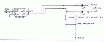

I tried this mod and posted some impressions on the AOS forum
I'd like to say a big thank you to ecdesigns for sharing this, IMHO with this mod the TDA1543 is the best I've heard it!!!
Before the mod I was using 2k7 Riken I/V, 1k5 Riken Ref , 8v supplying the TDA1543 using AN8008
I built the TDA1543 + ecdesigns mod on a separate piece of vero and tapped into the I2S lines
leo said:I tried this mod and posted some impressions on the AOS forum
How do you drive the TDA? With 8V or 5V with ecdesign-mod? Did the highs and width of the soundstage improve?
reading this thread i have one question :
isn't 1,56Vpp too low as level compared to a stock cd-player that has 2Vrms output that is equal to a value of 5,6Vpp ?
Yes of course it could be - if you don't have enough gain in the stages that follow it.
Using 2k7 I/V and 1k5 Ref I used 8v
Ecdesign-mod I used 5v

Its the only compromise imo, the sound is certainly better to my ears but the output is very low even when used with my headphone amp, I have to crank the pot to max
The 3V reference, is it base on the midpoint voltage?
If so, I think the Vdd can be more than 5V and also higher I/V resistor value.
