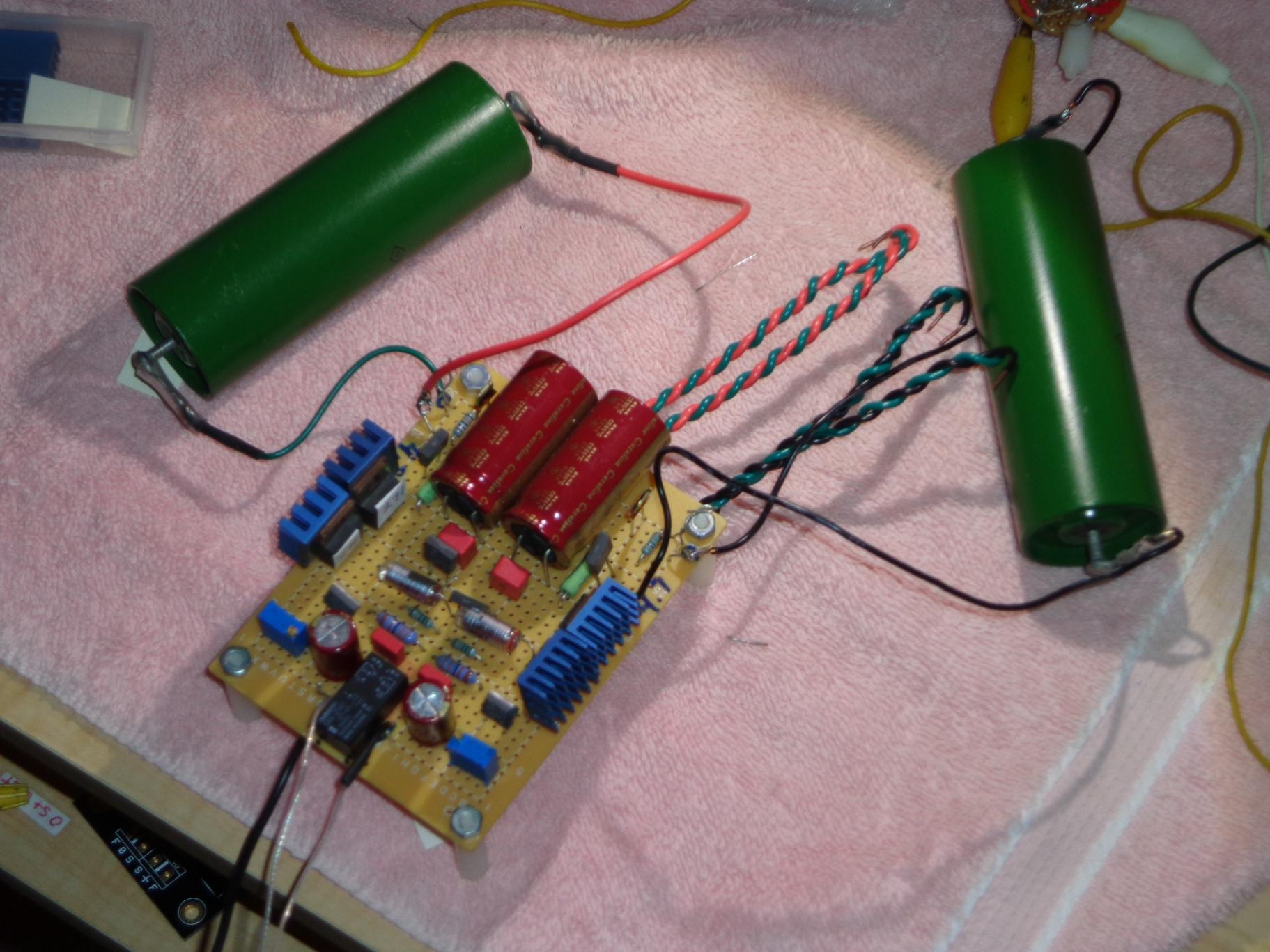

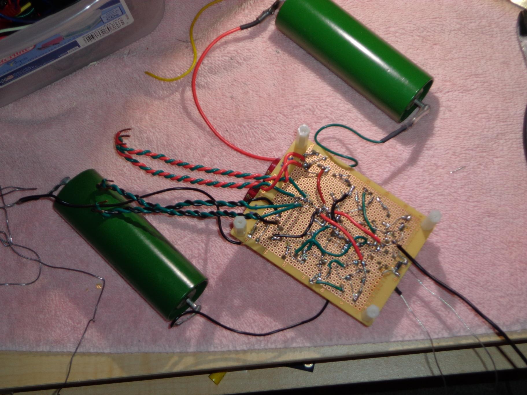

Did you ever figure out what to do about that -3.2V startup/power down voltage? I'm getting the same thing. I'm getting music, but for testing I waited until the input voltage got down to near zero before connecting the CD player. Does anyone know for sure whether -3.2V on the input will damage the PCM63P?
Joined 2008
Well, in the absence of any replies I decided to bail out on the problem and just use a relay and an NE555 timer circuit to delay connecting the I/V and the DAC chip until the voltage settled. This seems to take about three minutes so I set the timer for about 3:40. The formula for setting the timer didn't at all resemble reality in this case (the timer took a lot longer to trip than advertised), so I had to do it by trial and error. I wasn't using the heater windings on the main transformer so I sued those to power the 555 power supply. It all fit on a round circuit board about 1-1.5 in or so in diameter.
Photos of my version of the Pass D1 I/V are below. Believe it or not I did plan this out.
