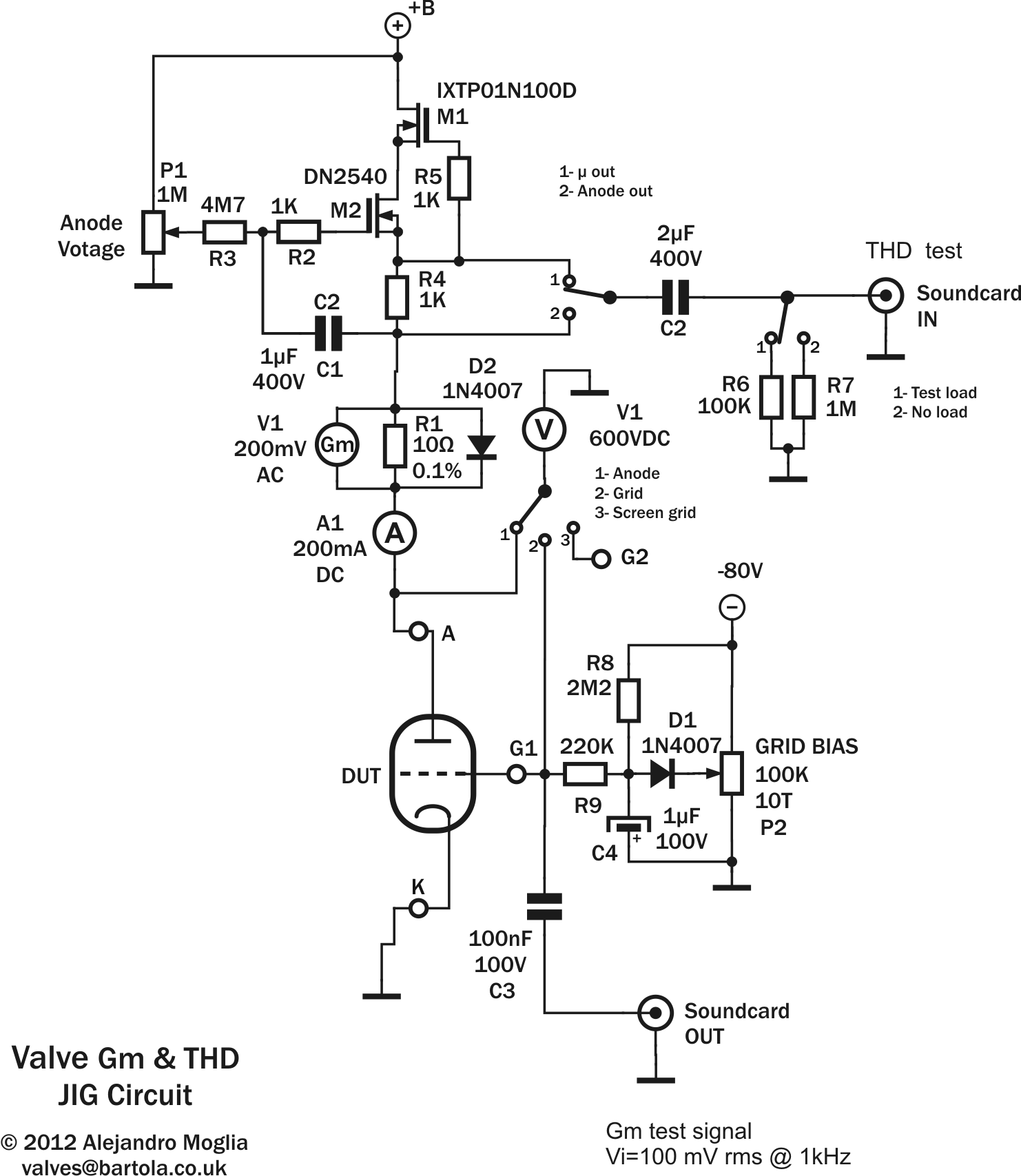

As haven't started with the curve tracer chassis yet, I've been thinking in a small addition to the whole tester/tracer. It seems to me a waste of valve connectors not adding a simple test gig in addition to the curve tracer.
I usually measure valves distortion with a breadboarded jig and Pete Millet's audio interface to the PC. It works very nice, so I thought about the circuit drawn in the attached.
A simple jig with a grid voltage pot, a gyrator load, an anode current meter and a transconductance meter.
The jig uses the PC sound card to feed test signal and to measure (THD and THD/frequency). Transconductance is measured through a 200mV AC RMS meter as in the Sussex Valve Tester with the difference that the source test signal is provided by the PC: a 1kHz 100mV rms sine.

Hi Ale,
You are building a super tester! How do you measure the DUT with PMillett's inteface? Is it a simple SE setup with a transformer?

Valve is loaded with a gyrator at the operating point you want. You can feed a sine wave with Audiotester (or any other software of choice) and then measure gm from the meter and THD using Audiotester,etc.
Simple and very useful.

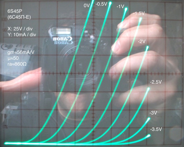

New traces including many high gm pentodes (triode-strapped) here:

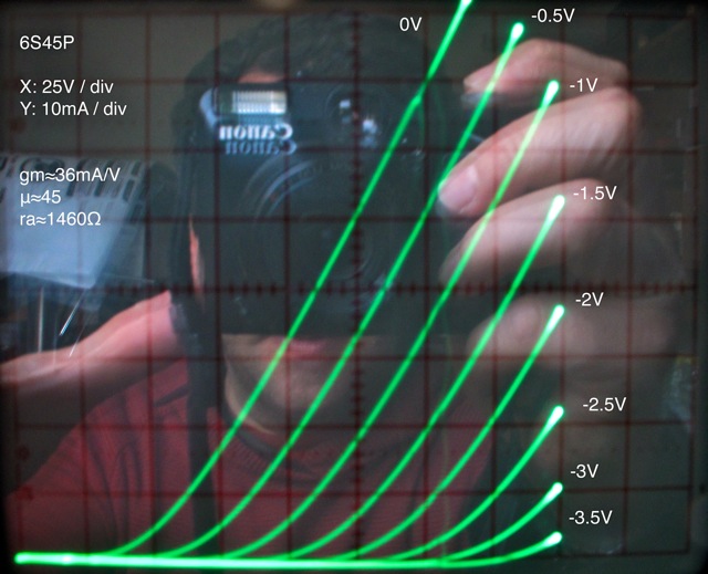

As a quick workaround I swapped the sensing resistor for a 1 ohm (1%) and used the vertical gain (i.e. lower scale) of the oscilloscope to compensate for the signal magnitude drop of x10. I was worried about the noise pickup, but still in a breadboard works a charm!
You can clearly see the impact in the 6C45 curves. Even the graphically calculated parameters are very different!
I will probably leave the 1 ohm resistor or add a switch to alternate between 10 and 1 ohm resistors.

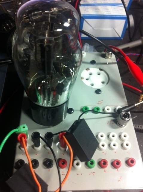

Started populating the top plate. There are two generic binding posts with their corresponding pin jacks to add some flexibility. The right hand side has the test points for x,y and common.
Tomorrow I am building the socket adaptors. The templates are ready.

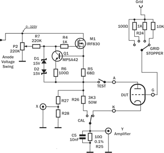

What options are available to minimise the measuring error introduced by the cathode sensing resistor for high gm tubes?
I know is not easy to measure the current at the anode, it has been discussed around here before.
Was there a reason you didn't want to put the sensing resistor between the bridge rectifier and ground (and make P2 and R27 large to minimise their current demand)?
Hi Merlin,
Not sure if I understand the question. Surely P2 can be larger to minimise current. I had a 220K at hand, so used it Perhaps a 1meg pot would be better here?
R27 and R28 is just a x10 divider for the oscilloscope. I believe Michael Koster suggested a different way of measuring the anode current but I don't understand how.
Perhaps you can explain here and help me out?
Ale

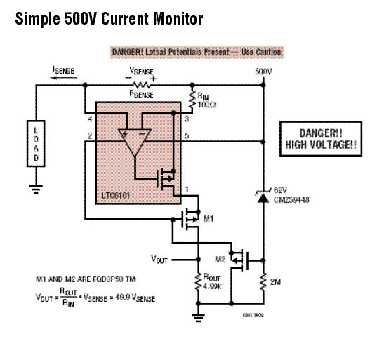

For use in a tube tracer the current measuring circuit needs to work at low electrode voltages also.
hard to beat a floating power supply with low side sensing
It will work with very low voltages as well -- and you don't have to float the supply which has its own issues, and you can use very low sense resistors because of the high gain of the diff amp. You can use a pair and sense current in each direction, if, for instance you wanted to do bjt's, depletion MOSFETs etc.
Pretty good over a wide range if you ask me:
