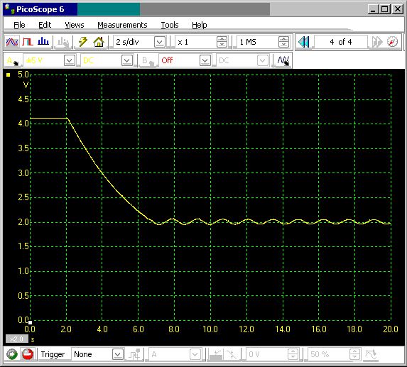

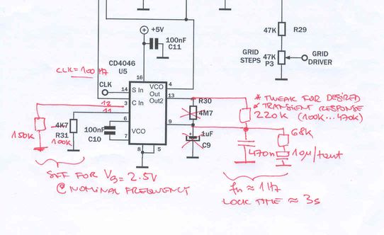

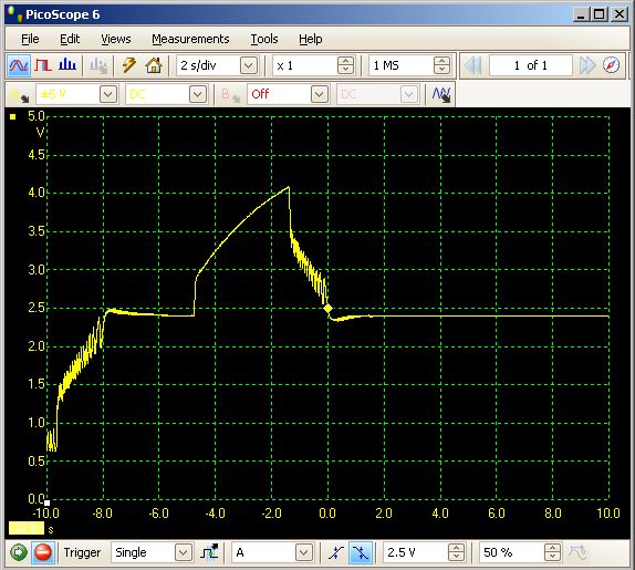

Re: 200Hz/240Hz PLL stability
For a fast and stable PLL - lock in ~3s - I recommend something like this (pic 1). Series resistor from pin13-pin9 = 220K, shunt cap from pin9 replaced by 470nF, parallell with 68K+10u.
Hopefully I will be able to upload the pictures, they also show the measured lock transient (voltage on pin9) for the original and modified circuit.
The HC4046 is actually quite tricky to use, as the design equations in the data sheet are not accurate. A much better (and much less popular) part to use is the HCT9046A.

Hi TB,
Thanks for the contribution. It seems quite a different setup for the HC4046.
Today I hacked my PCB to add 100K resistor in series with C9 (1uF) as per Alfredo's suggestion. It did improved locking significantly. However, I do have an issue now with the DC offset. It looks like the grid signal drifts a bit.
Do you recommend making the changes as you suggested earlier? May struggle to add all those additional caps and resistors, but can give it a go.

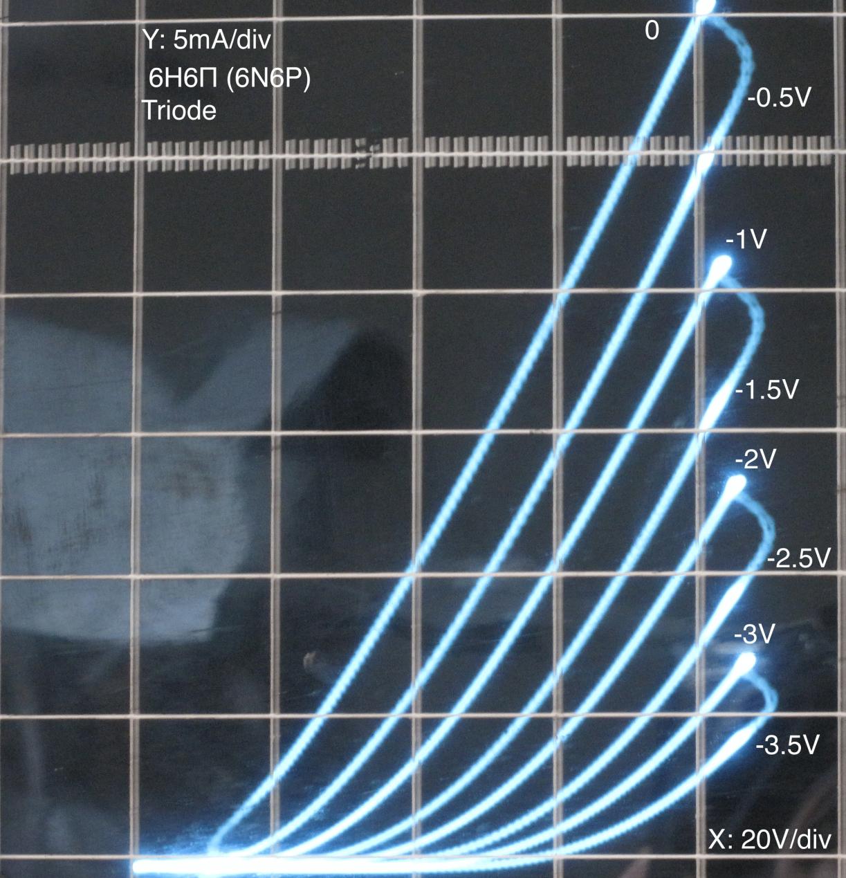

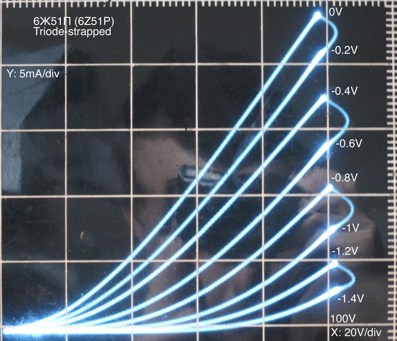

Attached are two new plots with a high gm triode (6N6P-I) and a very high gm (6Z51P) triode-strapped pentode. Both were a bit of a challenge and added a 1K resistor to the grid wire in addition to the ferrite bead I have around the cable.
