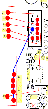

>>>>In your circuit board and schematics, you are using a 10 pin connector to connect to the PC parallel port. Can you tell me the pin assignment that corresponds to the 25-pin D-sub connector of the PC (i.e. which pin from the 10 pin connector goes to which pin in D-Sub) ?
if you use another pin assignment,you must change the software option of "端口定义"

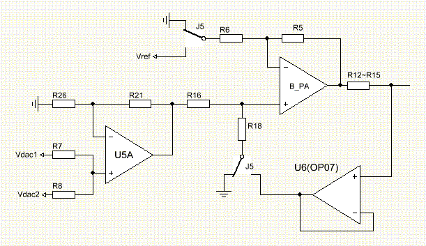

>>> Also in the current generator circuit for the base current, SW3 is connected to Vref in current mode according to the schematics. Should that not be Vref / 2 if you want to generate both positive and negative current without further switching ? If I understand correctly, J5B only switch between voltage out and current out, but not positive or negative current.
the current generator circuit As described
when J5 switch as above,B_PA is work in voltage out
if J5 is another size, B_PA & U6 is V/I circuit, I=(V5a-Vref)*K/R12
Here have some attention:
when U5a out is less Vref,then the B_PA out current direction is pull,mean is "Negative" current.But base on GND ,all current is positive.
Beasure the DAC(M62359) can output 0~11.5V, V5a is out 0~13V,Vref=6.5V is the best. but I lazy,I instead of it with Vref.

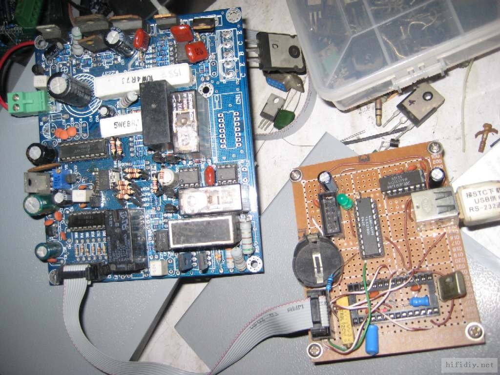

At the space time ,I also develop the USB version ,
I use C8051F330+PL2303HX link to the old "parallel port Version CT"
PC software through USB communicate with C8051F330, and control the old "parallel port Version CT" measure.

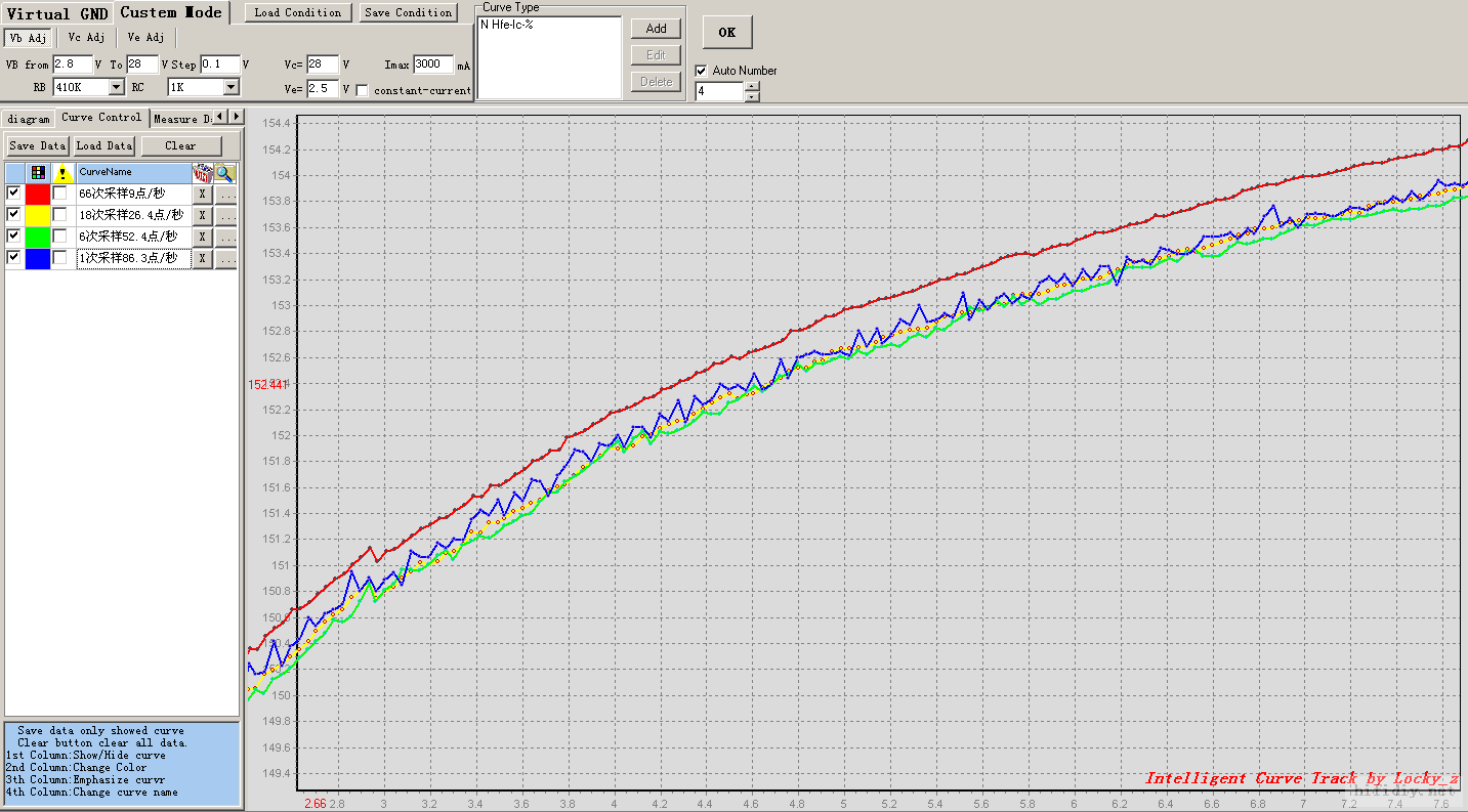

USB version the most measure speed is 86 point/sec.
If you want more precision,then slow down to 9 point/sec(66 times sample and average)
The image below is 66 times/18 times/ 6 times/ 1times sample to measure 2sc3281's hfe-ic curve.

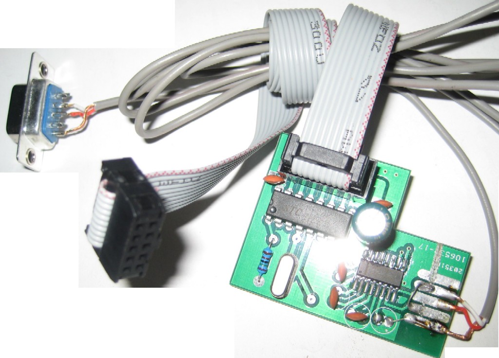

The original Curve track software use 'bit' to to simulate SPI protocol through Parallel ports
But USB is only support frame transmission ,The minimum frame is 2ms,
If I send a 8 bit SPI protocol ,I must send 8 frame at least.It will be very slowly.
So, If use USB,you must use a MCU outside, and receiver macro command and send SPI protocol to control ADC/DAC. This mean you must develop two set software, one is PC,one is MCU fireware
RS232 adapter already complete

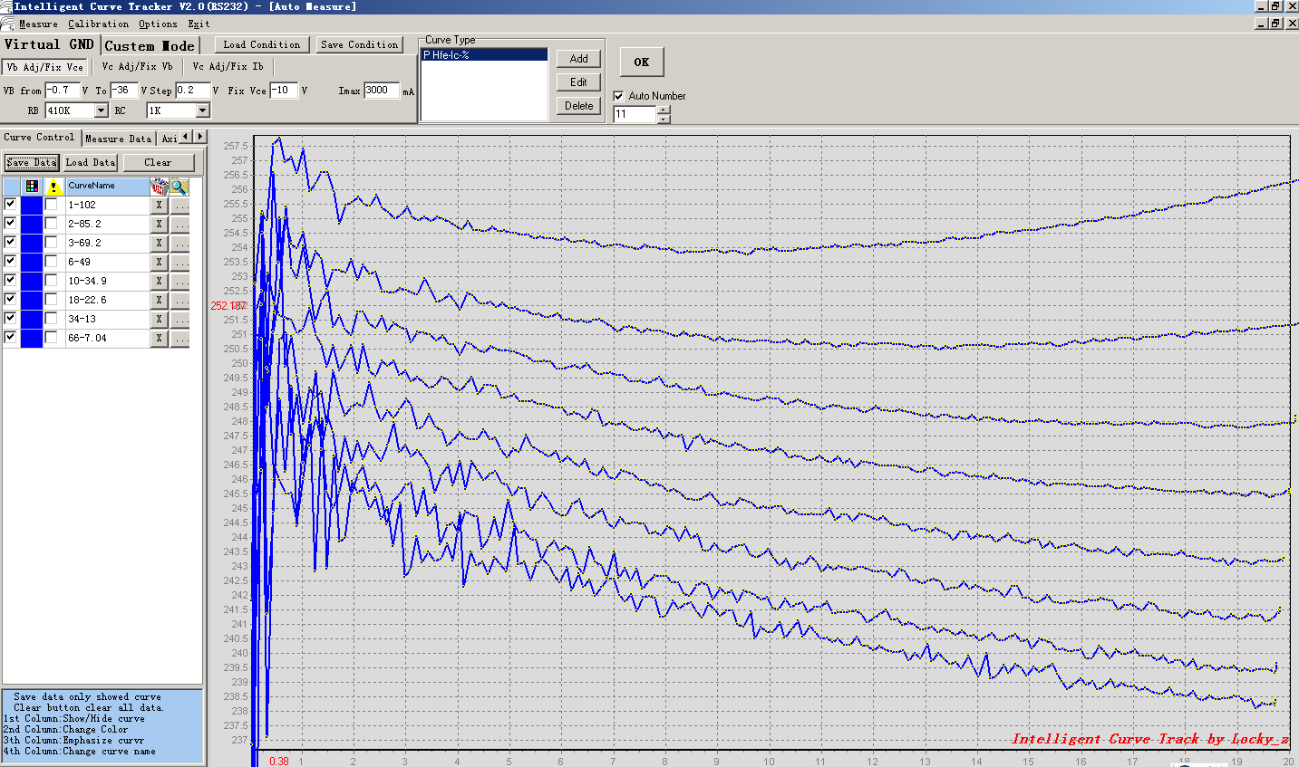

Above picture is measure 2SA970 hfe-Ic curve track on different Sample.
the bottom curve is 1 times sample
another curve is from 2 3 6 10 18 34 66 times sample.The more sample,then measure speed is slow.
