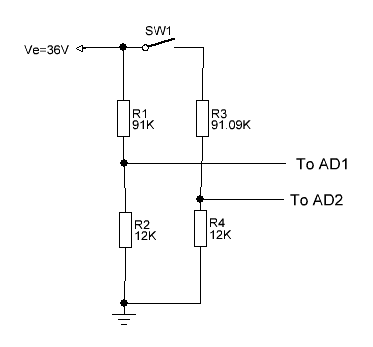

System the principle of measuring voltage as shown below.Example measure the Vbe,
The BE two points of the voltage applied to the ADC input after 91K/12K resistor divider.
If R1/R2 and R3/R4 do not match. R1/R2=91K/12K R3/R4=91.09K/12K
When close sw1, Real Vbe is 0V. But because the resistor no match,The voltage difference between the AD1 and AD2 is
36* (12/(91+12) - 12/(91.09+12))=3.66mV
The system according to the measured, and then multiplied by the coefficient of the resistor divider, and it consider the Vbe voltage is:
3.66mV * (91+12)/12=31.4mV.
So if you measure the JFET Vgs-Id curve, system consider Vgs=0, But in fact the voltage of G/S is not zero.
This error voltage will change with the ground voltage (V) varies.
And when you measure N type ,the Ve is set to 2.5V,and measure the P type,the Ve will set to 36V. So At difference Ve,the error voltage is no same.
So I used some correction algorithm, possible error voltage Ve = 2.5 to 36V range to minimize.

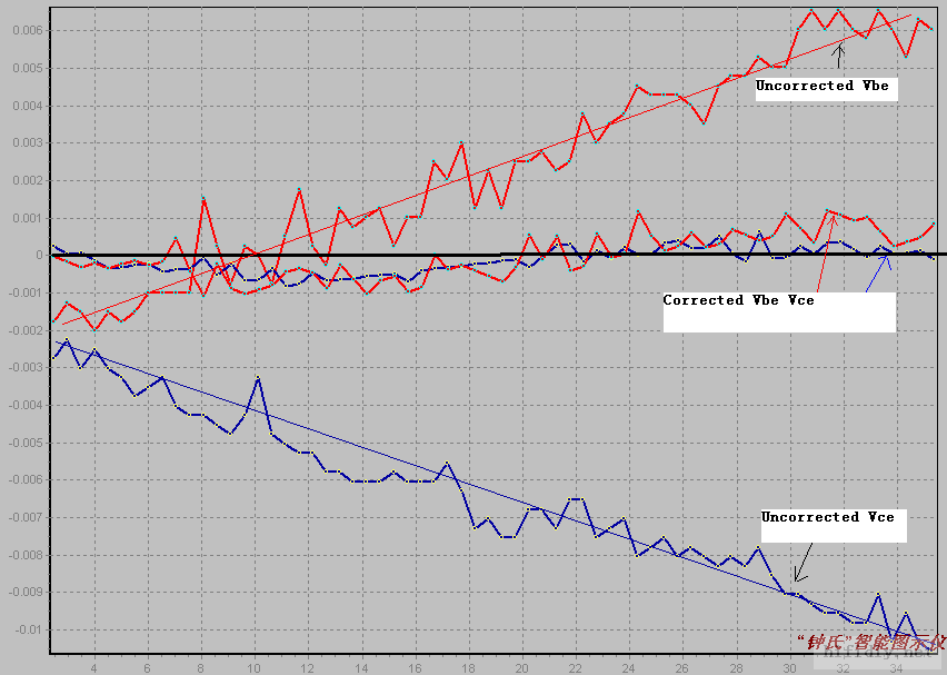

The following diagram is shorted BE and shorted CE,and show Vbe / Vce voltage curve under different Ve.

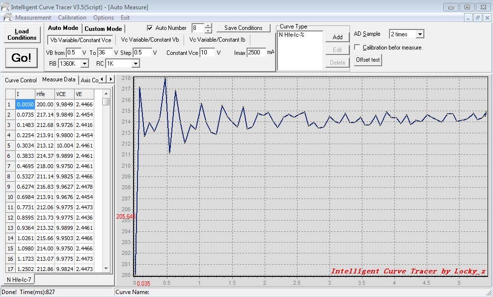

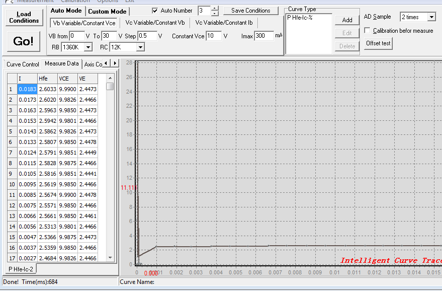

I locky-z, thanks for the reply. This is the screen shot for the 2sa970: I alyways get very low hfe I do not not know to send the .cuv file.
The 2sa970 component foot is right?

The NPN (2sc2240) test seems to be ok!
2SA970 you need to load the 'PNP Ic-Hfe' condition.
PNP's voltage is negative.
It is what I did. I tried 3 different types of PNP transistors with always the same problem: hfe = 2 to 3. Again, The NPN test is OK as you can see on the picture! Could something be wrong with the board? Unfortunately I cannot aford to spend days to fix. Any suggestion will help, thanks
OK I see! I was thinking that the load condition would set up the polarity automaticaly!
I have to learn but I anticipate this tool to be very useful for me. Thank you for your patience!

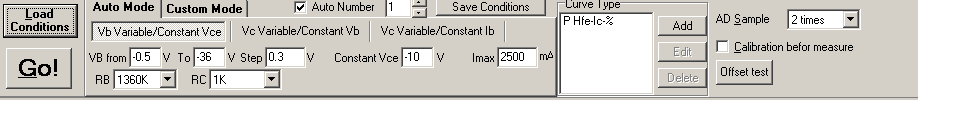

The PNP measure condition is:
But from your picture,I think your condition is NPN type.
Normaly in PNP's result data,The Vce is negative, Ve is +35~36V.

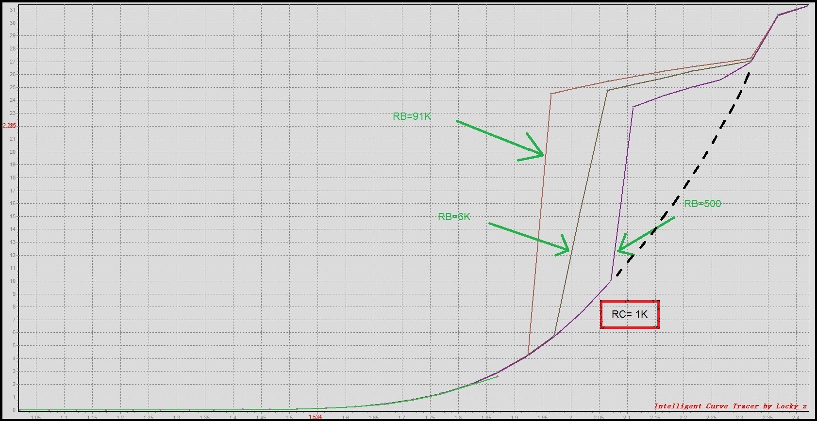

I have have been trying to test small mosfets but i keep getting those strange curves.
I suspect there may be an issue with the equipment, so i`m asking for your advice.
The part being tested is ZVN3310A mosfet.
You see, the dotted line i marked is like a logical continuation of the curve, The discontinuation looks like an error of some kind..
I may be overlooking something.. ??

It look like oscillation occur, you try connect a 10n ~ 100n capacitor parallel FET D-S. and try again.
And give me the save curve data file.
