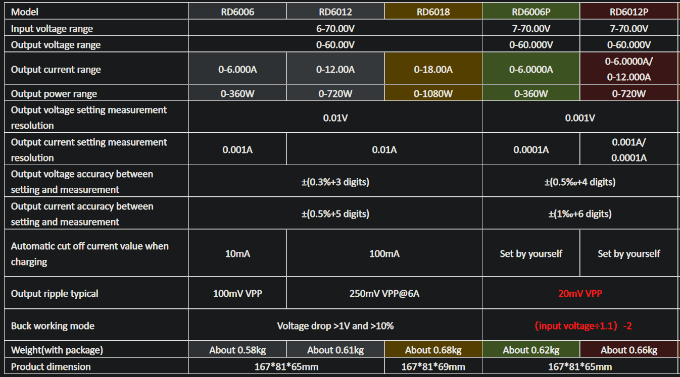

Has anyone tried programmable PSU's RD6006, RD6012 & RD6018? Are they compatible with the mbrennwa/PyPSUcurvetrace?
I have looked at these, too. They are on my to-do list. If someone has or Bugs one of these, I would be interested to borrow and write the code for them.Hi guys.
Hi guys.
Also courious about this, its a decent cheapo bench supply and if you can curve trace with it, Bob's your uncle as they say.I have looked at these, too. They are on my to-do list. If someone has or Bugs one of these, I would be interested to borrow and write the code for them.
You should be looking at P versions, upgraded with higher resolution readout and order of magnitude lower output ripple, but only like 20$ more, can find them easily on Ali. Since we would need two PSU's for the script, think its worth looking at "bargains" like this.
Somebody also made this curve tracer project with them, but its paywalled. Even after register you need elektor green or gold membership. https://www.elektormagazine.com/magazine/elektor-155/58962

If someone would want to borrow one of these PSUs to me I could add support for them in PyPSUcuvetrace.Also courious about this, its a decent cheapo bench supply and if you can curve trace with it, Bob's your uncle as they say.

You would need two of them right? Or, maybe you can develop with only one, but two would be needed for curve tracing, right?If someone would want to borrow one of these PSUs to me I could add support for them in PyPSUcuvetrace.
Considering maybe building one and shipping it out to you.. (afaik, from back when flags were visible on forum, you're Swiss?)
To get it working with the software, one unit is enough.You would need two of them right? Or, maybe you can develop with only one, but two would be needed for curve tracing, right?
For curve tracing, two PSUs are needed. You may use two different PSUs.

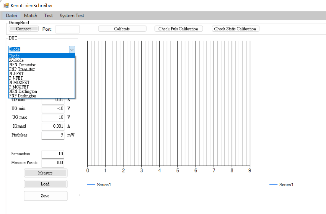

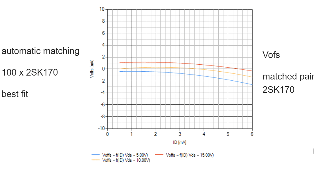

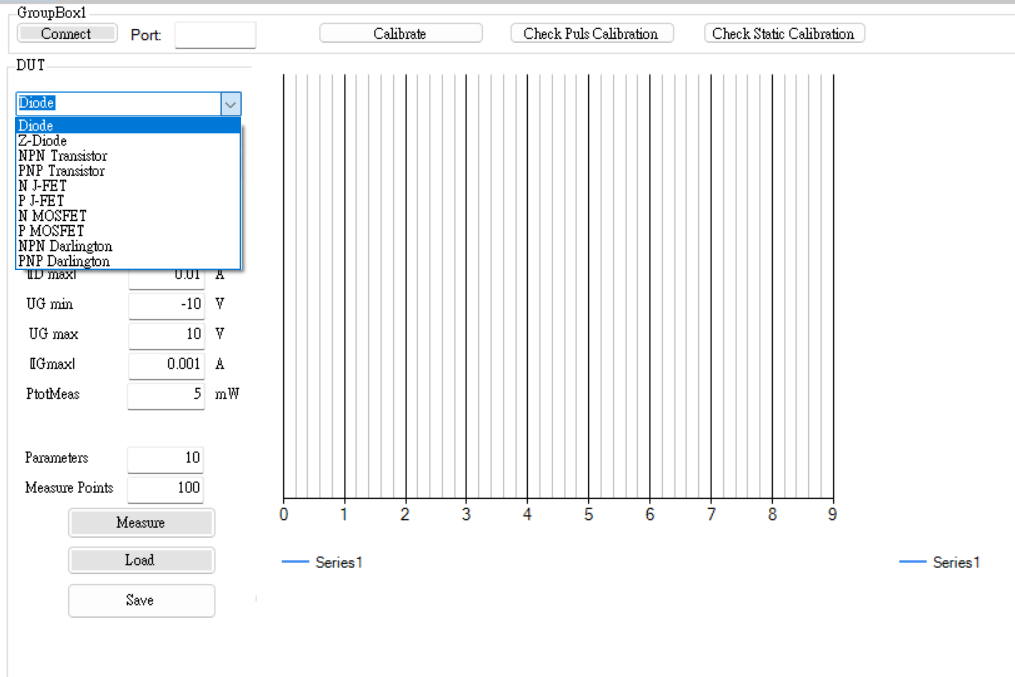

A DIY Component Curve Tracing system with DUT-matching function and plotting.
Not only can it make the I-V curve, but also auto-algorithm-based characteristic matching.
By this, people can easily manage transistors in the basis of batch,
and the system shows you the best-matched pairs and tells you the amount of mismatch, superb!
This is similar to another tracer I introduced earlier, so I love it a lot, another super helper for amateur DIYers!
I am happy with my iTracers on hand, but also glad to seem another project like this!
I will attach the source latter (of course), as I am surprised it seems no one here talked about this?
Anyone knows the origin of this project and author?

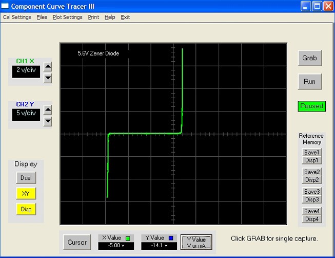

dear friends, I need this program, where can I find it, which programmer do I need to use it with this program? can you see this link?
Curve Tracer III programer
link:https://circuitcellar.com/research-design-hub/create-your-own-i-v-curve-tracer/
thank you
thank you

hello dear friends, where can I find the program in this picture that I want to learn, I want to use it with Hantek 6022BE with or without charge
thanks
thanks

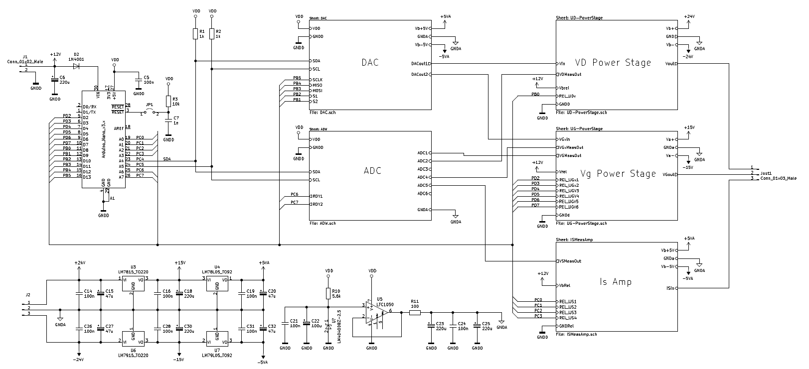

As promise before, the answer of the tracer I posted earlier is designed by Dr. Borgmann, "diy.ucborgmann.de/",
I found this project accidentally, and I soon realized this is a great design of curve tracer with additional matching algorithm.
For such a good tracer project, I think it should be well discussed here, therefore I introduced it earlier.
(Also, don't get me wrong, I never claim it my design, I just put it here for guessing the source so all tribute and credit to the author!)
There are other interesting project on the websites, worth reading them. Enjoy and pay all tribute to Dr. Borgmann!
Check it out here:
http://diy.ucborgmann.de/index.php/en/audio-messtechnik-2/characteristic-curve-recorder

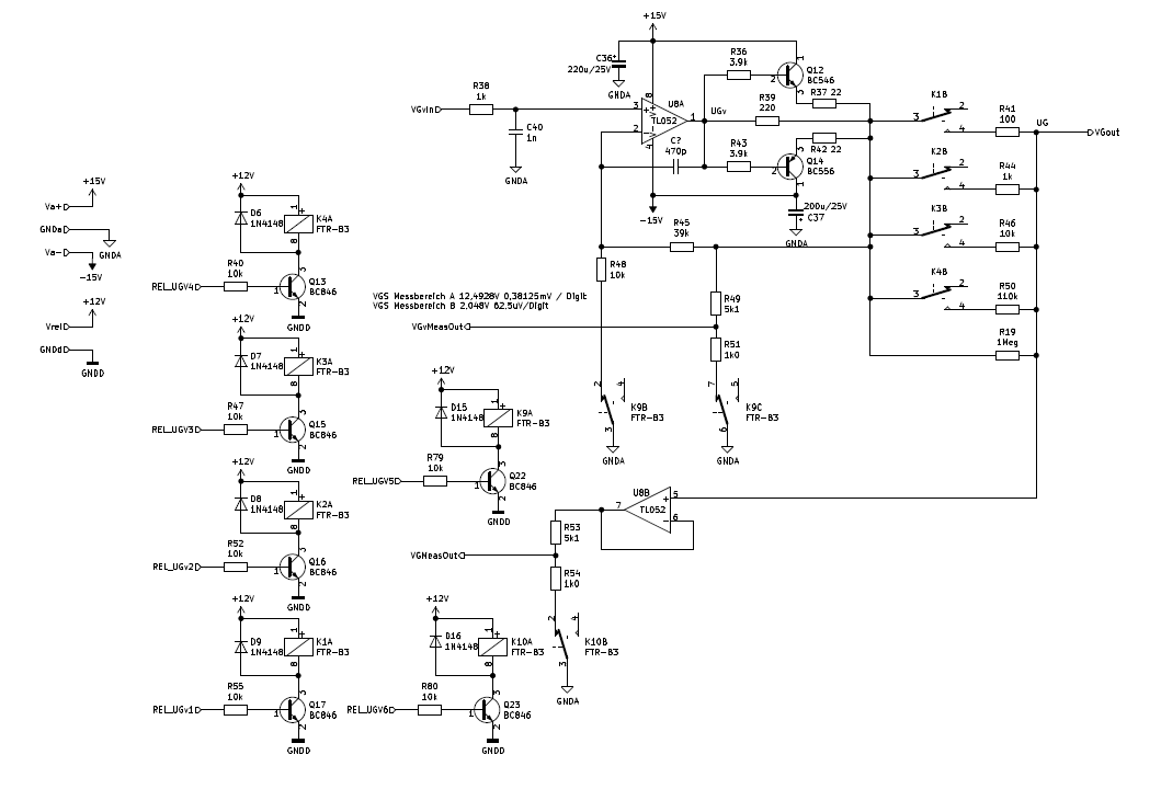

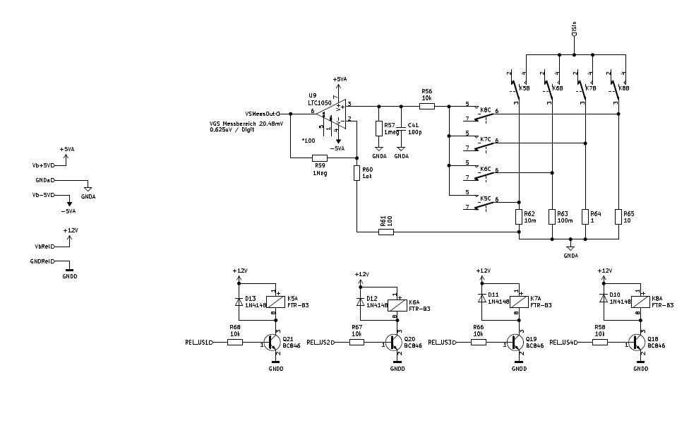

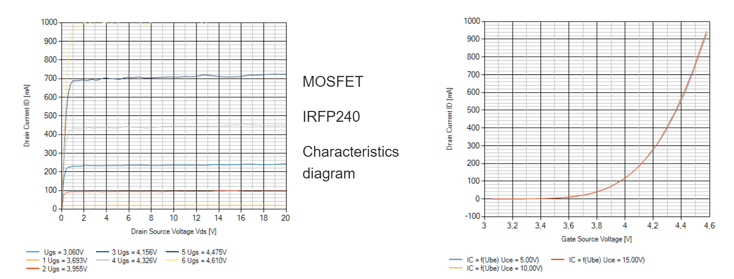

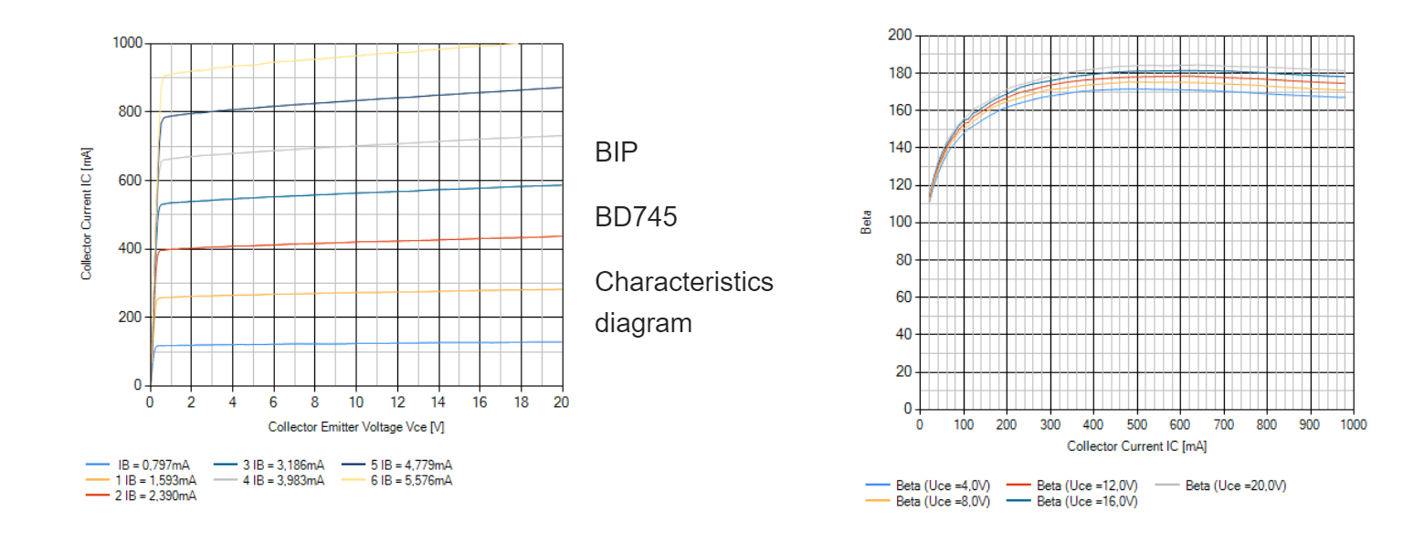

Specs in brief:
Vg: +-12V
Ig: +-120mA
Vd: +-20V
Simply speaking, the tracer has the ability up to 20V/2A, with up to 16Bit ADC used.
This spec is great enough for amateur DIYers, satisfying most measurements of audio transistors, although probably not fully enough for output-stage power transistors.

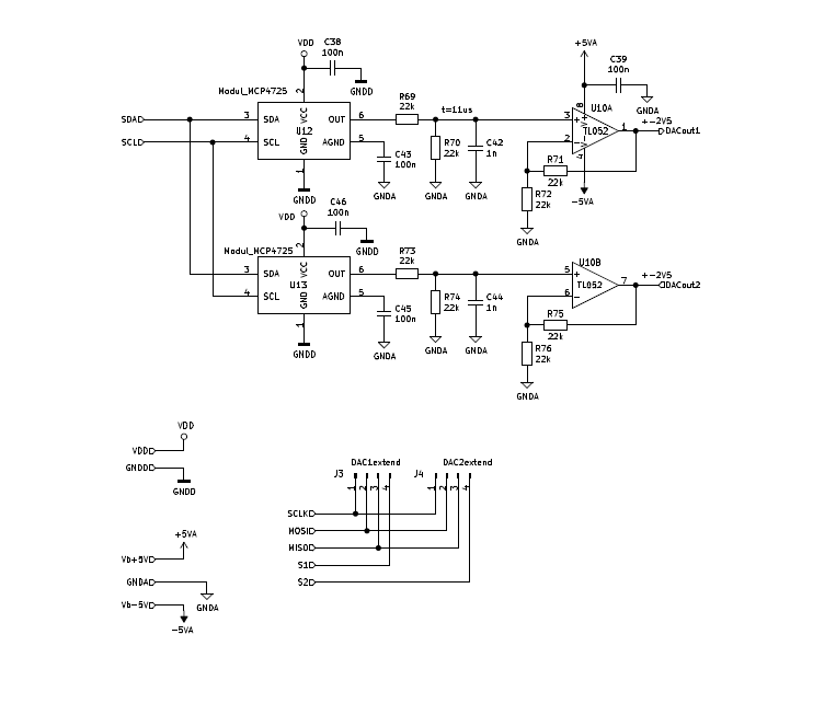

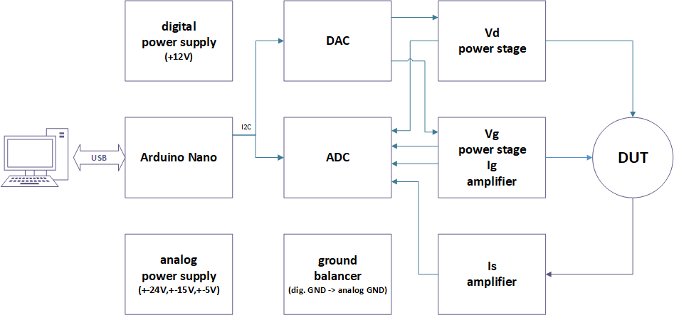

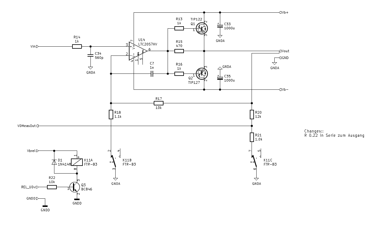

Mechanism of Working Diagram:

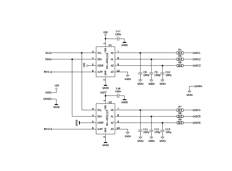

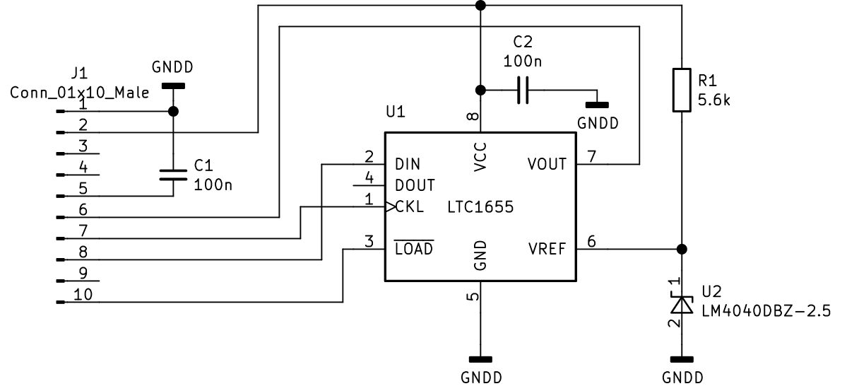

Amazingly, the DAC could be upgrade from 12bits to 16bits! (With LTC1655 module, and independent Vref=2.5V)

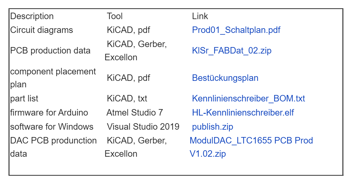

The available sources are below, including schematic, GERBER, BOM, MCU FW and Windows software.

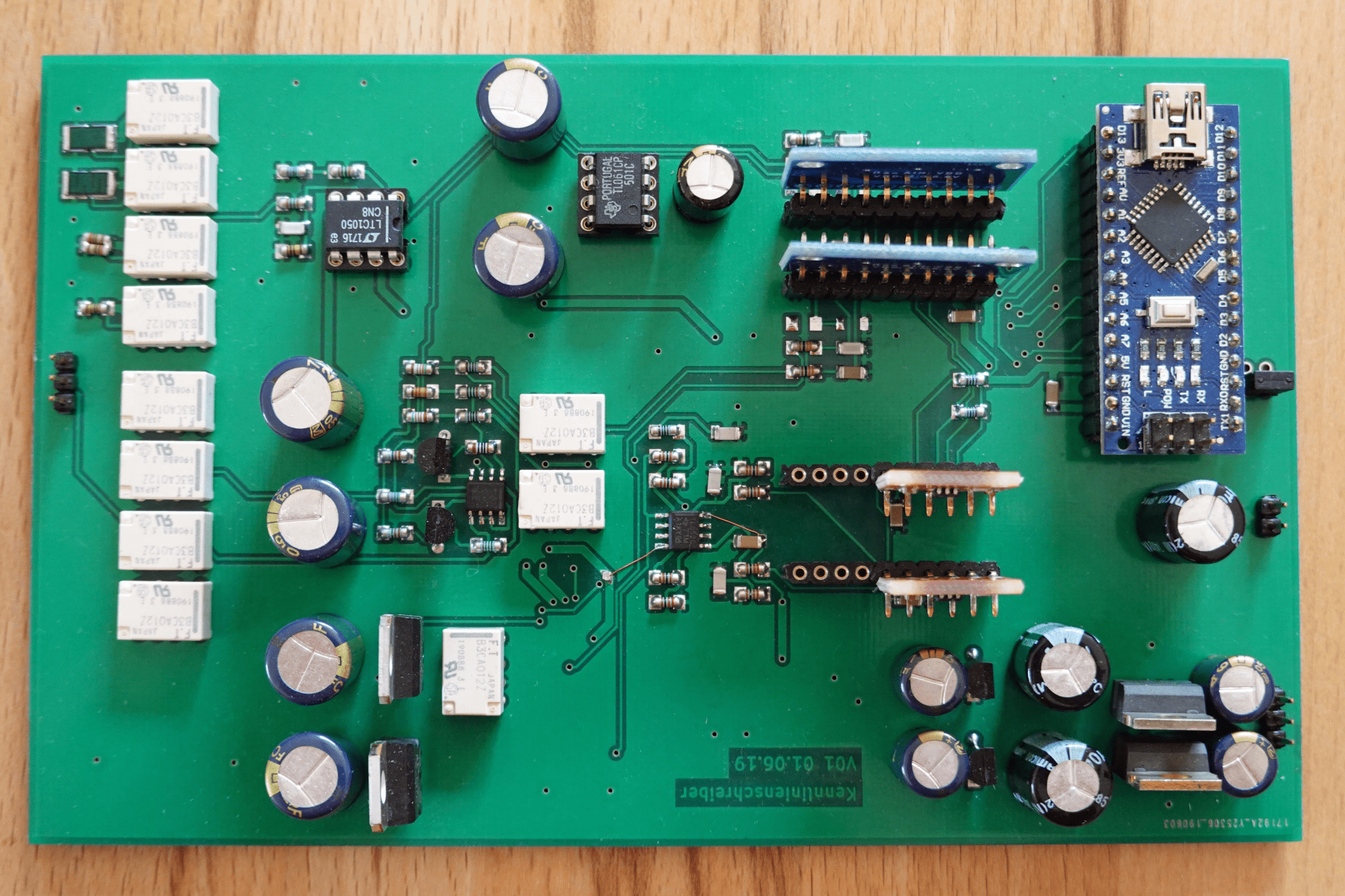

Assembled tracer looks like this:
NOTICE:
I noticed there are fly-wires of the PCB, I am not sure if it is corrected in the GERBER file, so make decision and take the risk by self.
It would be great if the PyPSU Curve Tracer can support Ruiden RD series.
PyPSUcurvetrace now has preliminary/experimental support the Riden/Ruiden RD power supplies, see here.
