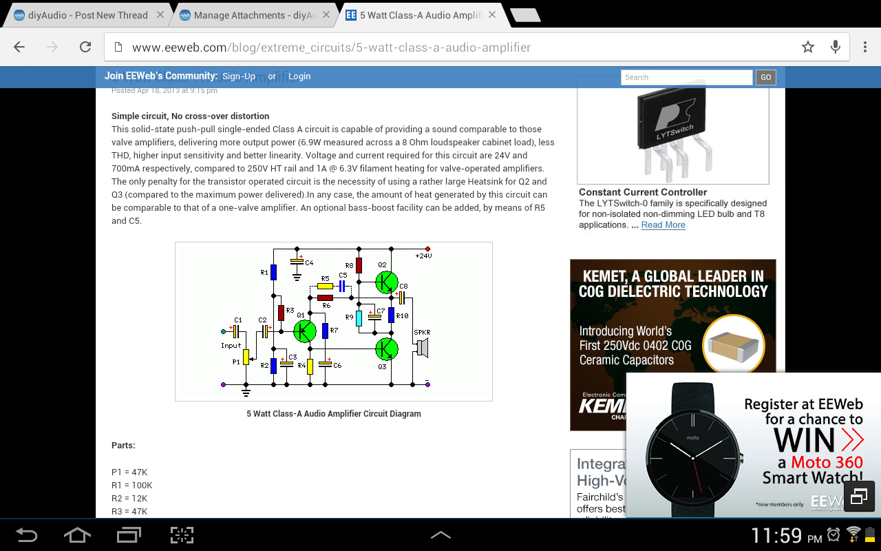

Hello all, new to the forums.
I was wondering if the attatched schematic would work as an amplifier for a 5W 8ohm speaker. The application of this amplifier is for a bluetooth portable speaker.

It should work, but its a bit to simple to be very good. If you want Class A then you may as well aim a little higher, otherwise a simple chip amp as jerluwoo mentions will be far better.

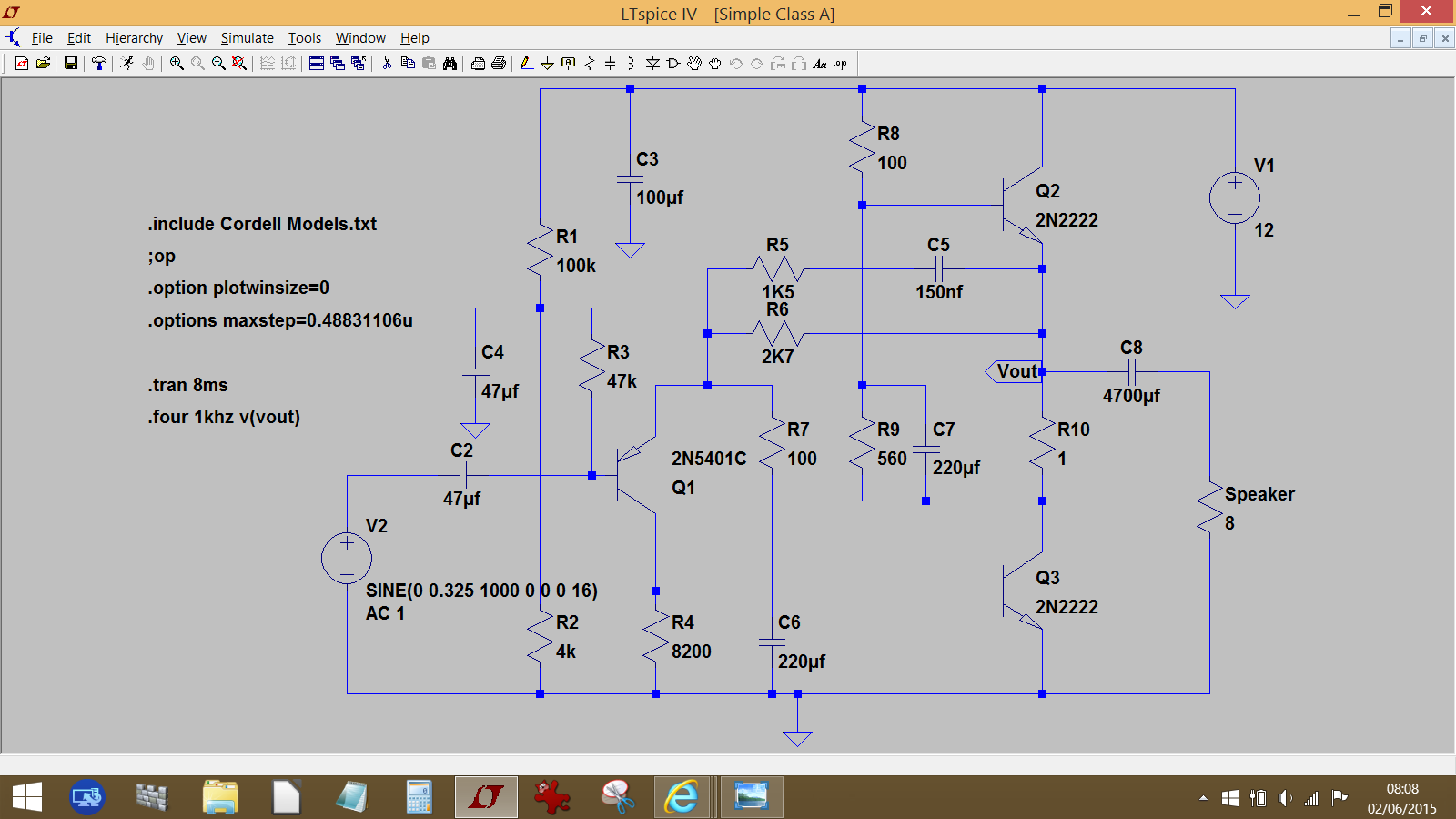

But the last question that I have is can I use an input voltage of 12v instead of 24v, if so are there any drawbacks? Thanks

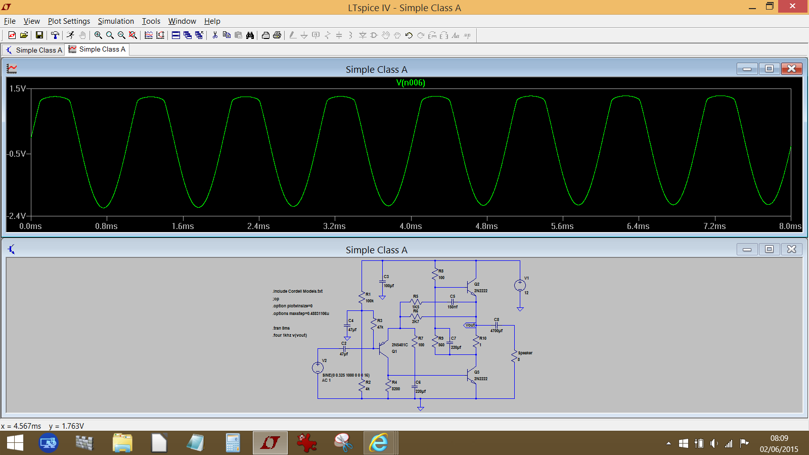

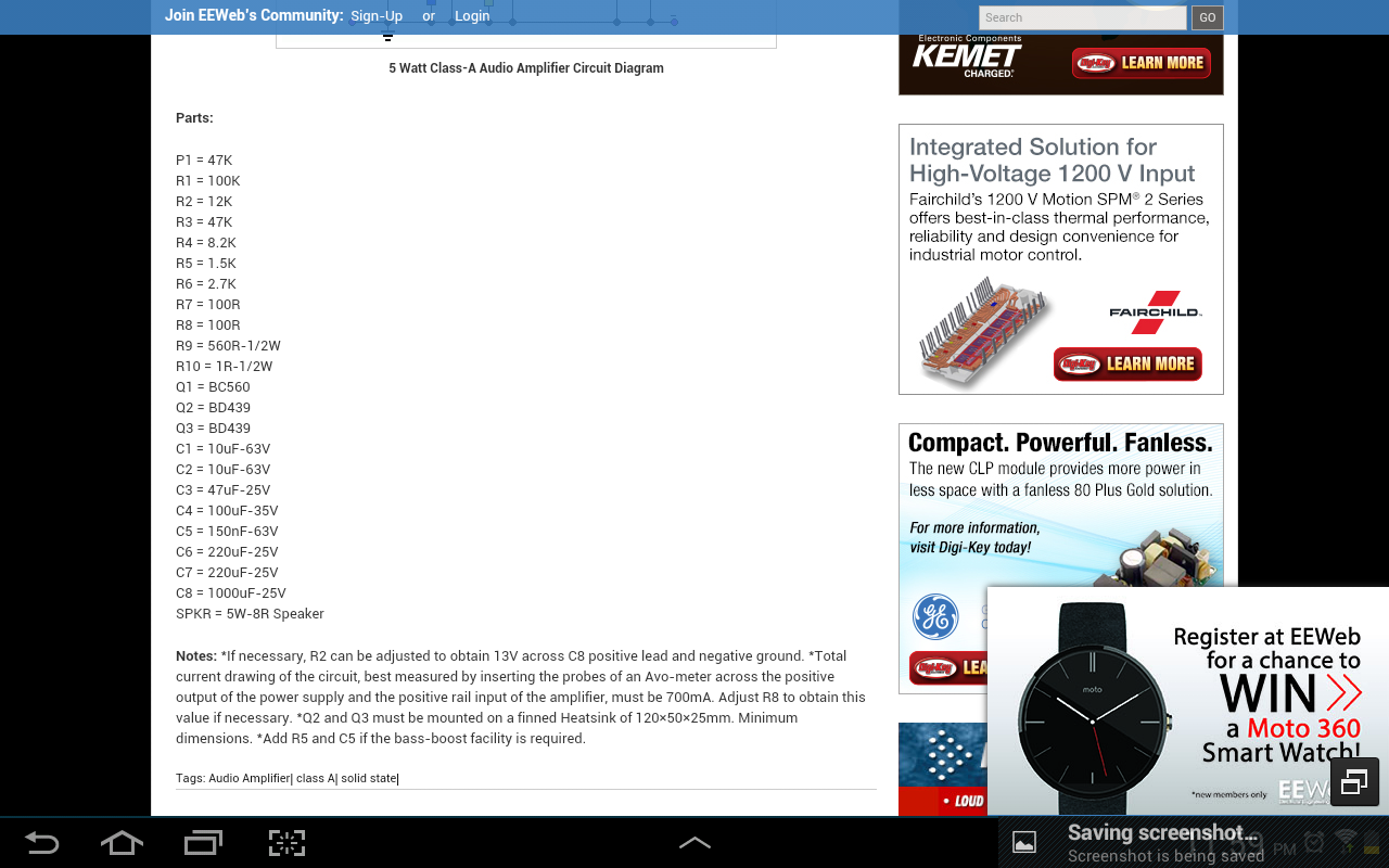

I've tried simulating this simple amp and at a basic level can not get it to work using common device models. The reason I suspect is that the BD439 devices can have quite a high current gain, but that's not guaranteed looking at the data sheet.
This all smacks of a poorly thought out design which should work with pretty much any generic parts.
Check the circuit over and make sure I haven't made a silly mistake copying it over. Adjusting R2 can not bring the mid point volts down from around 22 volts. Even shorting Q1 out still can not supply enough base current via R6 to turn on Q3. I tried several different models of common power devices and all gave similar results. C5 looks a little 'unlikely' too.

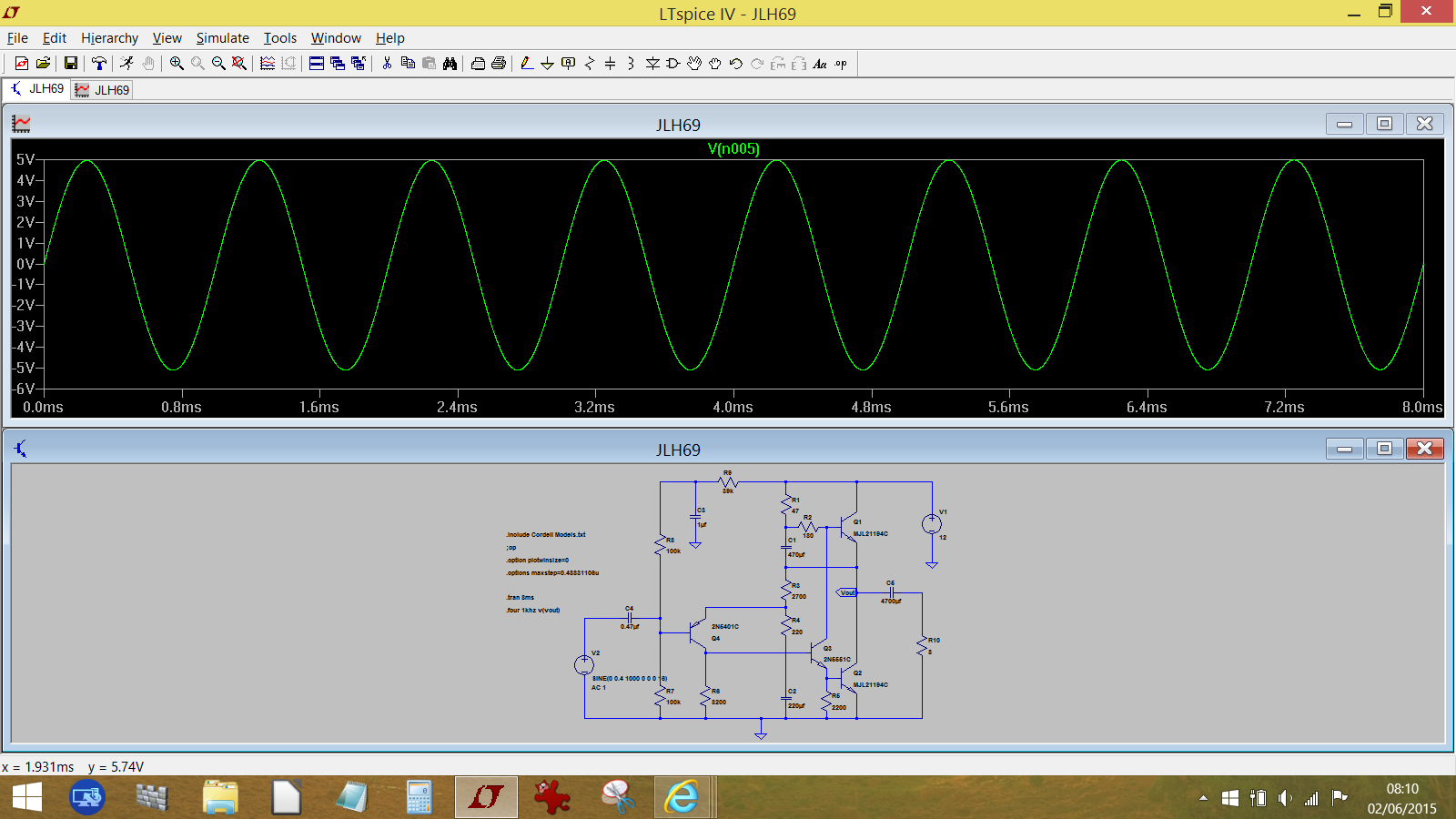

Now compare the JLH69 design I mentioned. No comparison 🙂

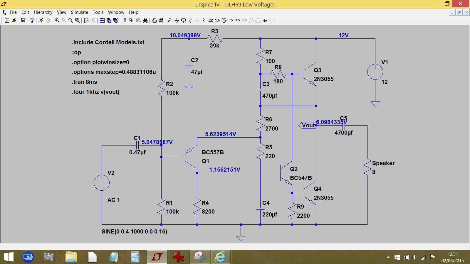

The JLH69 will work OK on 12 volts. We can try and optimise it for that if you like. Each output transistor will dissipate around 3 to 4 watts depending on the output stage current you want.
Do you want the simulation file ? If you click my signature line you can see how to use it.
This is the JLH69 using common transistors. TIP3055 or TIP41 would make great output devices as they are flat pack. The BC small signal types are available anywhere and pretty much anything similar would be just as good. The voltages show typical values for the running circuit.
R1 sets the midpoint voltage at the output to be equal to one half the supply voltage. That could be a preset if you wanted, say a 220k adjusted for 6 volts for a 12 volt battery measured at 'Vout' point.
It will draw around 500 ma at 12 volts.
