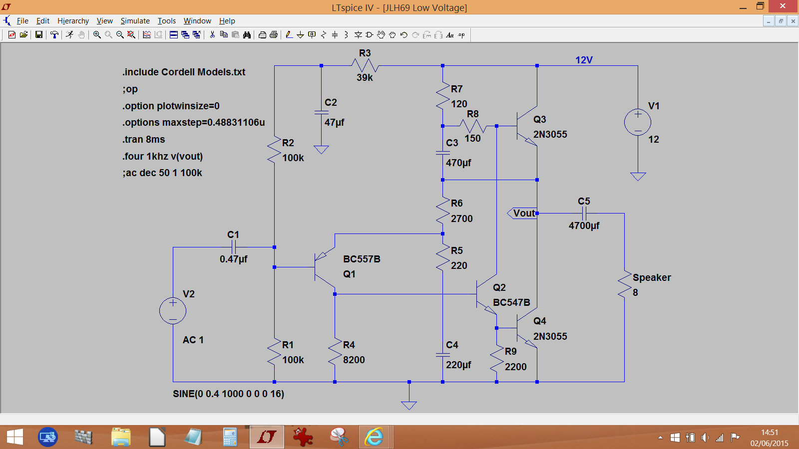

OK, here is the circuit with the component references in a more logical sequence.
C1 sets the low frequency cut off point of the basic amplifier. Using 0.47uf allows a small film type to be used. Its not critical though.
The voltage gain of the amplifier is approximately R6/R5 which is around 12.
C4 sets the lower frequency cut off of the feedback return network. It needs to be large enough not to impact on the overall response. 220 ohm and 220uf give a -3db point of just over 3Hz for that network.
Bias current is alterable by adjusting R7. Keeping it as low as practicable will maximise battery life. We are at about 0.5 amp here.
C5 is the speaker coupling cap and needs to be big for good low frequency response, so at least 2200uf.
That's about it really, it should work with any suitably rated transistors with virtually no change in performance.

I have one last question. What is the significance of c3, and what should the voltage rating be for it?
Also, can I use a 4.7uf instead of .47 uf as a replacement for c1?
Also I don't have a 39k ohm resistor, can I use something close, like 50k? Or I might have a 33k R3.

C3 is called a 'bootstrap cap' and its function is to couple the output voltage to R8. Doing that means the R8 voltage 'follows' the audio and so the current through R8 is more constant. Its a refinement that was commonly used on this style of amplifier. As you are running on 12 volts a 16 volt cap would be ideal.
The 39k isn't critical at all, what is important is the voltage at the junction of R1 and R2, which of course depends on the 39k.
If you stray from these values then the DC voltage at the output (Vout on the diagram) will alter and that means the amp will not deliver its maximum possible output. Ideally Vout should be half the supply voltage (so 6 volts here) as that allows the output to swing equally in each direction.

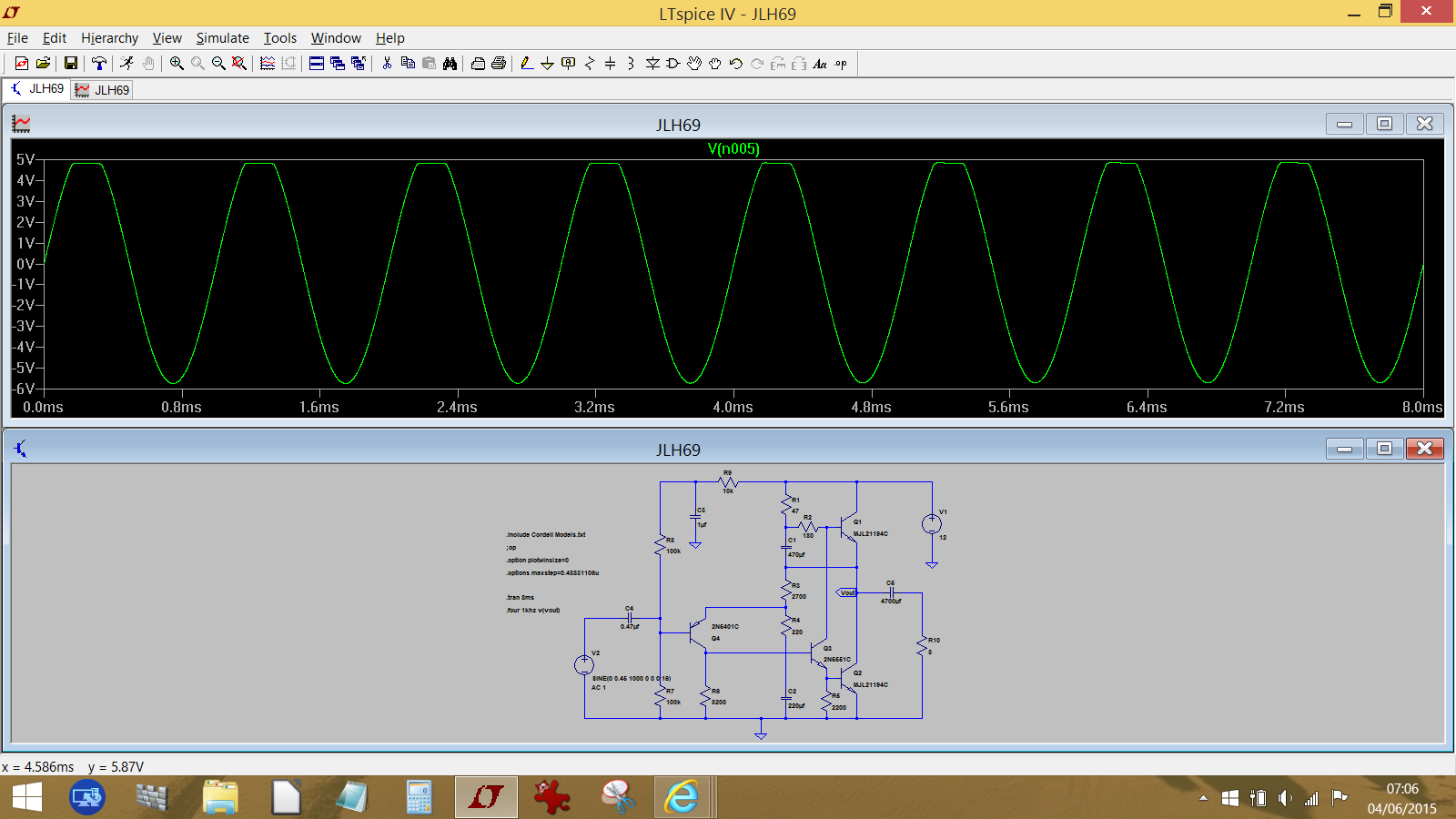

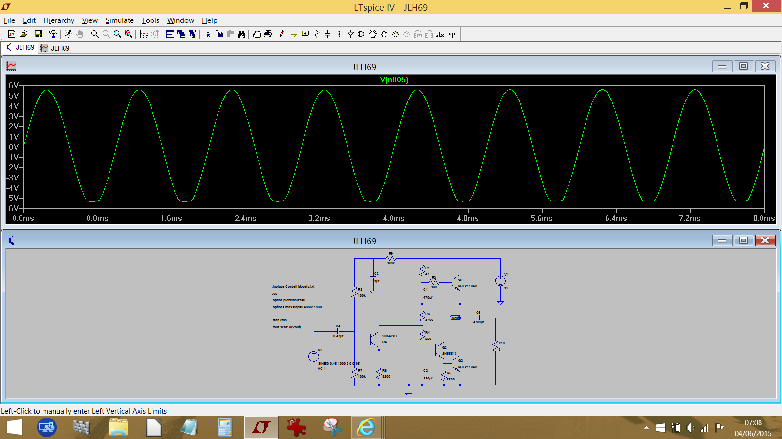

This shows the effect of changing the 39k to first a 10k and then a 100k. You lose the ability to reach full output cleanly with it clipping at either top of bottom depending which way Vout strays from 6 volts. Another good option would be to make the 39k a preset (say 47k or 100k) and then you could adjust it exactly.
Alright so I wired everything up, checked my connections multiple times, but it won't work.
What I noticed is that c5 which I am using 2200uf at 16v gets pretty hot pretty fast. No noise is created from the speaker except for when I flip the switch to on, that's when you here a thump just like any other speaker that you connect the power to.
Any suggestions.
For the 39k resistor, I wired 4 10k resistor together in series.

I'm wondering if it is the arrangement of the transistor pins. For q1 I am using the nte159 pnp, and with the flat side facing you, from left to right I have it as emmitter base collector. Q2 is the 2n2222 npn, emitter base collector. Q3 is nte184 npn, emitter collector base. And q4 is nte184 npn, emitter collector base.

Any fault-finding starts with the basics. We are working to the diagram in post #21, yes ?
Put your meter on DC volts and connect the black lead to ground.
Have the pinouts of the transistors in front of you if you are not sure. You can get data sheets from here,
Datasheet catalog for integrated circuits, diodes, triacs, and other semiconductors, view
1/ Check that the supply is correct at 12 volts as measured on Q3 collector.
2/ Check that C2 and C4 have their negative ends going to ground.
3/ Check that C3 is correctly fitted. Positive end to R7.
Now measure and record the voltages on the transistors. Copy and paste this with your readings.

Q1 has a problem. The 5 volts on the base is correct. The emitter voltage at 1.8 millivolts is very wrong. That can only be one of a couple of things...
Unlikely but R6 could be open circuit or there is a physical break in conductivity via R6 to Q1. Make sure R6 has 12 volts on the 'top' end that goes to Q3 emitter.
Even if Q1 were faulty, you had an NPN instead of PNP fitted or you had the leads the wrong way around it wouldn't give 1.8mv on the emitter.
One other thing to check... make sure you haven't a short from Q1 emitter to ground.
