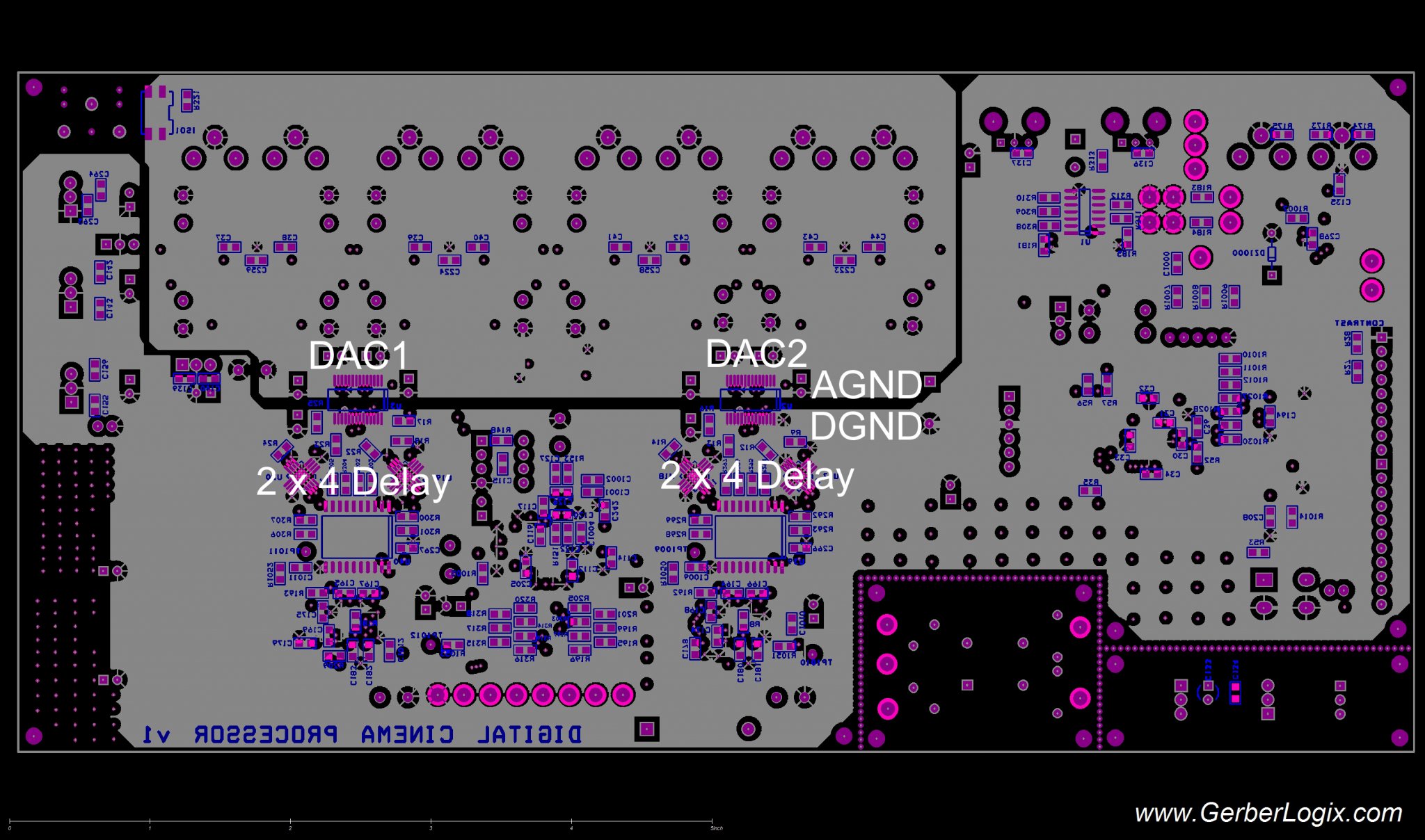

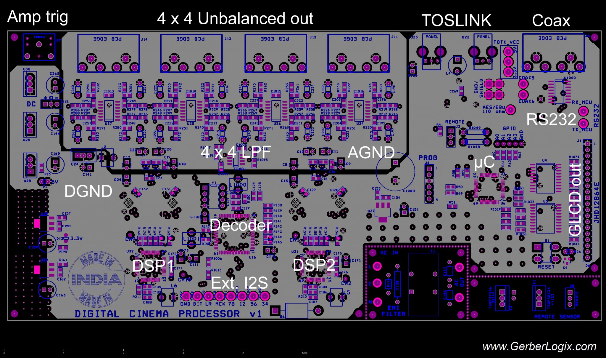

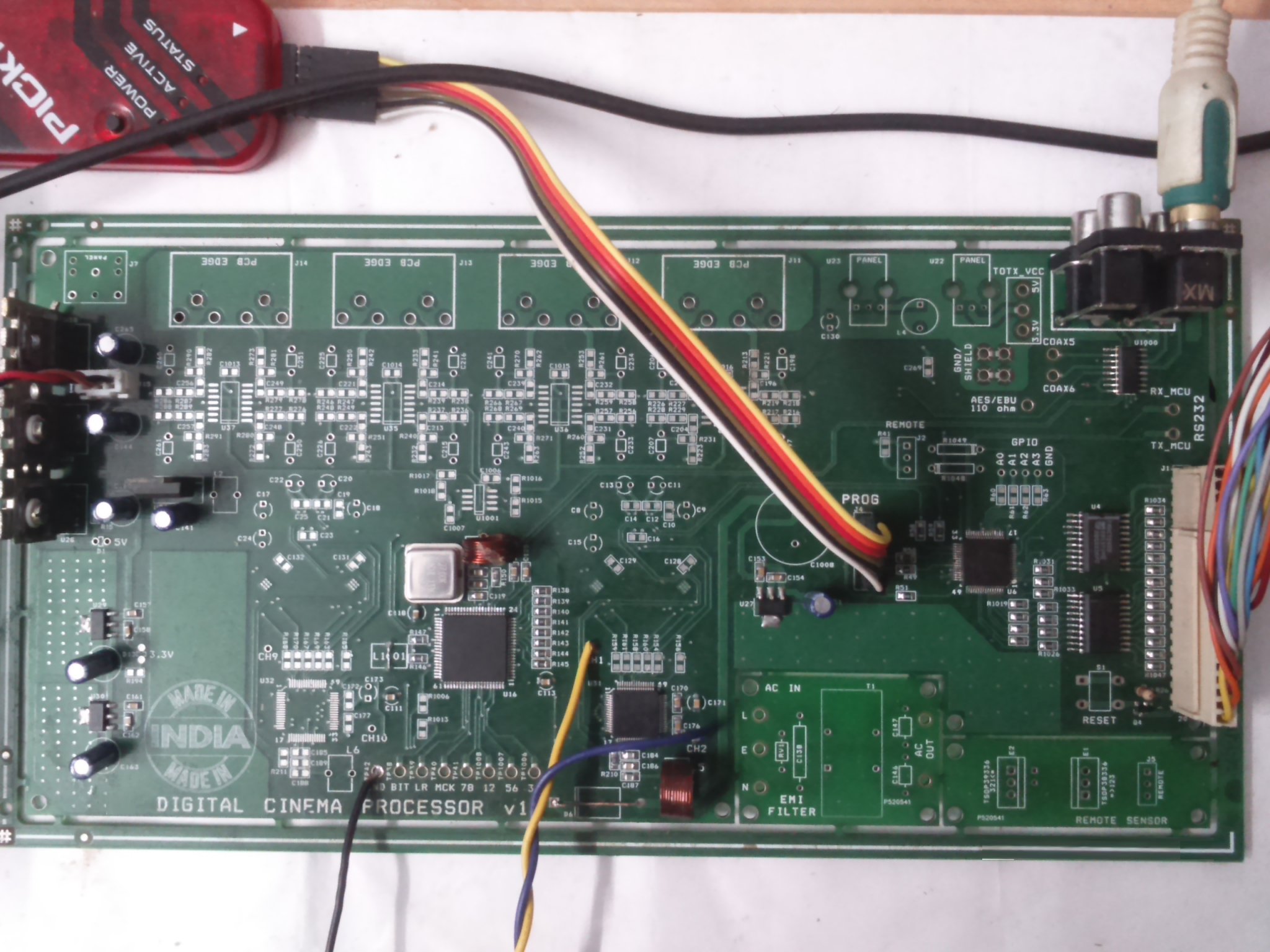

I went ahead with the hardware decoder chip in hand while also including I2S input ports for external decoding solutions. The PCM1680/1 DAC was easy while the new ESS chip looked less friendly and hard to locate.
Attached below are the component placements for the top/bottom layers and ground plane layer (routing layers not shown).
Also, my schematics are similar to the datasheet reference circuits given by the respective manufacturers. Will be reviewing the files for any mistakes / improvements / modifications for few more days before sending it out for printing.
Please point out any potential issues you might find with the layout etc., thanks.

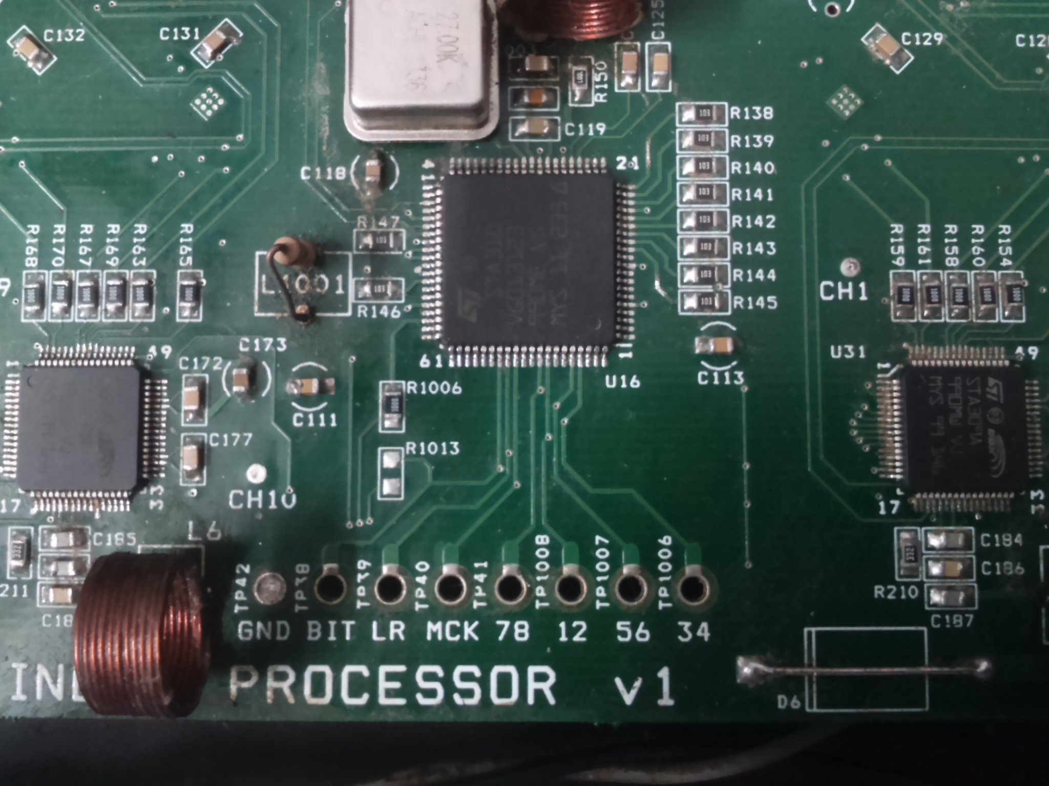

Got the PCB fabricated and partially populated (picture) for checking decoder stage operation. Since the DACs have not been populated, the analogue audio for the testing (for now) comes from filtering the DDX outputs of the processor chip.
So far, everything seems to be working as expected, with the decoder being able to detect, decode and also report the details of audio formats, as shown in the video (attached, rename to MP4 after downloading).

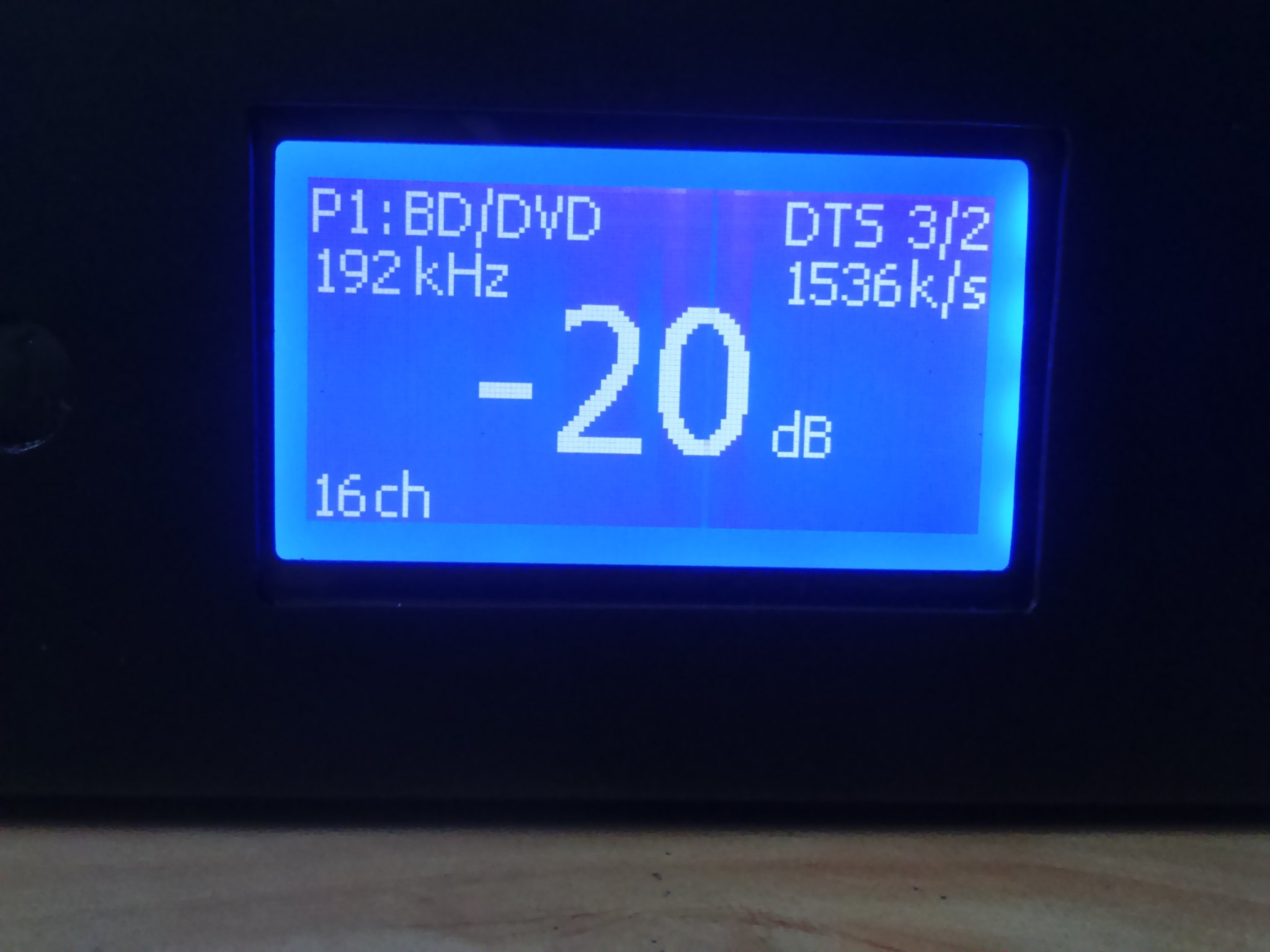

Managed to design a simple, clutter-free GUI template for JHD12864E, the description for which is attached below (pdf). Also attached is a browser-based (mock) interface for anyone interested in experiencing the layout / navigation of the same. The actual GUI, operated similarly, using a remote control, is currently under testing.

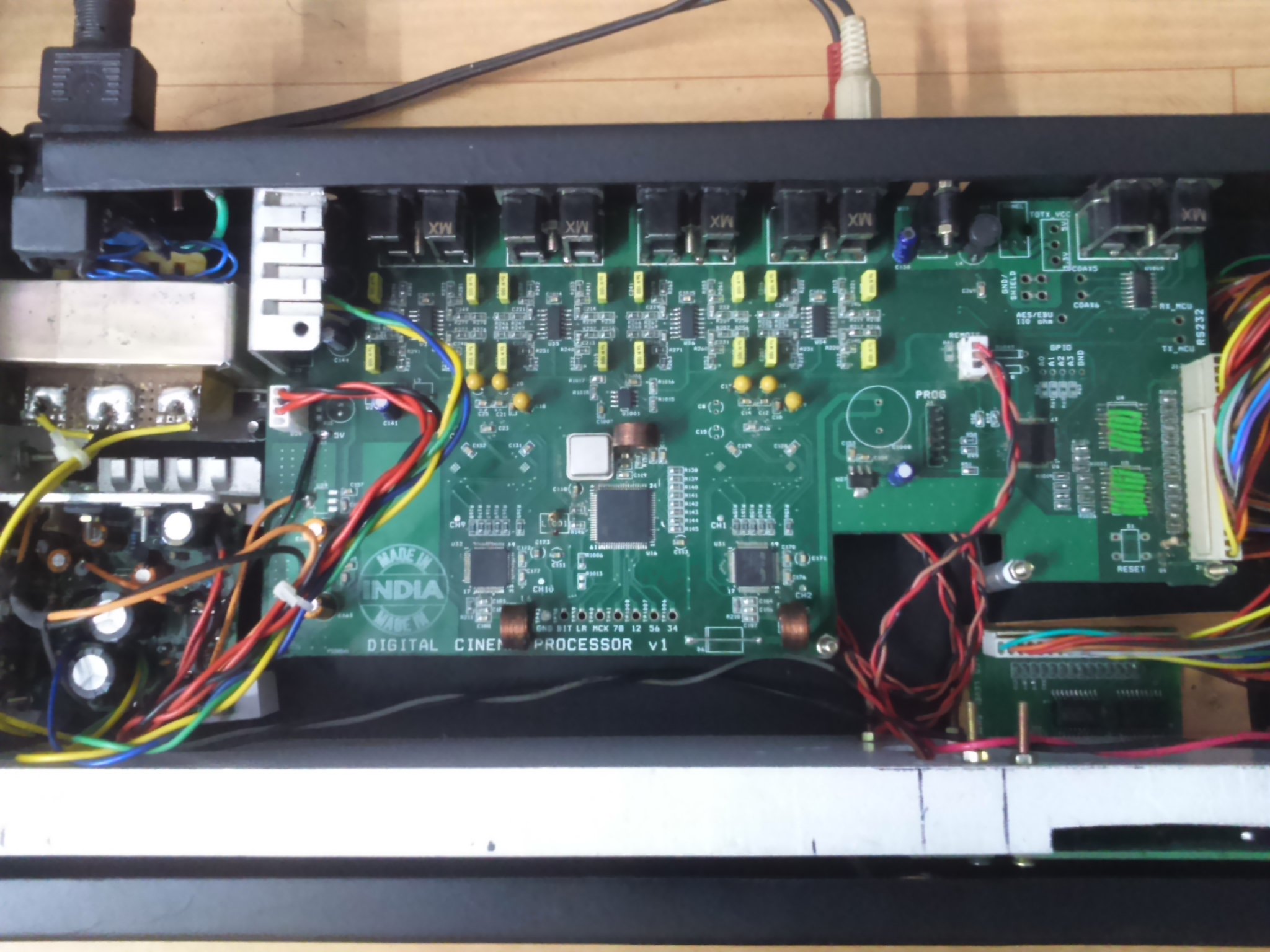

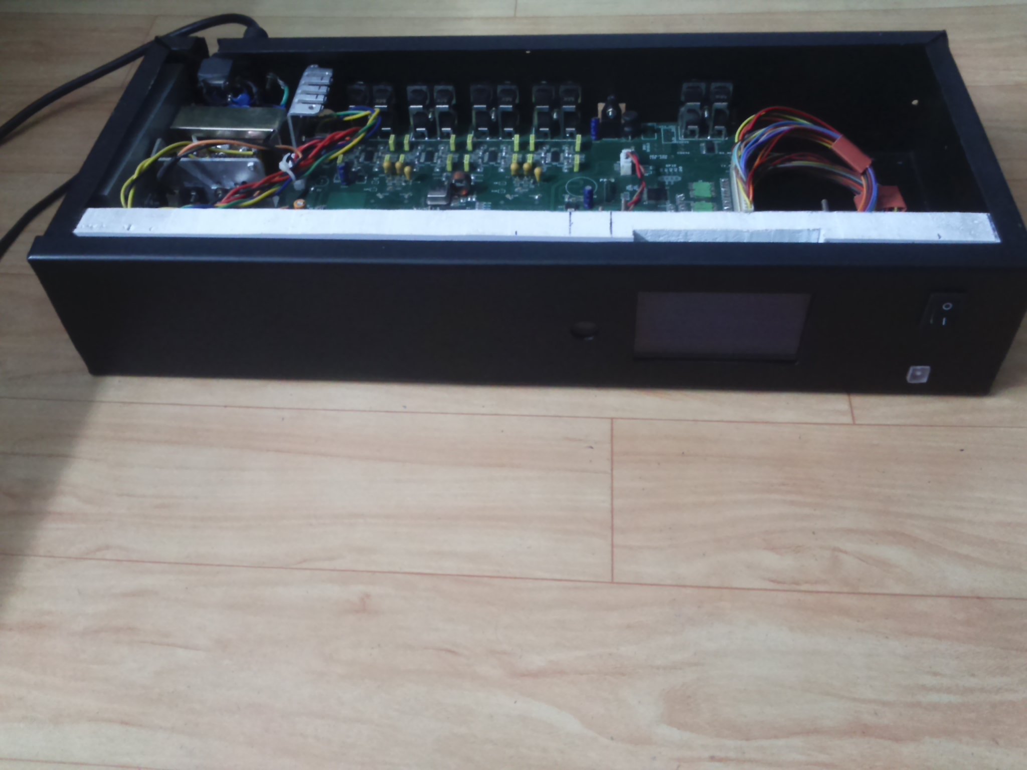

The unit is ready after almost a year !!

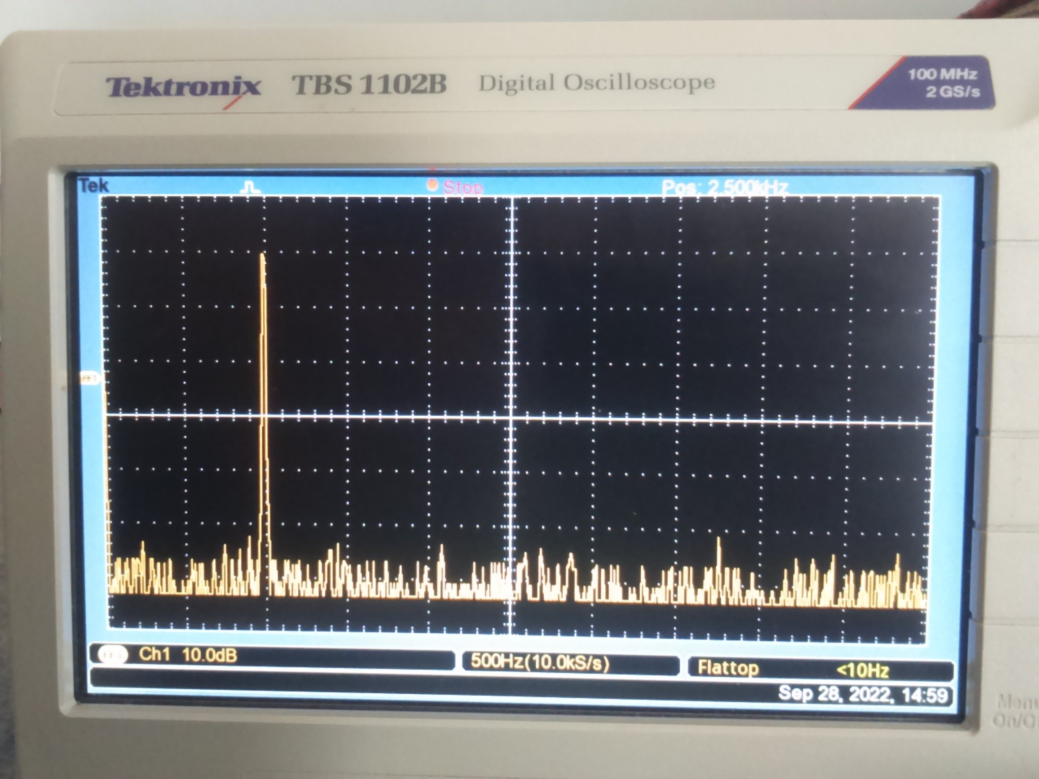

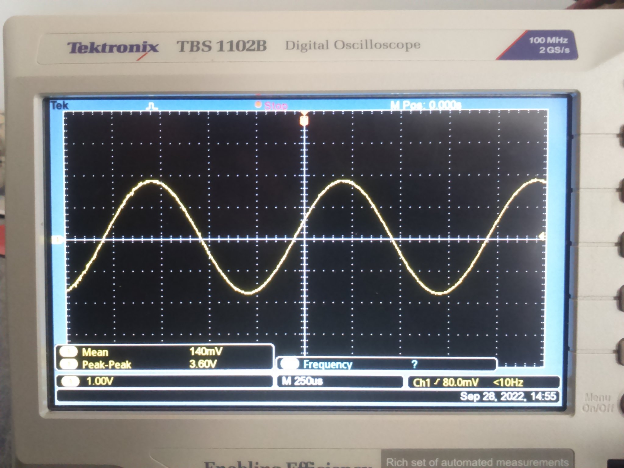

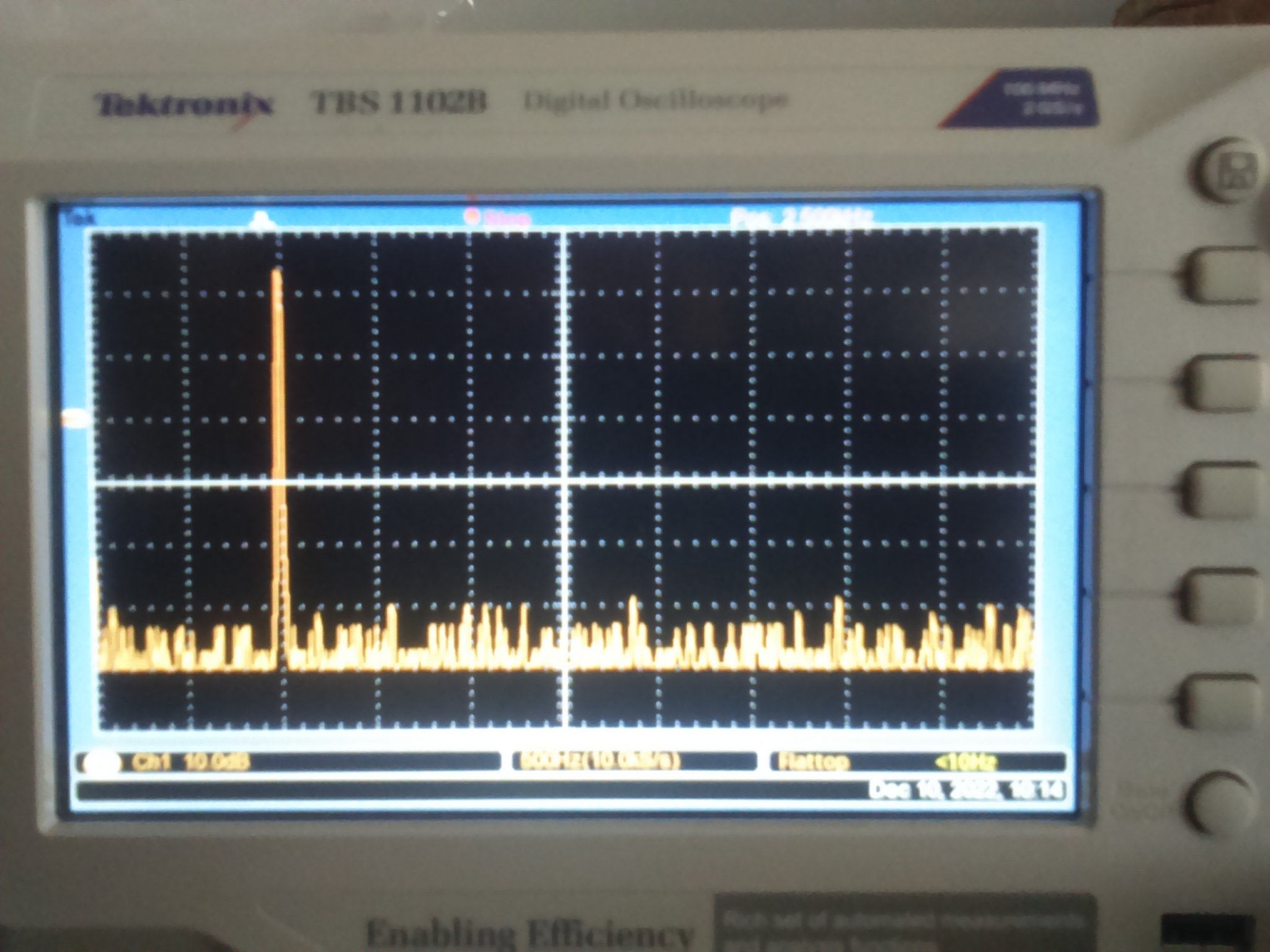

- The SMPS used in the testing stage has been ditched in favour of a transformer power supply for better EMI performance (waveforms attached).
- In order to assess the decoding fidelity as well, the 48kHz/16-bit DTS-1536kbps format was used during sine-wave testing.
- A video demonstrating the filter save/recall features of the unit is also attached (rename file to *.MP4 after downloading).
