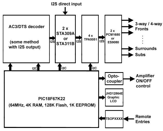

I did not a mean the regular DSP that needs programming, but a chip meant exclusively for multichannel audio processing applications, like TAS5518 or STA309A. Only the control registers need to be loaded by the user (from a microcontroller), as the DSP routines (filtering etc.) are already loaded from the factory.
I think I'll rather go with ASIC hardware with minimal programming, as my hardware skills are much better than my programming skills. Even if I somehow manage to pick up some programming in the near-future, it's still very unlikely to be sufficient enough to result in a good product that is comparable to commercial units.
So, here's what I'm looking at now (attached).
Sounds like a very good plan, if you can source the first and most crucial block - the HW proprietary-digital-formats -> PCM decoder. Any ideas about its availability?
a) I have a few STA310 (AC3/DTS/MPEG) with me from sometime ago but unfortunately, this chip is not in production now. If nothing else, I might use it.
b) I also have a Yamaha RX-V571 which, according to the following database (below), seems to use the PCM1681 DAC chip. So, I guess, I just have to pull out the I2S connections from pins 5-8 & 10-13. The bits are probably 24 with 32 bits per slot, giving BCLK of 64fs. Fs could be variable though.

I decided to stop at 5.1 channels. Decoding the formats was the biggest issue. I am planning to use the Blu-ray and dvD/SACD players to do the decoding. They will send it out as LPCM. I bought a multichannel HDMI to I2S converter board to eBay. We will see how that works. I plan to send the I2S signals to a computer via USB for processing. Processed signals will return via the usb and converted to I2S and fed to Ian’s McFIFO and then fed to 4 AKM 4493 DACS. I am mostly concerned with playing multichannel musical records ripped from dVD-A and Blu-rays.

Once you're I2S, you're in a nice position to do whatever you want with your signals. Though there have been many (really) short threads on HDMI=>I2S/PCM on this forum, it would be very helpful to many if you write your assessment of the said ebay HDMI=>I2S board here. Proper licensed decoding using Blu-ray/DVD is probably the best, but this board could also be useful to those who use their PC / media player as the source.

I’m trying to understand which blu-ray players output a decoded Atmos stream that would be steered to 16 output channels by a receiver that has no Atmos chipset/license. Afaik, the chipset in the receiver is responsible for holding the Atmos speaker configuration meta data - how would you deal with this part?
Can HDMI even pass more than 8 channels of LPCM audio? Not sure of any Bluray players that can decode Atmos to LPCM. I think they are only able to bitstream Atmos.
In my opinion, all those who want Atmos will have to hack an AVR's internals, like I have mentioned above for the Yamaha family. That way, you have a licensed decoder, do not compromise decoder fidelity and also get all features of the AVR except its power amplifier, like source selection, volume control, remote etc.
Alternatively, someone has to come up with a method that allows two graphics cards with accompanying software that would then possibly allow the use of a PC.

Multichannel PCM output is no problem, USB UAC2 can handle 42 of 192/24 channels, USB audio gadget 14 192/24 channels out of the box as it does not implement high-bandwidth (multiple transactions) mode.
But decoding Atmos to PCM on a PC is a no go:
https://www.avsforum.com/threads/atmos-decoder-in-2021.3214420/#post-61060229
Most likely the above claim is true, googling revealed no other Atmos decoder for computers, let alone open source.

The AVR hacking method can work but the "hacker" needs to know the sampling frequency and OS ratio to set up the processing interface. If not, the processor must be capable of auto-detecting the same. However, this problem could be simplified by using a fixed sampling frequency ,say 48kHz, all the time.
What extra features would the hacked AVR + the DIY cinema processor combo offer compared to the original non-hacked AVR?
The main idea behind the DIY processor is to operate active multi-way speakers with lots of paraEQ per channel, that most AVR's do not support. However, AVRs are good with the decoding part of things, in fact, they're excellent. For example, my AVR supports only LR bi-amping with a fixed crossover frequency at the expense of the rear surrounds (which is pretty much a useless feature), but it can decode all HD audio formats without any issues.
If, by any chance, you happen to have an Atmos unit that supports at least LCR bi-amping, then you may not need this DIY processor. In short, this kind of stuff is for poor people who can't afford to get themselves the real thing.
