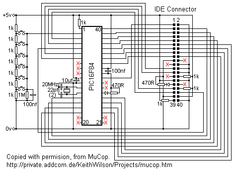

i have reproduced the circuit design from the mucop site, but the network card has died on my other pc, so i cannot connect to the internet. i will post it when i can.
i have also purchased the parts, and i should be able to test the results in the next week or so.
Mattcatt, in your schematic couldn't be 16F84 (only 18 pins). Anyway I'm working on a version with 16F8xx that supports LCD display and remote. The first attempt of sound will be with AD1892 receiver with some reclocking.
The ATA specs are really a mess; I hope I can transform data into I2S with a help of a CPLD; otherwise a DSP will be the only alternative to make a good standalone CD.
If you are going to do anything that actually requires the power of a DSP chip, then you might as well go down the PC route. Unless you plan to process, e.g. equalize, the data in some way, a DSP chip is a complication one can well do without.
