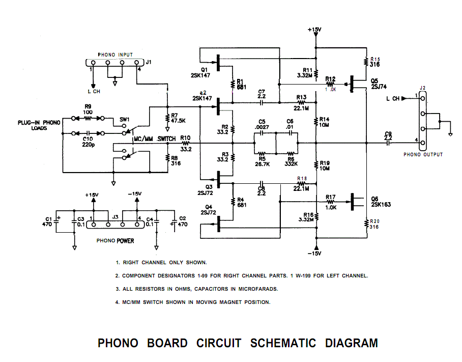

I might be misremembering; what you describe here makes me think of the phono preamp in the old Hafler 915 preamp.
http://www.hafler.com/techsupport/pdf/Series915_preamp_man.pdf
Curiously, never hear about anyone "cloning" this ... 😕

If you use a 2SK170BL at Idss you get around 40mA/V transconductance... Use a second J-Fet as Active load and you can easily get 1MOhm load, giving a "near DC Gain" of around 92dB, which if you use this 1M Load as LF determinant of the RIAA EQ allows 72dB Gain. Add a third J-Fet as buffer/follower and you are done.
Ciao T
There are parallels but the Haffler phono uses feedback Equalisation, my suggestions works feedback free...
Incidentally the Hafler SE-100 or 915 Preamp Schematics show very seriously high performance FET Circuitry. It is a shame this stuff is underappreciated.
The designs are by Jim Strickland (ex Acoustat), to who'm I doff my hat in respect, it is rare that we see simple, innovative and high performance circuitry the way he did his designs.
Ciao T

I just wanted to say thanks for the JFET op amp circuit you posted. Back-of-a-napkin it may be but it's sufficient. I get the idea, and certainly the small parts count make it attractive.
This is a bit of a problem. I've been looking at the current status of through-hole JFETs and, yeah, it's not looking good: End-of-life, not-recommended-for-new-design, out-of-stock, discontinued, not stocked, part number not found...
Mouser right now is down to about a dozen TO-92 n-channel JFET models that are bone-fide active, not OEL. Everything is "low Rds on for switching applications".
I mean, I'm sure I could track some of these down, at least in personal use quantities, but are there any useful-for-audio JFETs still around if one wants to stick with widely available and easy to source parts?
I have a load of 2SK170/2SJ74 pairs selected for this kind of Job.

Nelson (Pass) uses 2SK370 / 2SJ108 which appear current and are similar to the K170/J74 pairing, but use a different process AFAIK, so performance is not identical hence a new number.
They should be close enough for government work though.
Ciao T
