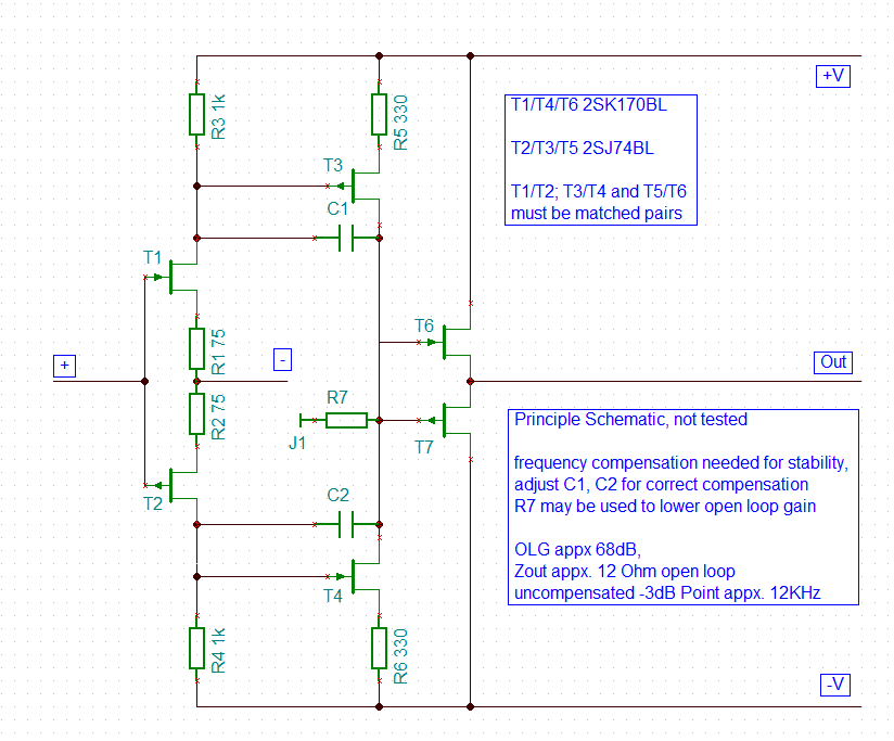

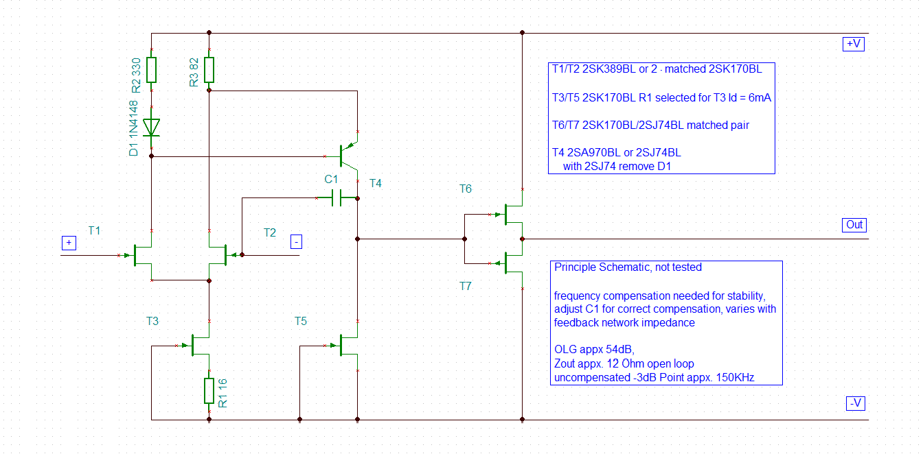

Essentially, the resistor to ground (part of the FB Loop) sets the transconductance of the circuit (it is voltage in - current out).
A second resistor then can set the gain because with a known transconductance we can set the gain simply with a resistor from the output to ground.
I would personally replace the diamond transistor with a pair of J-Fet's (1pc N-Channel, 1pc P-Channel), the mentioned 2SK246 and 2SJ203 would be a good choice.
The beauty is that while these circuits CAN use looped feedback, they do not have to and they can even be made switchable between the two alternatives if desired.
For line outputs a direct output is okay if the design is sound (pun intended), for 'can's I would add a nice open loop Fet-Diamond buffer...

re the 47 labs amp, yes I see, I think: the feedback resistor could be grounded to cut the feedback loop back to the previous stage and the whole thing should still basically hang together.

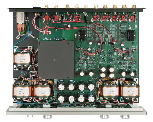

Looking through a wide range of circuits I find the C-21 very generic in terms of circuit, with much attention paid to and money spend on the passive components (not necessarily a bad choice TBH), but the gain circuit can really be improved upon, a lot actually...
In my view the design of the Phase Tech CA3 instead is one that evidences considerable skill in circuit design and optimisation out of 10 I'd give it 9, with the pioneer scoring maybe 3...

I got the impression from looking at the schematic that the designer had considerable skill and the circuit was carefully optimized for sound quality. PRR disagrees, but that was anyway my feeling after looking through a dozen or so similar documents. The other option was the Classe DR-4, but I considered that a bit too complicated.

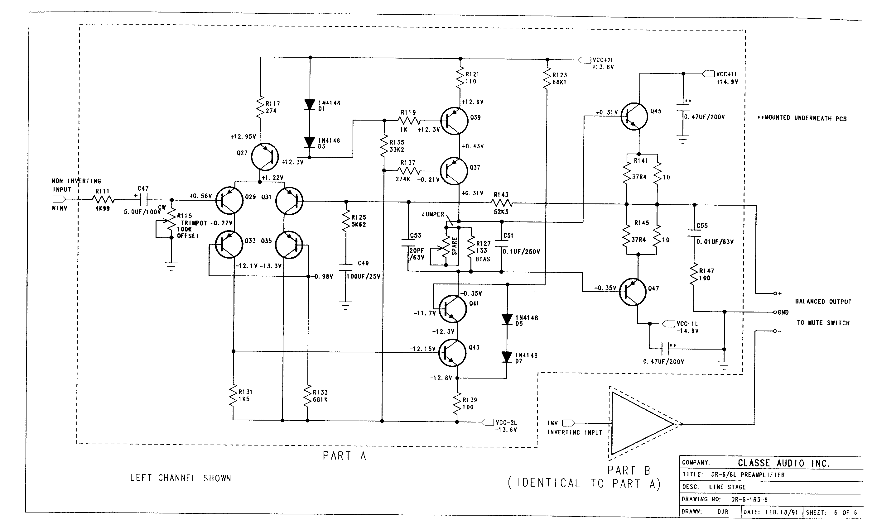

Classe DR4/6 core attached. Dave Reich's stuff ... I don't follow the topology well enough to pass judgement on "innovativeness" but it was some nice sounding gear.
The overall topology isn't innovative, even in 1991 when the schematic was drawn. Douglas Self calls it the generic amplifier configuration, and his particular versions of it are the 'Blameless' amplifiers which you might have heard of. See here for an introduction to possible modifications:
Distortion In Power Amplifiers
You'll quickly see that there are lots of variations on the basic theme.
The Classe circuit you've posted uses cascodes in the first & second stages. Some of the cascode voltages are set by the base current which is unusual (a lot of people will say bad practice) and requires knowledge of the transistor current gain or some way to adjust the cascode voltage. At first glance, the voltage at Q37 emitter looks wrong.
Have fun exploring.
Yes, there are a few things going on in this circuit that expereinced designers would not do, and I agree steveh49 that this is not at all innovative.

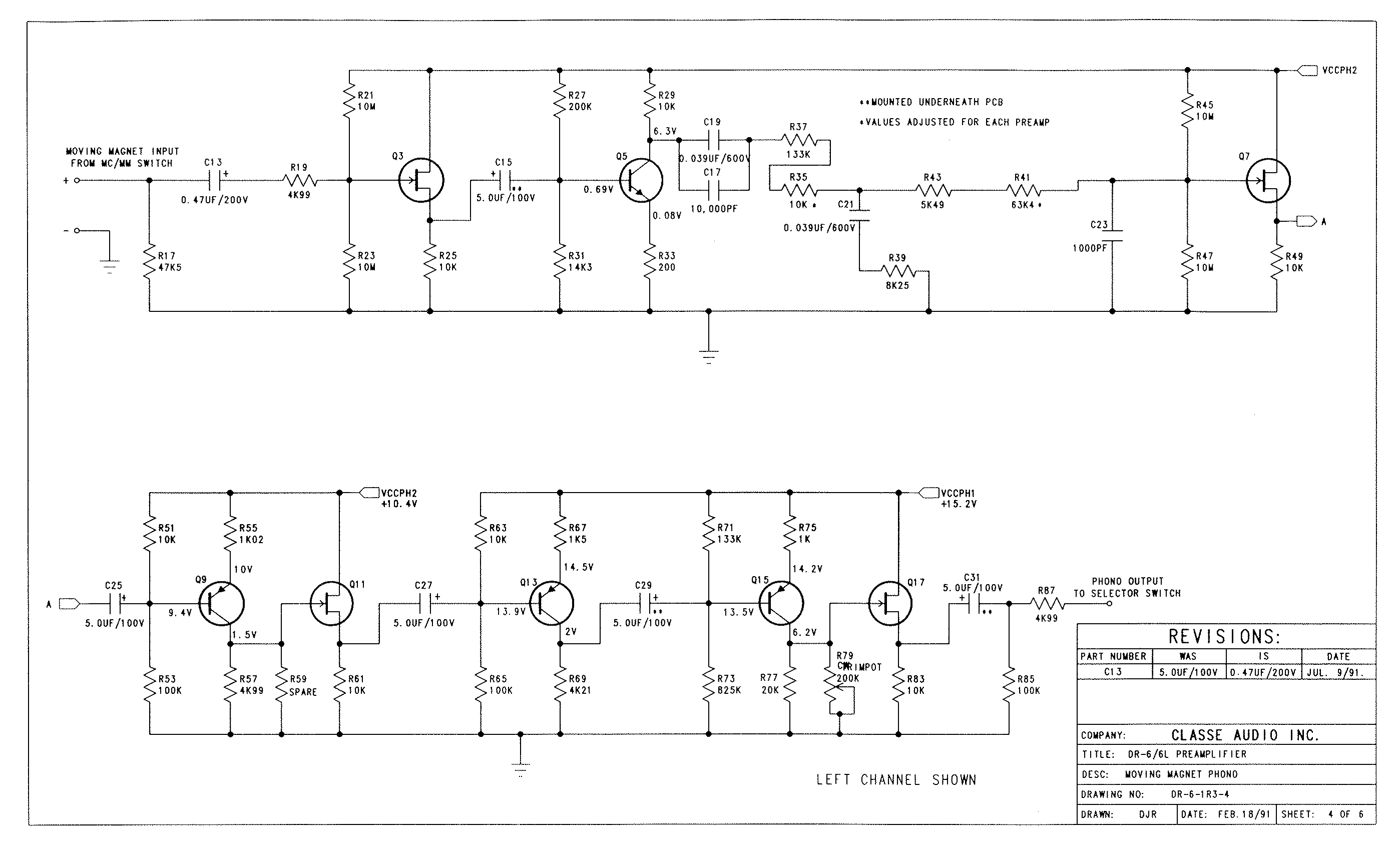

I thought the Phono-Stage was quite cute. This circuit is a generic Op-Amp style, but with cascoding, which is an improvement. The way the cascodes are biased are a bit odd and make them both less effective and more variable due to the tolerances of the transistors used. Bipolar transistors on inputs are really not a good idea IMNSHO.

Phono stage is cute, or that line stage?
In perhaps 70% of discrete preamp circuits I've seen so far, the line stage gain block is re-used for the phono stage, with the simple addition of extra passive components in the feedback loop to initiate the RIAA eq.
The DR4/6, probably because of the complexity of the balanced line stage design used, is a notable exception: the phono stage is a completely different beast, and I would have to say unusual, odd even.
The MM stage alone has no less than 7 DC blocking capacitors in the signal path! Stage after stage of BJTs buffered by JFET source followers. To this day I cannot grasp the rationale for this design.
The phono stage is.
Yes, but I would say that given the dramatically different requirements this is not the best idea.
We would have to ask David Reid for his reasons. Yes, it is odd, but it does introduce some interesting concepts, hence my comment "cute".
First, the J-Fet Buffers do make sense. The whole Phono is open loop and each stage is quite heavily degenerated, giving good linearity but low gain.

Use either PNP BJT or P-Channel J-Fet in a Lender Circuit as VAS with another 2SK170 as CCS load for the VAS. Again, this needs minimal numbers of Resistors, only one for the CCS and a load, if we want to pad down the open loop gain. I would look at getting a current near Idss for Fet so maybe 9mA.
If we take a 1V dropout from the rail and a PNP Transistor (say 2SA970) we get a Diode in series with 330 Ohm for the load of the +input (delete diode if using 2SJ74) and 82 Ohm for the load of the inverting input. Base/Gate to Drain of +Input, Emitter/Source to Drain of -Input.
CCS to the negative rail with 2SK170 at Idss.
From the output node of the VAS use a 2SK170/2SJ74 follower.
If we want to avoid to use a 2SJ74 in the follower, a single ended follower may be used emplying a matched 2SK170 Pair, one Fet as follower the other as CCS to the negative rail. Such a follower is limited to Class A lone and hence is limited to lighter loads (no less than 2K).
The Transconductance into the VAS Output node will be around 63mA/V (regardless of J-Fet or PNP Trasistor VAS), the 2SK170 as CCS run at Idss has around 8K impedance, so open loop gain will be around 54dB, without additional compensation the -3dB open loop point will be around 150KHz (or 53MHz GBWP). Linear input range should be around 0.8V Peak-Peak.
We could use different CCS for the VAS load, cascode the 2SK170 etc. to give more open loop gain, but this detracts from the simplicity of this circuit. In theory the 2SJ74 in the output (and VAS if used) limits the rails to +/-12.5V to not exceed ratings. In practice others (like Fred Forsell) use the 2SJ74 at much higher rails in the same kind of circuit.
Attached the principle schematic, note this is neither build or simulated, just calculated and drawn "on a cocktail napkin" and may need work/adjustment for best performance, however in the most basic sense of the word it should work.
It is easy to extend this circuit to be rail-symmetric using 2SK389/2SJ109 inputs (for those who are lucky enough to have these in their stash), 2SJ74/2SK170 VAS and the same output buffer, but that is left as an exercise for the reader.
Ciao T

Current feedback circuitry is also easily possible. Attached a quick "back of the earlier cocktail napkin" design for that.
If the -Input is grounded or uses a low enough impedance (< 10 Ohm) the open loop gain approaches 68dB, though overall a lot more degeneration is present, so transconductance is lower.
Around 3V of each rail are dropped out by the circuit, so 15V rails would allow 24V peak-peak or 8.5V RMS output.
Another fun fact about this circuit is that it may be operated without feedback loop.
Use a suitable value of R7 and of a resistor from -in to ground and you an open loop circuit. If we make R7 5.1K and desire 12dB gain the resistor from -in to ground would be around 3.6K. In this case omit the compensation capacitors, bandwidth will be around 200KHz...
Gain then scales with the resistor from -in to ground.
Ciao T
