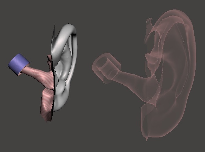

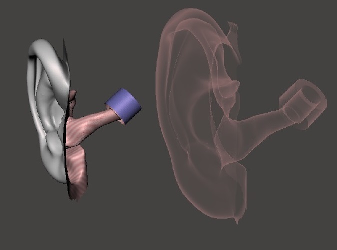

A couple cool pictures..

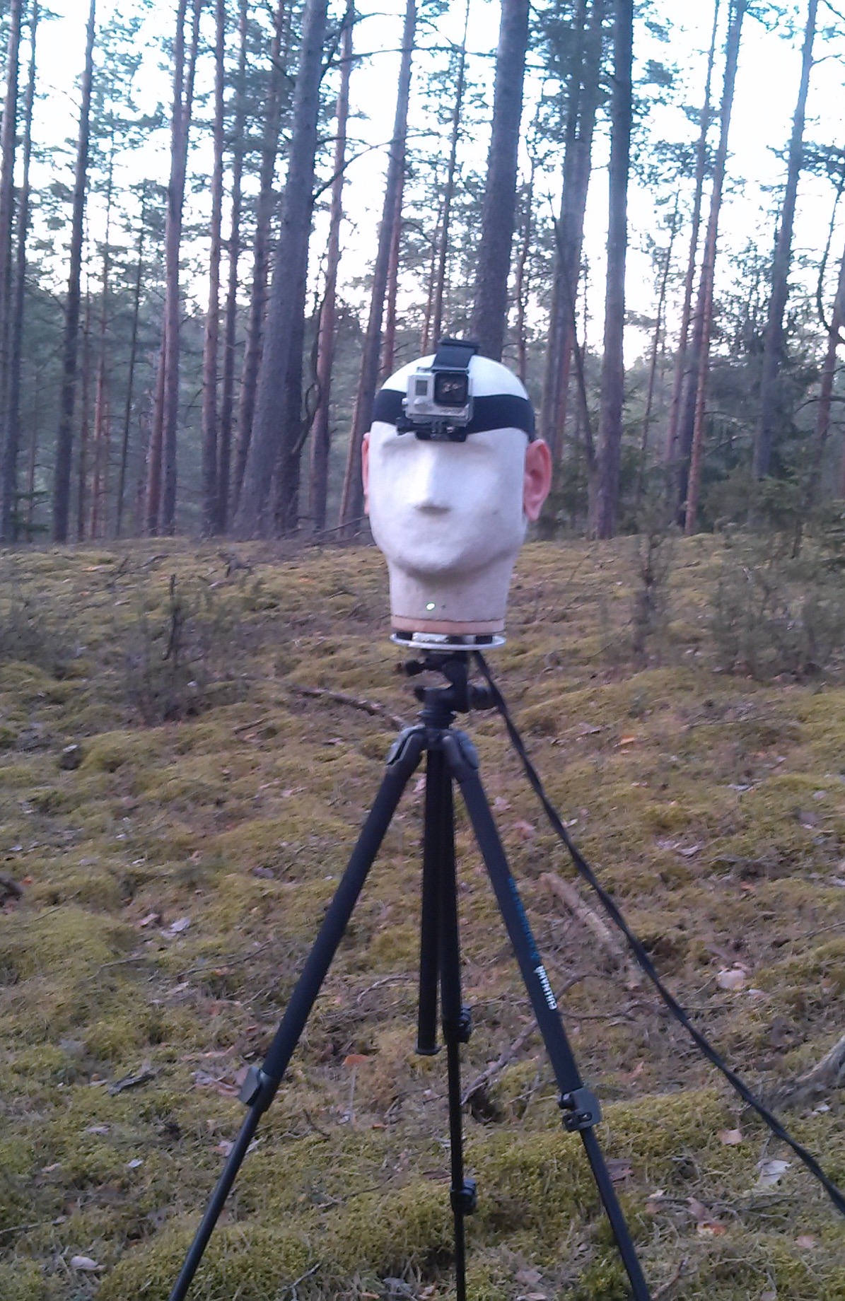

Several years ago i made my binaural head.I thought that ear canal is important, so I have tried it with and without ear canal.My ear canal is kind of straight shape silicone material. That was no way a scientific test, but i recorded noise of plastic bag crushed between hands 0.5meters in front of the head and 0.5meters behind the head. with ear canal and without.
Recorded sounds without ear canal in front and in the back are very similar and impossible to tell with confidence which one is frontal. With ear canal is better, and i could tell where was frontal sound, because of bigger differences in high frequencies. Later i compared this with real world test. Closed my eyes and asked my wife to make that plastic bag sound. And without head movement and visual cues frontal/back sound difference is not so obvious you would imagine. So i was very happy with my binaural head.
Interesting thing that scientific papers says that blocked air canal captures all the directional info. And ear canal just adds its transfer function on top of that. (hence direction independent). Common sense tells that pina+ear canal is one direction dependant system and cannot be analysed independently. But i did't find papers fully supporting this.I am engineer and i am looking for the answers.

The model for the canal was derived by averaging hundreds of real life casts.

above 10khz variations from person to person are very high, but good thing is that for dummy head microphone this is not o problem, because transfer function of dummy head is well known. So can be compensated, at least for one sound arrival angle.And directional info will still be left. This is kind of analogy where common mode signal is discarded and only the difference signal is taken in balanced circuits.
My dummy head parts arrived, so after assembly i will do some measurements, and share some info.
