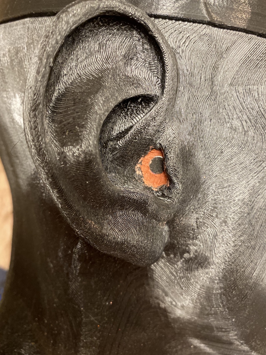

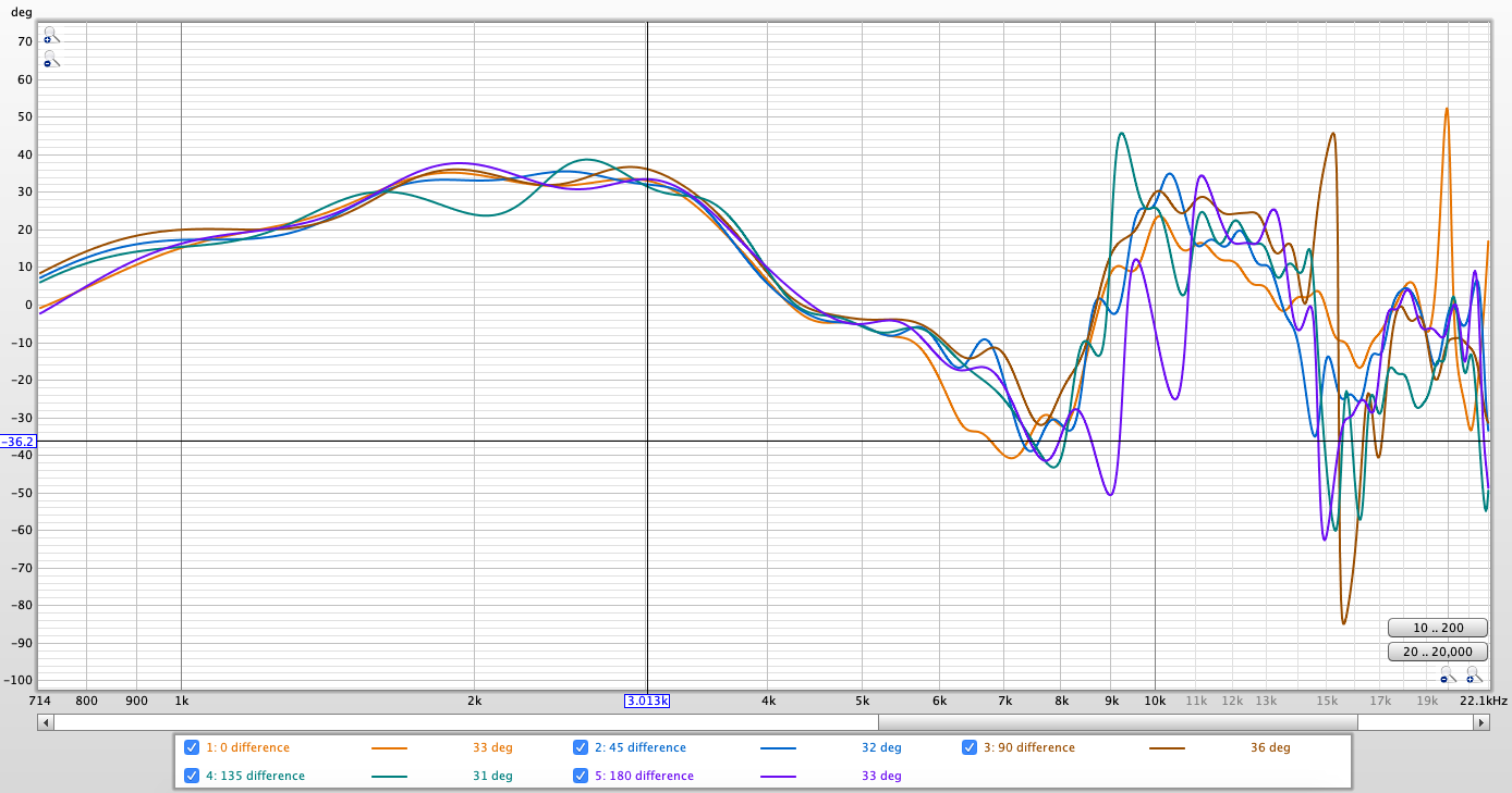

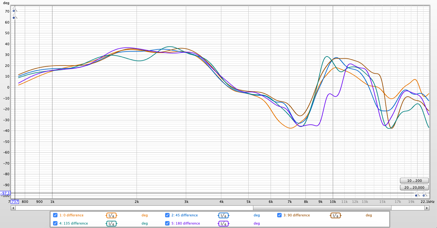

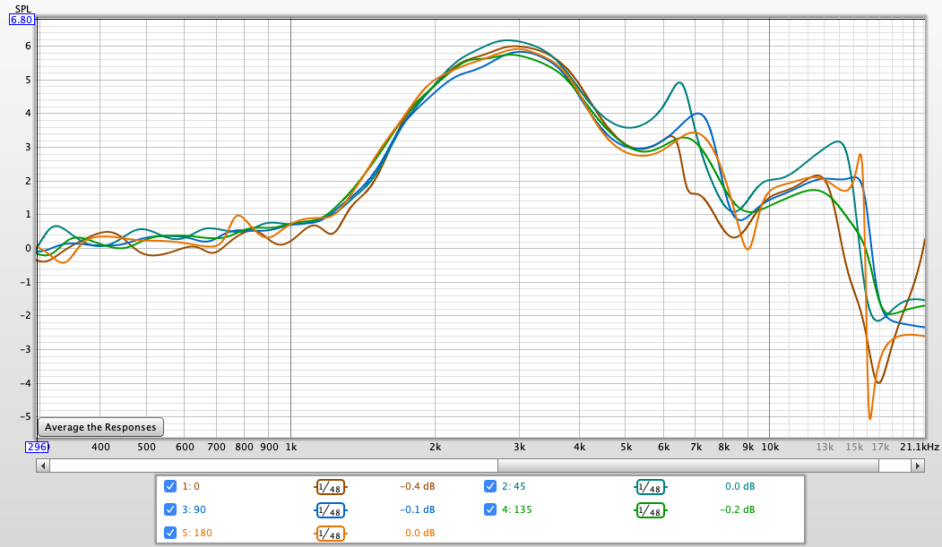

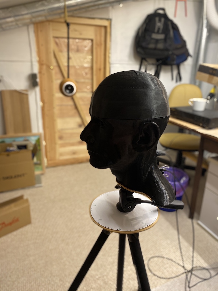

Here are some measurements. Pictures with first reflections gated out after 1.4ms.Anyway i don't need low frequencies.So i could do test at my small workshop. Two unsmoothed and two 1/6 oct smoothed. Did special loudspeaker for testing.Small with little diffraction,reflections ,close to point source.
These graphs show ear canal transfer function for five angles. Zero angle is frontal face direction.Transfer function is from blocked ear canal to eardrum. If ear canal transfer function is angle independent then all five curves should be identical. In my test they are not. But it is not wildly bad also.
Test is reliable because there is no human ear involved with inserted probes. The capsule used the same for blocked canal and ear drum. And the head location was precise for all measurement to 1mm i guess, because it was on the same rig on the same bolts, after capsule move from blocked ear canal to ear drum. Repeated measurements are identical. No noise pollution. Math for transfer function calculation is done in REW. Had to check that math with Angelo Farina's invers filters from aurora plugins, which i know for a while and i am confident with that. Checking every step is important because errors are done very easily.

Thanks for sharing. Very nice work! I like that single driver speaker on the back, too. 🙂
I think your results are in line with what the paper shows. It's the paper's interpretation of the results that I don't agree with. There is a clear 3 dB difference depending on direction imposed by the ear canal vs closed canal measurement in the 2-3 kHz region, and an even bigger one in the 6-7 kHz region.
This is clear proof to me that ear canals are necessary for accurate HRTF capture. I guess the new ear designs by GRAS and B&K are a consequence of this fact.

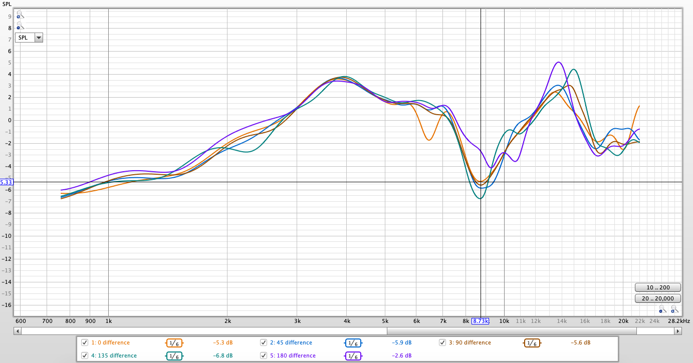

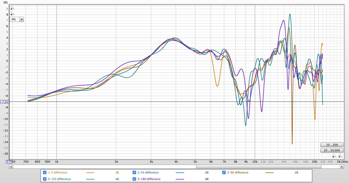

Unfortunately i have found a problem in the ear canal measurements posted before. Still not sure why and how it happened. The plots looked like normal compared to the plots in scientific papers, but just saw that below 2.5khz the difference signal is going below 0 dB. Theoretically
thats just nonsense. And the difference should diverge to 0 dB. And so i started to look why is that. I had no 100% answer, so had to repeat the measurements.
Now i have what it looks like true data. But after i have got it i just looked to the papers once more and i see that transfer function differs from that on papers.
And that should be like this, because i measured transfer function from closed ear canal to the ear drum. Papers show measurements which are from open ear canal on real humans to ear drum. This changes everything a lot. Basically HRTF to ear drum adds about up to 20dB boost around 2-3khz. If the measurements is done with open ear canal so the pinna adds about 10dB and ear canal ads about 10db. Closing ear canal makes about 15dB for pinna and about 5db for ear canal boost. Papers corresponds to what i have measured just takes time to study them carefully.
Anyway theory is in pair with practise. And what we see from the updated picture? Probably ear canal still is something direction dependant as 2-3dB variation can be seen. Not so much.But could be more, because the frequency dependant gating done in my test is with 5 cycles resolution(due to avoid reflections), which smears things. So i still think ear canal is important. The good side of these measurements that they are very stable and no variation and errors due to probe insertion into real humans. So valid to higher frequencies.
And also very important for the additional gain in most sensitive region about 5-6dB. Which will lower effective noise floor of the capsule about the same amount, because this region is dominating in noise contribution.
I don't know if it is true, but looks like it also helps in the wind when the capsule is deep inside and not exposed to the wind directly. But that it is just speculation from listening experience not from measured data. Maybe velocity of the wind converts into pressure more effectively when capsule is exposed to outside.
