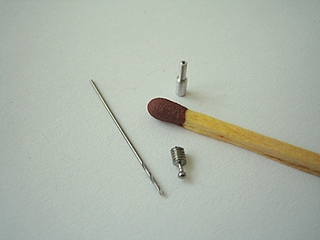

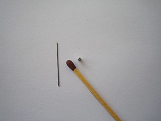

The little part shown here has 2 o/d's - 1.8mm and 0.5mm. Right through, I drill a hole of 0,3mm and at the thicker section at the back, another hole of 1.5mm.

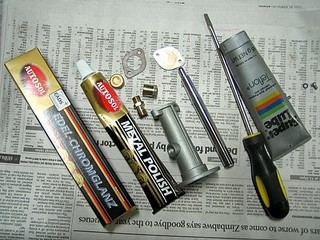

I also show a Garrard 301 grease bearing's bearing shaft and other parts. The metal polish was not used on the chucked and turning shaft, only on a lintfree cloth and done by hand to avoid ovality or other problems.

that little shaft is quite amazing - real precision watchmaking stuff. Can you tell more about how you made it?

That little tube is turned and drilled on the Myford from apiece of aluminium roundbar. There were many false trails when I started making them eg high speed @ 20K rpm needed for drilling with a .3mm drillbit and of course the tool I bought was hopelessly inaccurate, so - it was back to see what the Myford could do.

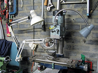

Don't laugh, but here is the little mill. I've recently also fitted an articulated truck mirror so I can see the inside of the nearside vice jaw. The lathe lamp also swings over towards the mill so the job is lit from both sides.

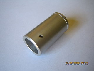

And a spacer bush so I could use my other Micro MA505 arm interchangably with a Grace G-727 Gyro Master. There are two locking grubscrews for firm fixing and adjustment up or down.
