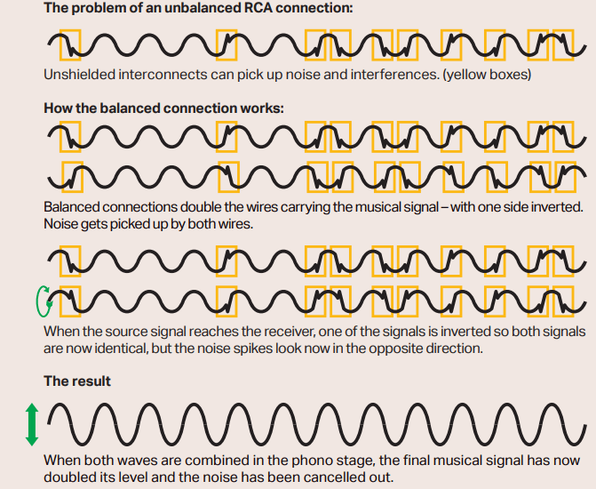

Hi, So my info about obtaining more gain from a balanced MC output, came from this paper from Project (see Photo)
Is that correct or not.
The AlliExress Balance summing circuit, is going to be use as a trial only. If everything works, then I intend to find a quality circuit.
