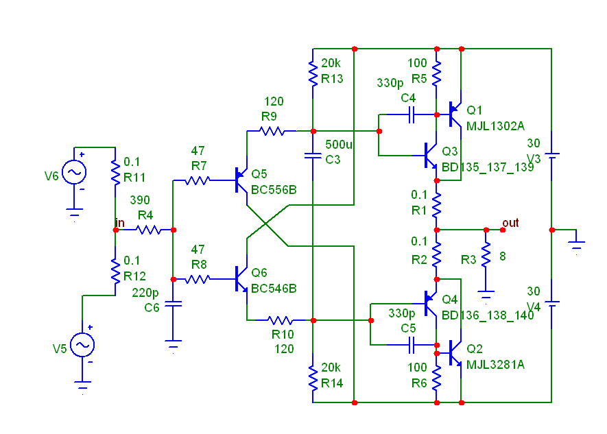

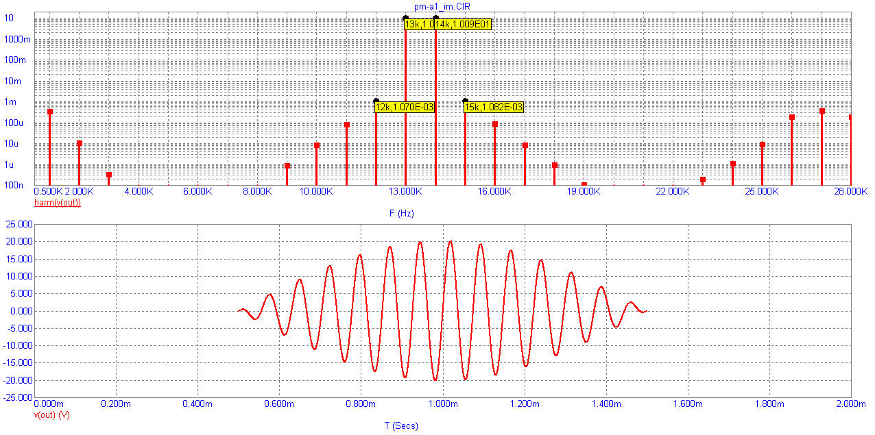

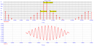

Wahab, I hope there is no problem if I add a simulation result of the PM-A1:
Hi , Pavel
No problem, to the contrary, this allow useful comparisons
of simulators.
Is your PM-A1 the amp described in this thread?
http://www.diyaudio.com/forums/solid-state/155628-solid-solid-state-power-amplifier.html
That s the one i did simulate in the IMD comparisons,
though i branded it PMA2...
At 19+20K, the lateral signals (F1-1 ,F2+1), at 200uV each
are 100db under the 20V peak level, which seems better than
in your 13+14K sim tests ..
Perhaps a device difference?.
I used 2SA1837/2SC4793 driving two pairs of 2SA1943/2SC5200,
the other devices being the ones on the schematic..

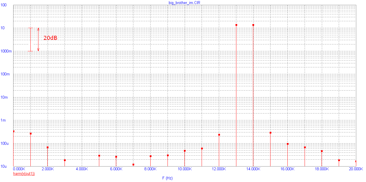

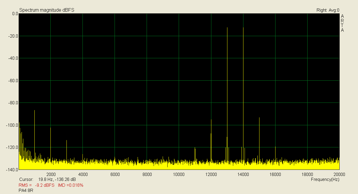

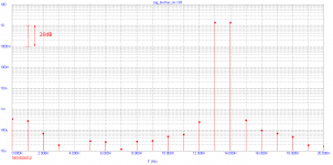

Now I would like to show the difference between simulation and measurement on the real amplifier. The amplifier is PA4 (http://www.diyaudio.com/forums/solid-state/155628-solid-solid-state-power-amplifier.html with 4 pairs of output devices, 150W/8ohm). The CCIF IMD test is 13+14kHz into 8 ohm load. Output amplitude is 56Vpeak-peak. Both plots cover same range 140dB. We can see that real amplifier has higher distortion by low order harmonics, BUT, the HF distortion seen in simulation is absent in the real amplifier. Also, We reach the noise limit. Should be said that most of simulated IMD products are deeply burried in noise. The 50Hz multiples in the real measurement are a result of ground loop by loop-back measurement.
Power transistor usual simulator models do not fit very well to reality. E.g., they do not describe minority charge carrier issues, thus do not give picture of cross-conduction etc. Cross-conduction can occur even in a class-A amplifier.

No, the amp you speak about is PA2.
PM-A1 is attached now. It is a low output power class A power buffer.
