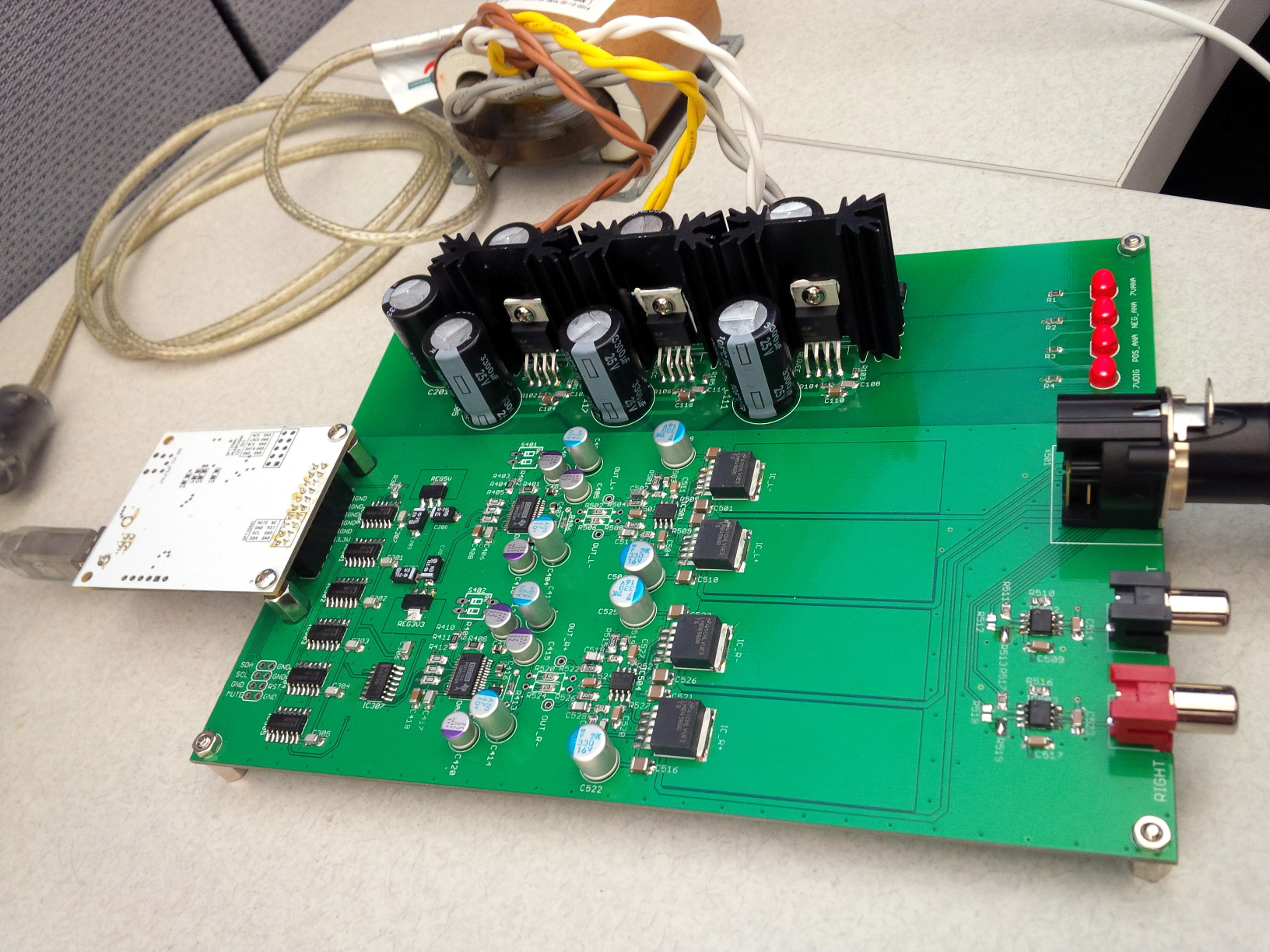

I wasn't there long enough and only Dave got a chance to listen to my DAC.
The white board is an isolated USB-I2S converter from DIYINHK. The pin header is compatible with the XMOS one they sell as well.
The digital section converts from I2S to right-justified and delays the right channel data so it aligns with the left (otherwise it would just be a dual left channel DAC). This section runs on 5V instead of 3.3V because the DAC ICs accept 5V inputs and the digital chips switch faster on higher voltages. The last chip in the group is a D type flip-flop to reclock the data.
I upsample 44.1khz and 48khz music to 176khz and 192khz respectively using SOX2 in Foobar with no anti-aliasing filter. The DACs have oversampling and thus the digital filter disabled.
The current reference is a JFET CCS instead of a simple resistor. The I/V is passive, followed by a differential analogue low pass with an F-3 of around 35khz. Embedded in the feedback loop of the filters are buffers, so it will drive headphones directly via the XLR. From DAC IC to headphones it's DC coupled differential.

Beautiful DAC, Tyler. I hope I get another chance to listen to it, on a high end set up, when I am fresh and rested.

Yes, I did get to hear Tyler's DAC. Tyler, thanks for describing its design, I really enjoyed your short presentation. Listening to it on excellent headphones I was unfamiliar with, it was very neutral and clean, the kind of sound I like. Please bring it to the next get together, this deserves a much broader audience! It would be really interesting to hear it over speakers into a balanced pre-amp as well.

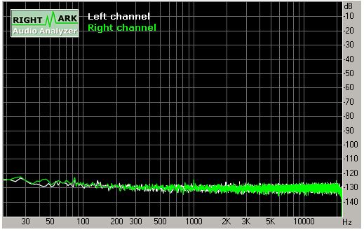

Well the scope at work doesn't have the dynamic range to measure past -80dB. Everything I measured on the DAC measures better than -80dB, but that's not saying much.
Hi Tyler,
Depending on your sound card, you might be bale to get down to -110 or so, using some freeware analyzers out there meant for the PC. I atttached a noise loopback of my ESI Julia for example (great sounding card too), using RightMark Audio Analyzer.

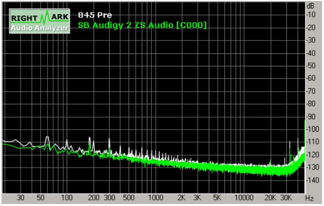

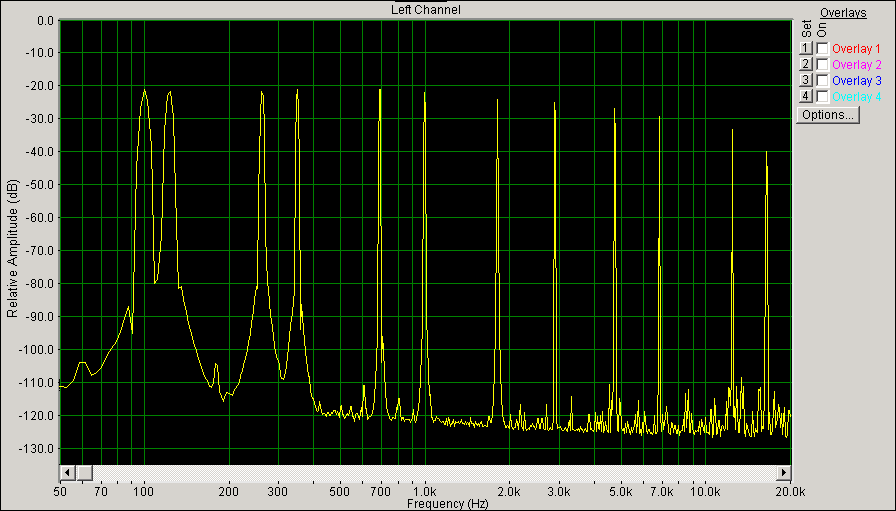

I designed an active op-amp based pre-amp a number of years ago, and attached is the measurement I was able to get off it with a 12Phi tone IM signal I created, using a different PC-based analyzer (better than using RightMark Audio Analyzer) and an old Audigy card.

What's the program you used in the image on the right?

It's SpectraLab. I've had it for about 10 years and run it on an old Win2k machine that has a very accurate sound card. I don't know what the latest version is or if its supported on modern Windows systems.
