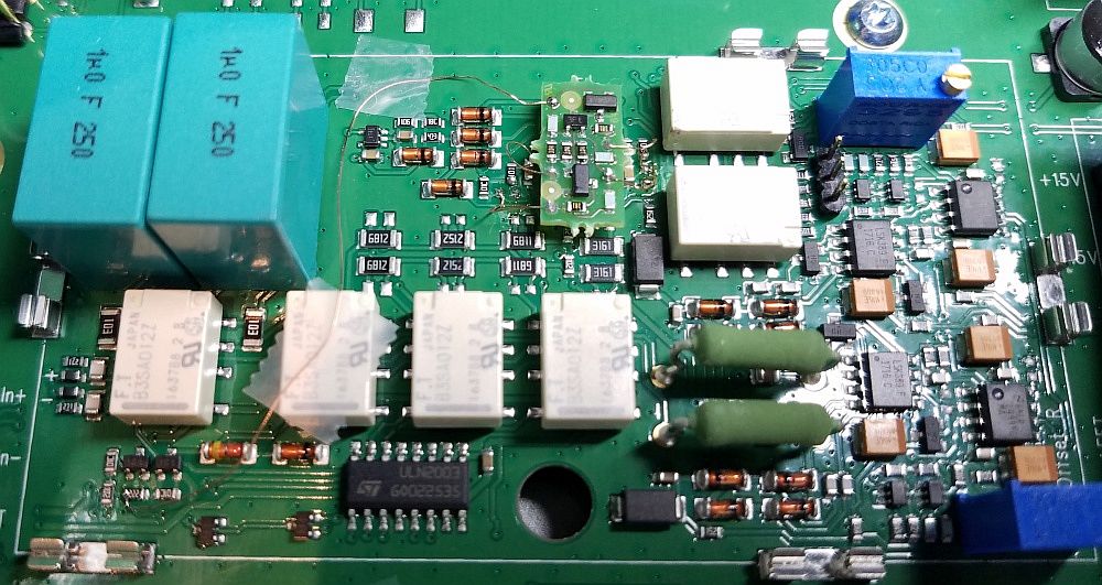

@ JensH: On one of the pics of nyt (attached cropped) there are white lines, on the pcb, forming a cuboid and some ground (?) clips along these. Are these lines show the traces of a provisional of some kind of metal shield over the inputs circuitry which are not included in GB units?

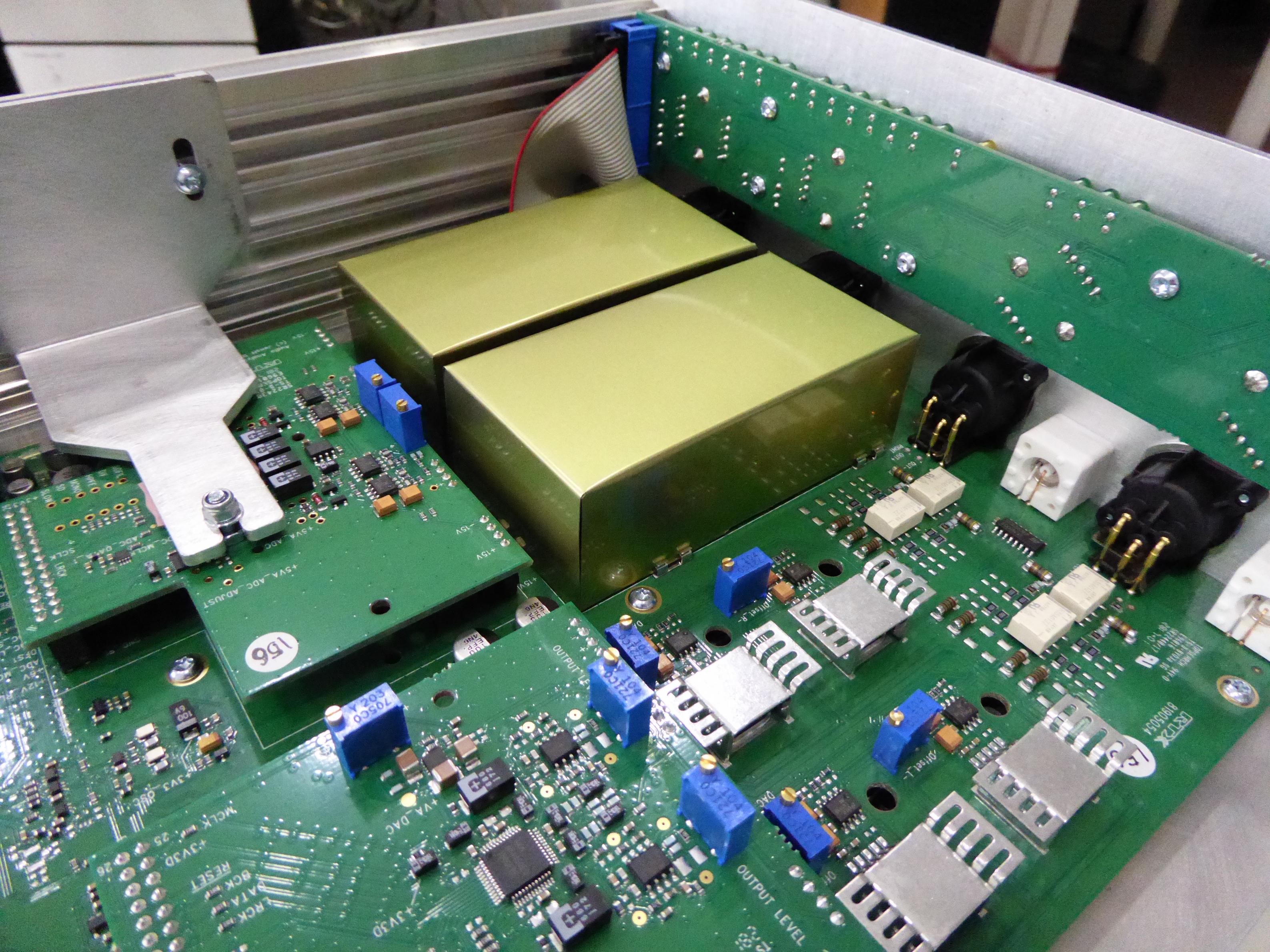

They are for input stage shielding. I've tried to install two SPTE shielding boxes, but the crosstalk is not reduced, which confirms what Jens has said. In addition, the crosstalk level does not change by switching to different input gains/attenuations. Therefore I think that it might be the crosstalk inside the ADC. Since these shields make no difference, I've removed them from my unit.
However, the measurements are usually done with single channel. Therefore I guess crosstalks should not be an issue for most cases.

@Ghianni
Yes, the clips were included to have the option of mounting shields over the input stages.
As described earlier, it was decided not to mount any shields.

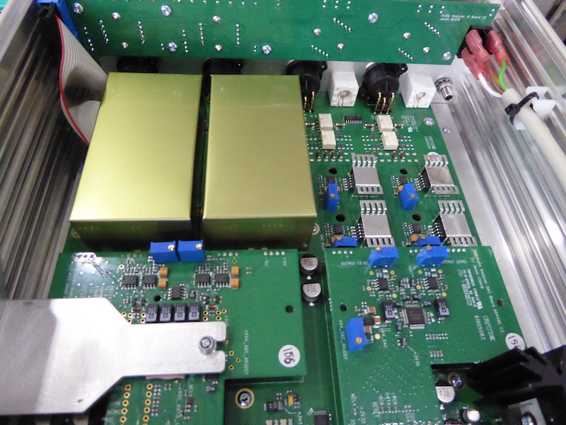

@PaulBC
Very nice shields you have made!
As someone pointed out earlier, there is some crosstalk, primarily from the right generator output to the left input, due to the proximity. The shields will reduce this crosstalk. The ADC will cause some crosstalk between the input channels, which the shields will not change.
Some components in the input stages become relatively hot, so closed shields like the ones you have made are not recommended and will void the warranty.
