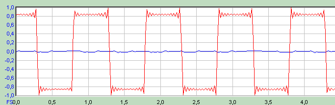

The peak detection is based on detecting signal levels close to 100%, not necessarily 100% because in some situations you won't reach 100% values, even if you have a strong signal. I plan to make the detection window slightly wider in the next FW release to improve the peak detection.
You should not use the peak detection threshold as a reference.

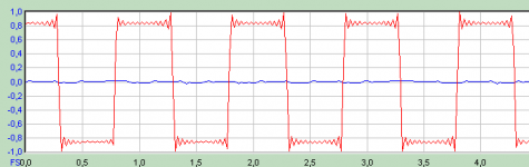

I have just checked with signals similar to the ones you used. With triangle and sine wave the detection threshold was close to 3 Vpeak as expected. With a square wave the peak-peak value of the square wave was lower. There are two explanations for that (in my case):
1. The generator has some overshoot. The generator I used is not particularly good.
2. The filter of the ADC generates ringing, which will be detected as overflow. See the attached picture.
The overflow detection is not done by the ADC (the AK5394A does not have this feature). It is done by the XMOS processor used for the USB interface. It is based on peak values, not an RMS calculation.

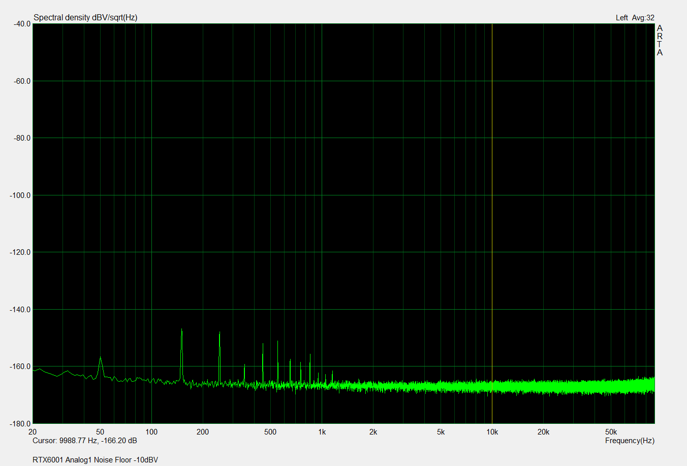

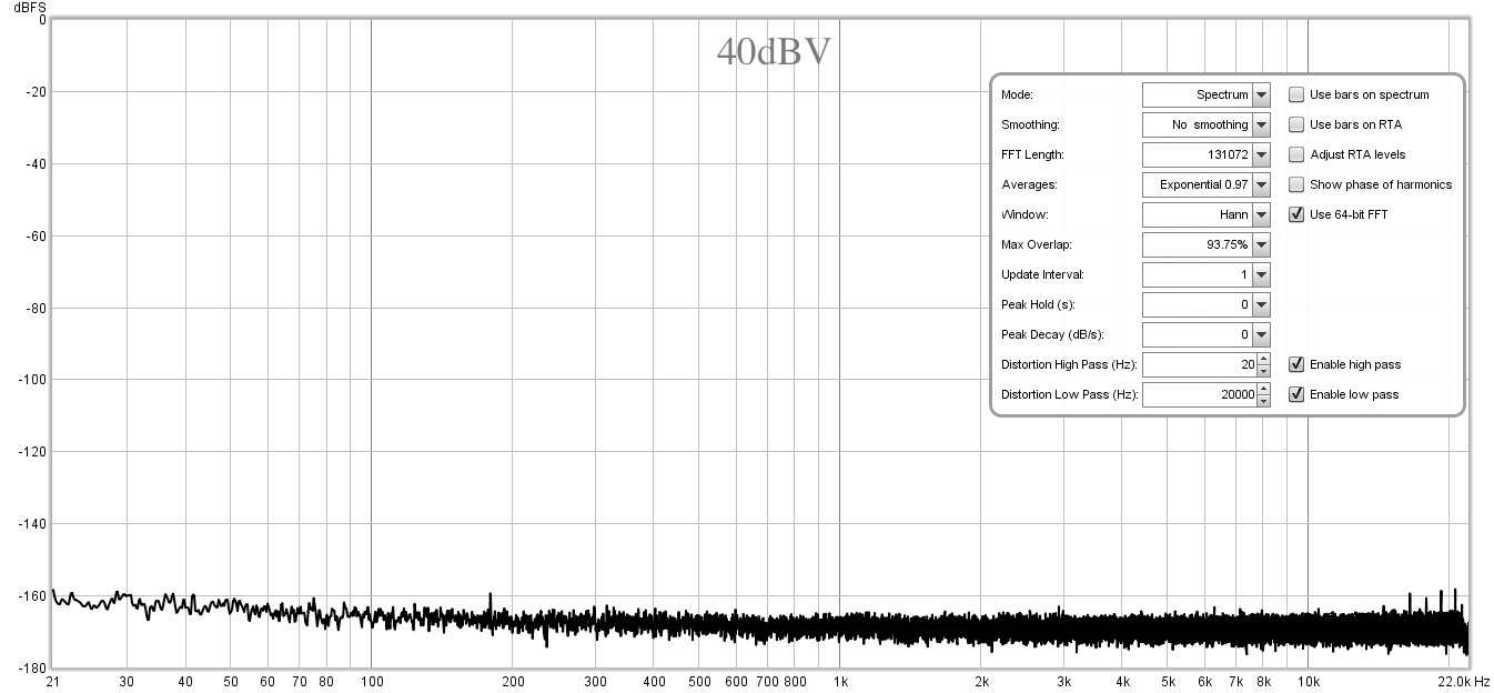

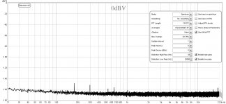

I got my RTX6001 about a week ago. The performance is very impressive indeed. The noise floor is extremely low, down to -170dBFS.
However, with 0dBV, -10dBV, and -20dBV input, there are some spikes (the input is shorted). They look like harmonics of 60Hz, but the amplitude of 60Hz is much lower.
Is there anyone having similar issues?
I see precisely the same phenomenon on my unit. Perhaps it is an intermodulation by-product coupled in from the power supply. -145 dB is an exceedingly low signal; In that domain, everything is susceptable to noise.

If you really look for it, some discrete frequencies will show up above the noise floor. The level you have measured seems to be around 50 nV.
These harmonics of the AC supply can be seen on all units, but they are at a level, which shouldn't be a real problem. Most of it seems to come from the power transformer, which does emit some magenetic fields at the harmonics of the 50/60 Hz supply, despite the fact that it is a ring-core transformer.

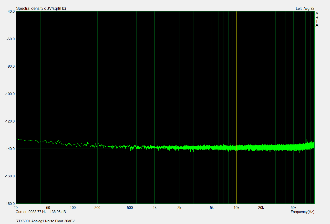

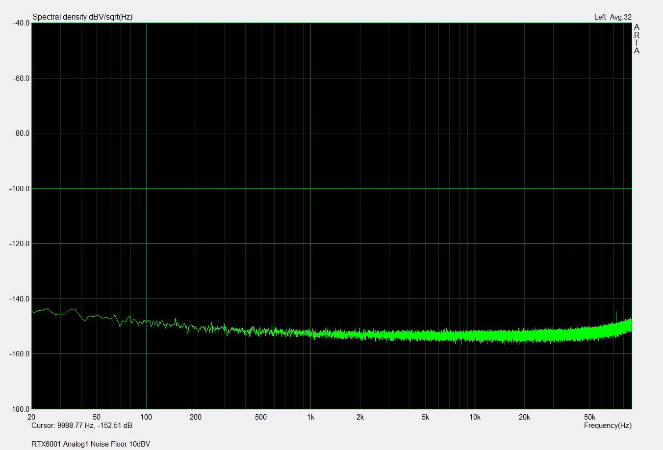

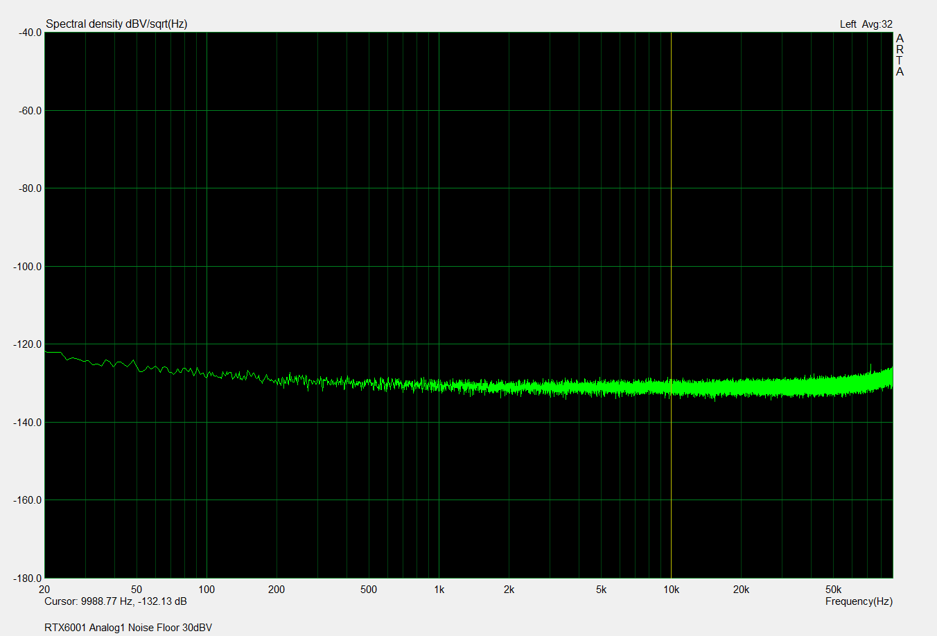

I have similar mains harmonics in my unit also, at around -145dBV/rtHz.
The noise floor is around -168dBV/rtHz (4nV/rtHz) at -20dBV setting, rises to -166dBV/rtHz (5nV/rtHz) at -10dBV setting, both meeting the noise floor spec in the user manual (5nV/rtHz). At 10dBV, the noise floor becomes high enough to hide the mains harmonics, and increases to around -132dBV/rtHz at -30dBV.

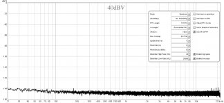

ARTA does not allow calibration at 40dBV setting so no measurement for that level.
Jim and Jens, thanks a lot for the reply.
You are right, the levels of these harmonics are very low, and should not be a real problem. However I still want to try if these can be reduced by installing a cover/shield for the transformer.
