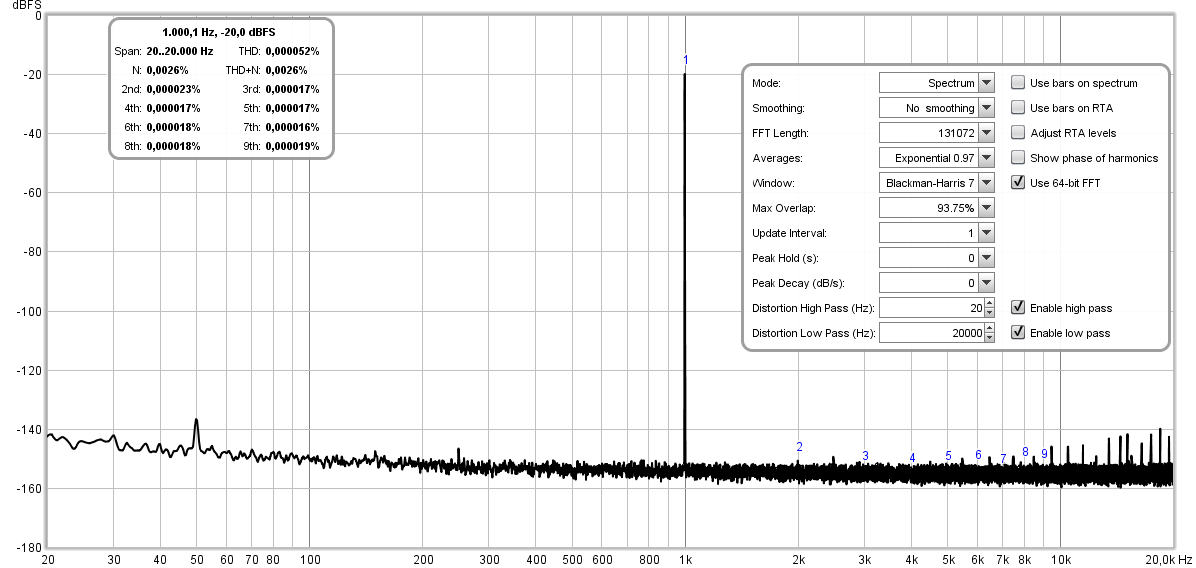

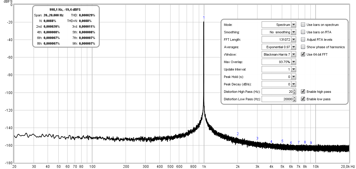

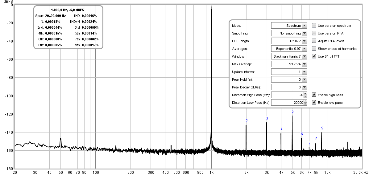

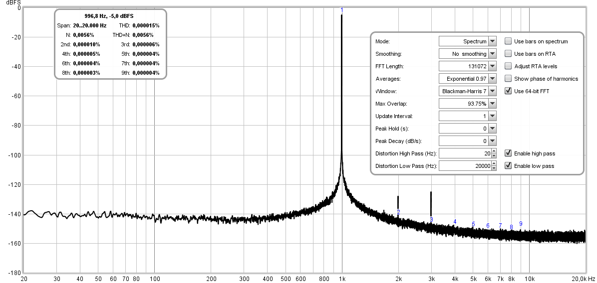

Balanced Victors vs. RTX generator
Just a fast comparison between the RTX6001 (loop-back) and a battery powered Victors generator in balanced configuration.
RTX input at 10 dBV for both measurements.
RTX output at 10 dBV.
Victors output at lowest power.
