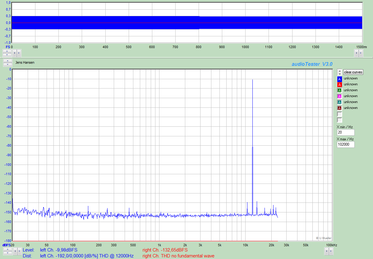

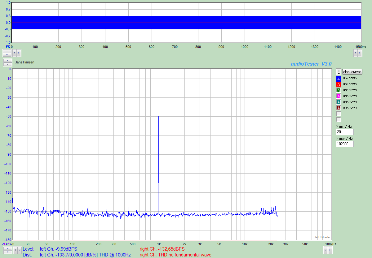

I just made a couple of measurements, using two analyzers, one as generator and one as analyzer.
I measured the FFT with signals at 1 kHz and 12 kHz. I did not use a JTEST signal. I am not quite sure whether the JTEST signal makes sense in this case, since there is no clock regeneration.
The noise spikes at the high end of the frequency spectrum are generated by the DAC. They change depending on the input frequency and the level, but I don't think they are related to jitter. They are most likely a product of the delta-sigma process.
