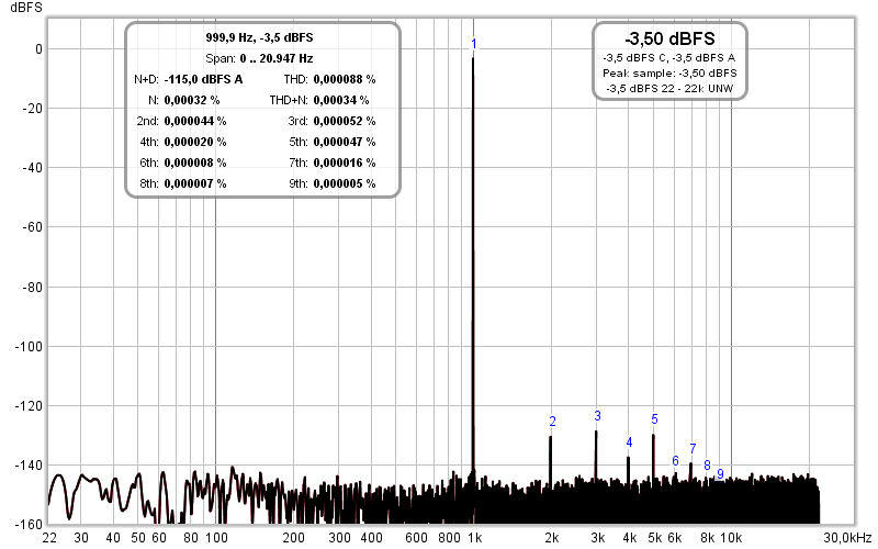

Finally, got one RTX :)(thank you Matthias).
Just quick loop test:
Simply, more than just have to be happy!
