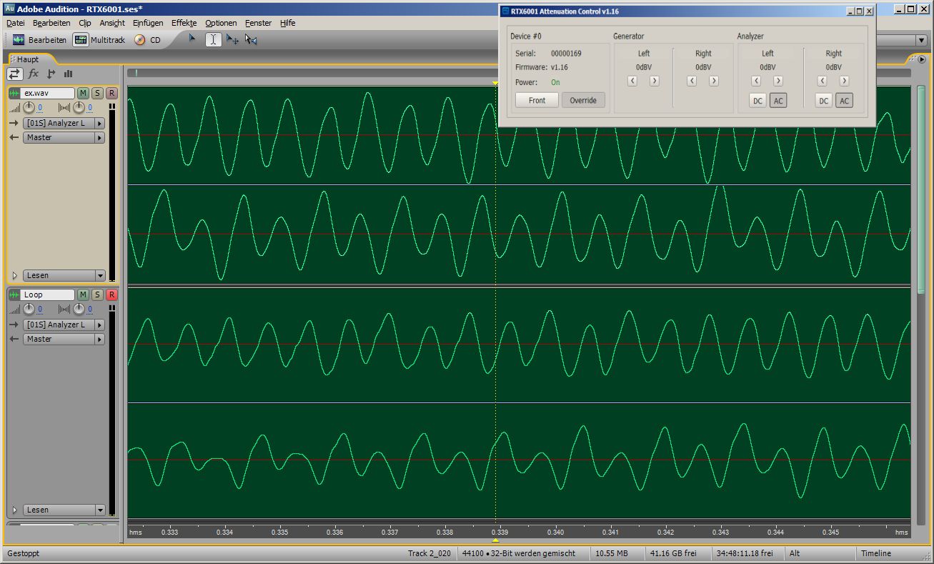

In my case, Audacity does show weird results using WindowsDS at Lynx L22 or RTX6001 (downloadable Audacity doesn't support ASIO).I did. It happens as well with Decibel as with Audacity.
Moreover it does not happen with an other DAC.
I don't see any issues with neither Lynx L22 nor RTX6001 (see attached result) - using ASIO in both cases.

Have you tried WASAPI?
I haven't, these recordings were made using MME as that was the default setting. I have both direct sound and wasapi options so will try wasapi after the next update.
I assume MME possibly resampled the audio to some other bit rate/bit depth than what I had set.

In reference to Jens Wasapi question I tried it yesterday and unfortunately in W10 with Audacity it doesn't work as expected. It always defaults to the system sample rate of 48kHz, but at least Audacity reports that. In direct streaming mode it reports the set sample rate but actually records in 16 bit 44kHz.
Several people who record frequently are telling me to ditch Audacity and either go to a real DAW that supports ASIO or ditch the PC altogether and go with a SD card recorder.
I'm going to experiment a bit further and am wondering if something like ASIO4ALL might be useful. Otherwise I will most likely go with a real DAW.
ditch Audacity, I used to recommend it all the time, but it has too many problems, mostly setup and usage ones like you are seeing. You could try Reaper, but it has its own set of oddities. 99% of the time I use Wavelab, but that is not a low cost approach, but having used it for decades, the upgrade cost is reasonable.

On Windows 10 I usually go through and manually change all the sample rates to match. it usually works. I know other's have complained that Audacity limits to 16 bits and the sample rate stuff is a mess. I have used audacity to edit 24 bit files successfully. I'll try to record a 24 bit file using XP and Win 10 now that my RTX is back together. However i'll use an external generator into an SPDIF connection to check it.
I was able to successfully record at any resolution I choose within the capability of the RTX and it worked well.
