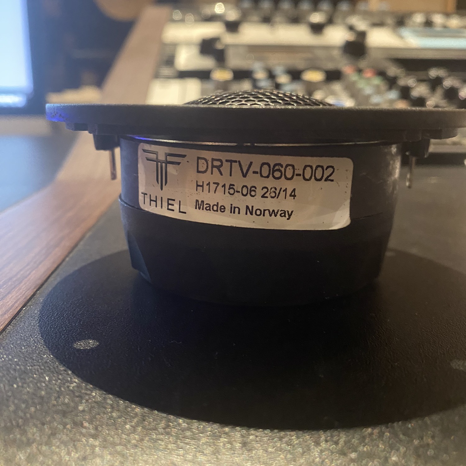

I’m new with diy speaker build. Hopefully I can get more knowledge from experts here
So I’m planning to build a 3 way speaker ATC SCM50
Mainly use for mastering studio / listening

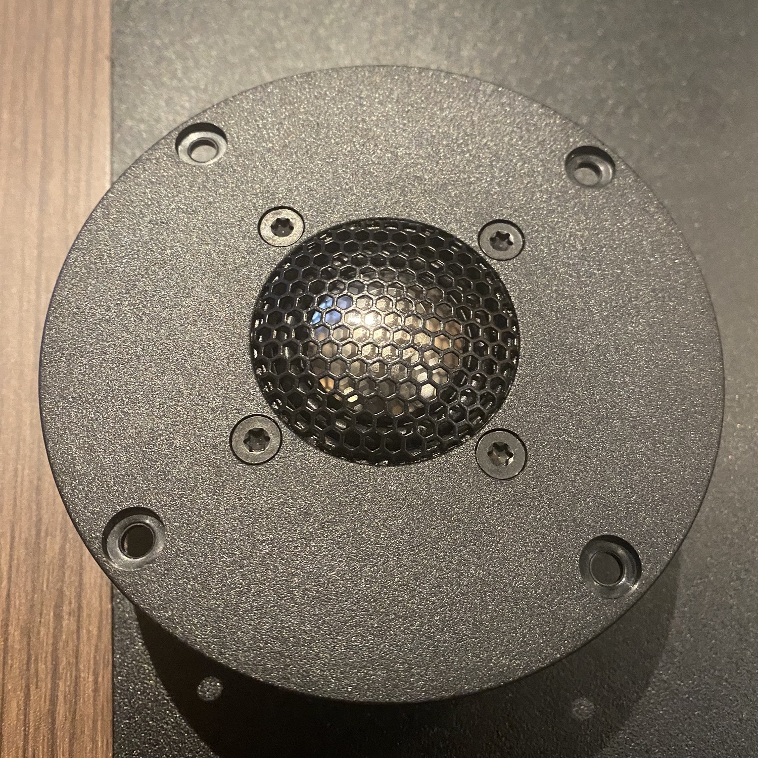

I already have THIEL TM3 1” tweeter (titanium dome?) it’s made by SEAS
Now I’m planing to buy
Mid - Satori MD60N-6ohm 2.5”
Low - Satori WO24P-8ohm 9.5”
Are these good combination ?
Now for the crossover, from what I found, Active is cleaner and more phase allign ? Any good recommendation to start for Active ?

Hi, just some opinions and thoughts:
  • Seas 1" metal domes are serious and very nice drivers!
  • Never heard or used the MD60N, as I think they are somehow misconcepted. Quite large dome diameter, but excessive distortion <1kHz according to pubished measurements, so they cannot be used much lower, only as filler drivers. Therefore it has a very large flange diameter that prevents tighter driver spacing. I don't like them, SB Acoustics has left quite some opportunities behind with these drivers, I think.
  • I have used WO24P-4 myself in a classic three way as well as other SB drivers. They all have a bit weakness in the fundamentals, give them at least a bucking magnet to strenghten the magnetic circuit, then they can play pretty nice.
  • Active gives you many advantages and flexibility, I use very satisfied some Hypex plate amps with DSP.
But for a "main monitor" the driver selection appears to me really underdimensioned.
These may be a very nice passive speaker for that kind of application, very close to ATC speakers and already seriously developed: https://www.diyaudio.com/community/threads/open-source-monkey-box.327594/
If someone would ask me to develop a classic 3-way monkey coffin with low distortion and really high dynamic headroom for "main monitor" application I personally would choose
vented 50~70l, xover @ ~ 380Hz / 2,5kHz LR4
Best Regards
Peter

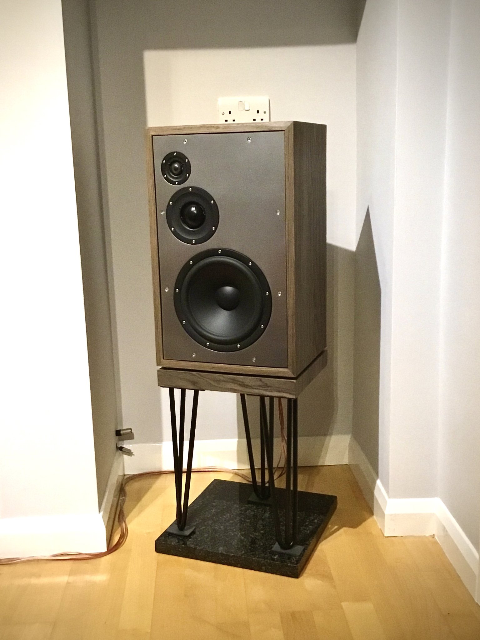

ATC quotes the diameter of the cone/dome, not the chassis diameter.
the SCM50 is a 3 way with the ATC mid-dome, a 1” soft dome tweeter and despite the 234mm/9” woofer spec, that is the diameter of the woofer cone.
The Satori WO24P is a smaller woofer than that used in the SCM50.
So Unless you can get the original ATC woofer, if you are looking for a close replacement,
a minimum of a ‘10” woofer’ is required to meet the 234mm emissive diameter.

The ATC speakers were the inspiration for my build. WO24P-4 in repurposed Akai SW125 cabinets approx 40Litres Sealed, Morel EM1308 mid dome (39uF protection cap) and Morel ET448 tweeter (12uF protection cap). These are run from a Minidsp Nanodigi with 4xKhada Toneboard dacs and powered by an Rotel RMB1066 6 channel amp and have managed to get a fairly flat response on axis with decent phase coherence. To my uneducated ears they sound good and after several different crossovers I found that getting phase coherence was the key to a large sound stage.
I listen mainly to Metal music and the sealed woofer suits that very well as there is not much very deep bass (sub 40hz) but does need a woofer and alignment that can start and stop the cone quickly. 40Litres with the WO24P-4 give a Q of around 0.7 and I have filled fairly well. As said the WO24P are more alike a large 8” woofer with an SD of 255sq.cm but have a 9.5” outer diameter.
I will eventually rebuild the cabinets more substantially and may modify the mid/tweeter position, may even look at a bass bin for the WO24P plus an open baffle mid/tweeter stand on top so I can play with physical alignment.
