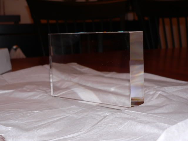

That picture of the wedges themselves looks a bit odd, like the faces aren't truly rectangular. Is that the case? Does that affect the thickness of the prism from top to bottom?
Yes, they do taper from 140mm at the thick end down to 130mm at the thin end.
I was actually a little put off by that myself because if if your prisms rotate, so does the image. But as it turns out, the offest of one is cancelled out by the offset of the other, so it is all good...

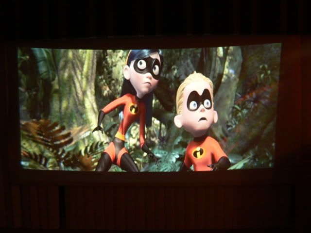

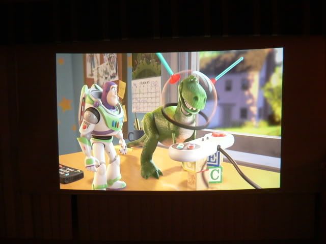

I set up my projector on the table in front of my screen, and set the prisms on the table in front (actually, set up a little, since my projector has such a steep vertical rise on the image emanating from the projector lens.

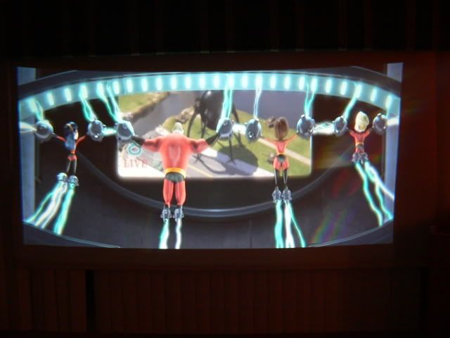

I found that I got some serious geometry issues with the lenses, that are a bit disappointing. Pincushioning? This image uses the anamorphic stretch:
But I was able to test the proof of concept with the 235 aspect ratio. This image uses the anamorphic stretch and the projector's scaler to eliminate the black bars on the 2.35:1 ratio Incredibles.
While the geometric distortions were more serious, I also noticed a reflection problem on the image, as can be seen on this picture:

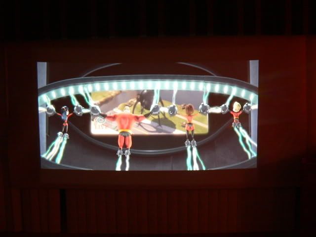

Here is the same picture, but with only the anamorphic squeeze, and the lenses dialed in for 16:9 (therefore, black bars, and the lack of the entire panel used...)
I also found that I could probably get away with using just two of the smaller 4x6 wedges. The image shining through the second wedge doesn't go larger than about 3x5. However, I may lose the ability to dial in 2.35:1.
Not sure where to go from here. My plan was to use this for our outdoor movie nights, where the projector sits about 30 feet from the screen. I don't suppose that will necessary help the image--it just makes the distortions larger, doesn't it? The throw on the projector is a big cause of the distortions with the lens, so it shouldn't matter how far from the screen the projector sits, right?
I guess in general I was pretty pleased. Any suggestions on how to fix the distortions? Would doubling up the lenses help?

Speaking of prisms--I finally got them! They are really nice.
Yes they do look very good. Do they have the same taper that mine do?

I found that I got some serious geometry issues with the lenses, that are a bit disappointing. Pincushioning?It is looking more like the image is simply not centered, but then your shot with out the prism is straight. I did find (water prism days) that sometimes tilt was needed and if you look at posts of both Prismasonic's H600 and H1200, and Panamorph's UH50, and even my first posts of my own lens, you see that they too needed a little tilt.
This is actually one of the reasons I went over size. My water prisms were tall at 125mm, but these new crystal prisms are 140mm high (laying on their side of course) so I can raise and lower the projector to suit...
And the image (apart from that small rainbow and the shape) looks very good. It is extremely clear with deep solid blacks and it actually (color wise) looks better than with out the prisms, or is that just me...

Mark: No, there is no tapered edge. The faces of the wedges are exact rectangles.

One thing I should clarify on the prisms, from what I said above--I guess it is a misnomer to say that the beam must enter "normal" to the face of the prism--because that implies that the wedge is not rotated in any direction, but of course, to get the anamorphic effect, the prisms must be rotated from right to left.
So if the prism has a vertical axis and a horizontal axis, the beam must enter the prisms at a 90 degree angle to the vertical axis, while changing the angle the beam enters the prism relative to the horizontal axis gives you the squeeze ability. I am going to test this theory tonight with my projector, and see if I can correct the distortions.
sdspga said:
Ha! That's funny. It was me who ordered the small and large 🙂
She did mention they were for a golf course, which made me think they really were for awards--but, if memory serves me right, you work for a golf course, right?
Some great discussion going on here 🙂
Yes Steve,
Assuming just two axis (V and H), the prisms must at 90 degrees to the light in the vertical and will be on an angle to to the light in the horizontal.
As you rotated the prims horizontally, the optical effects of stretch and or squeeze wil be seen...
