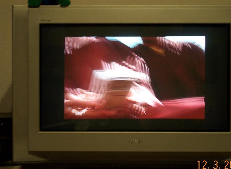

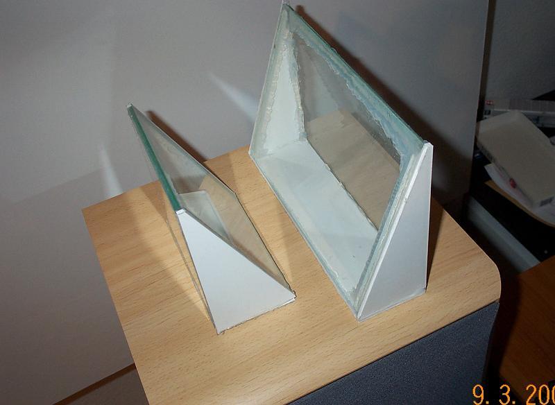

hi all,
first of all i've got to mention i am from germany so i apologize for my bad english at first...
i am originally in the diy projector forum, there arne posted a link to this forum so i saw this thread two weeks ago. I said man thats what i need: more light and more resolution. I posted some pics of my anamorphic lens...
I tried another version: both prismas filled with oil.
Glycerin it is called in German... works really good.
Sorry but i can't show you projected pics because my diy projector is not finished yet...
but i took a picture where i took the anamorph in front of the tv; you can see the effect there...
i used aquarium silicon for the inside of the prismas, you can see it on the photos...

try this:
both prisms filled with glycerin oil. you can get it in every drugstore. The angles and so on are discribed on jochen's heimkino site.
1.Prism: top down, top angle = 26°, rotation 25,6°, top away from lense
2.Prism: top up, top angle = 20,5°, rotation 26°, top away from lense
the glycerin won't attack the glue. additionally i filled the inside edges with silicon for aquariums. I have my two prism now for 5 days and still no oil is cumming out and it works great.
slize -- Please post your results with both prisms using oil/glycerine!!! Does it serve any big benefit that you can see by not using water? Did you change anythign else about the prisms using glycerine in both?
I had heard you had to have one with water and the other with oil to correct "chromatic abberation" (re-aligns the colors).
hi jude,
to see results please go on the previous page i posted pictures there.
you see the first picture: that is where i took a photo through my anamorph holding it in front of the tv. the same will happen with the projected images. the next picture is taken without the anamorph. Do you see the difference?
sorry that the anamorphed picture is not in a line. but it was hard to have the camera in one hand and the anamorph in the ohter and to take a picture. if you will fix it in front of your projector it will be fine.
The main advantage to water is that the glycerine oil won't get dirty. Just like in an aquarium the water will get dirty after a time.
And the terpentine oil attacks the glue and the silicon so the prism will loose water and oil after a time.
The glycerine oil doesn't and won't get dirty for a long long time...
To see results please go on the previous page, i posted pictures there. Above i also posted the angles you will need for booth prismas.
the color problem is not to solve through the water and terpentine oil prisma in general.
the fact is one prisma always splits up the colors. you will always need a second to fit them together.
it is not imptortant what's in the prismas but the angles of the prismas itself and to one another are important.
I already mentioned the angles of the prismas itself with glycerine oil above. And the angles to one another too.
But with the angles between the two prismas you can experiment it is different from projector to projector.
You can see on the first picture there is blue line on the arm. that is just because i didn't fix the prismas correct there about 1° or 2° to far...
If the angles are correct it will work very good. But i'll do that by the time my "do it yourself projector" is finished... then i will post projected anamorphed pictures...
