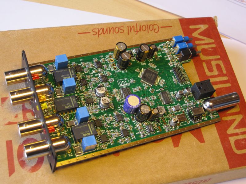

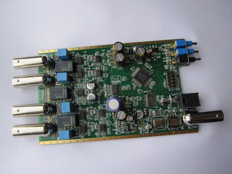

wiring finished.
The first board is just finished to wiring. Phew !
Now, need to take the time to test that 😛
It's the job i love 😀
Frex
Two picture of what it look like now.
Frex

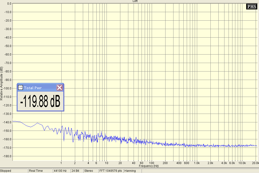

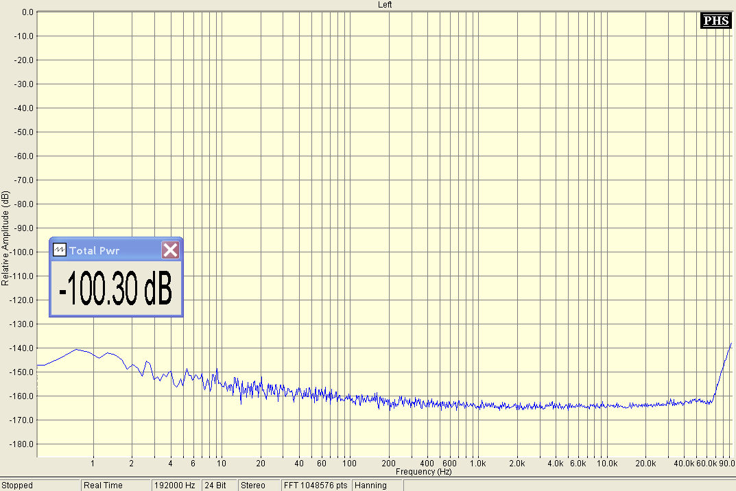

PCM4222 eval board - Noise floor, FFT window: Hanning !!!
Some words about your measurement setup ?
Gary
Gary
Thank for your answer ghg.
I start to make measurements with same setup of you.
I will post all detailed result this week end.

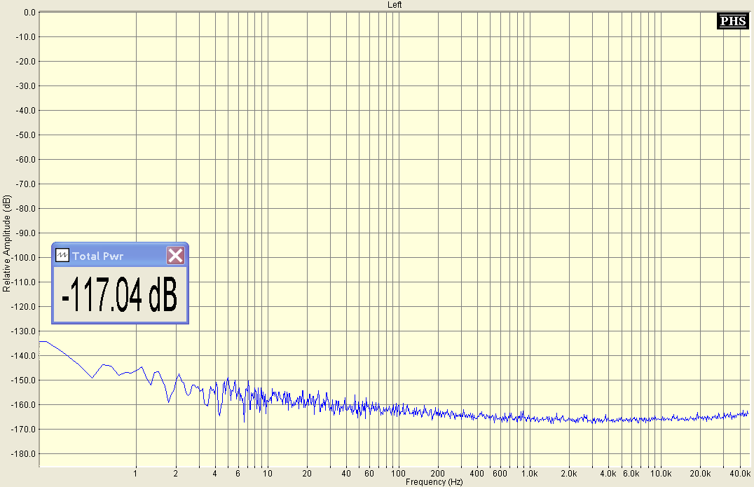

Here, the first result, the noise floor with 50 Ohms at each inputs, differential mode, DC coupling, HPF ON, FS=48kHz (the ADC don't allow 44.1kHz)
The ADC is powered with +/-15V JRS06 PSU from P.Sjöstrom.
Digital output used is coaxial, go to SPDIF input of ESI Juli@ sound-card, ext clock mode.
FFT analysis software :Spectralplus Demo with this setup :
Resulting spectrum is below.

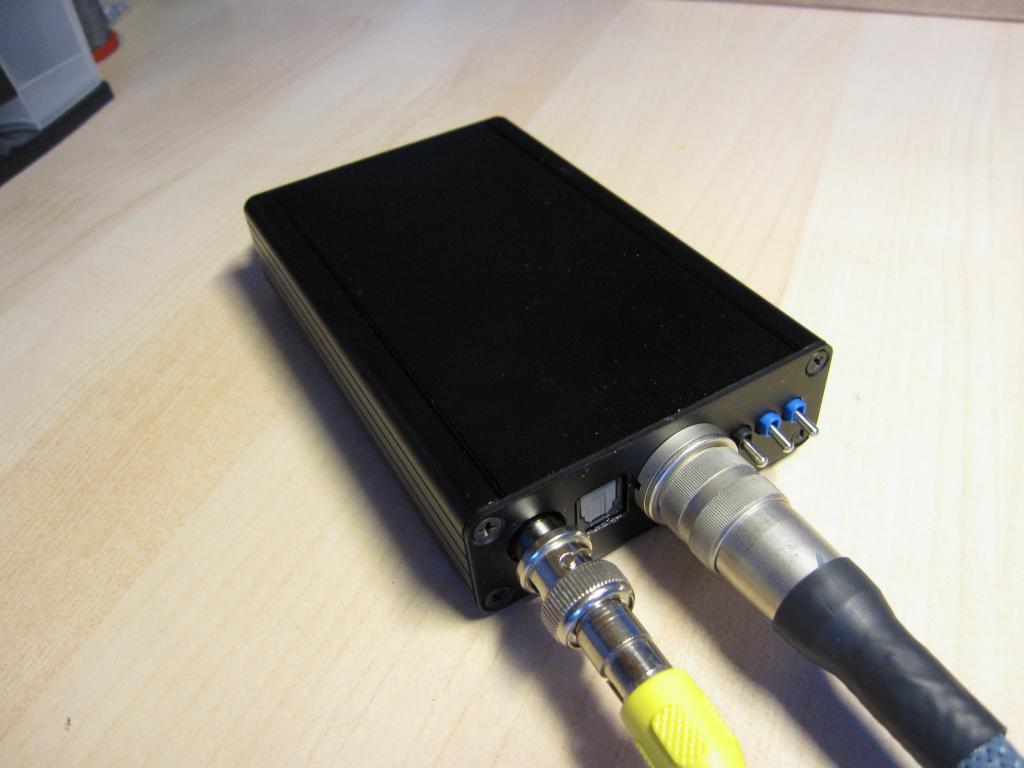

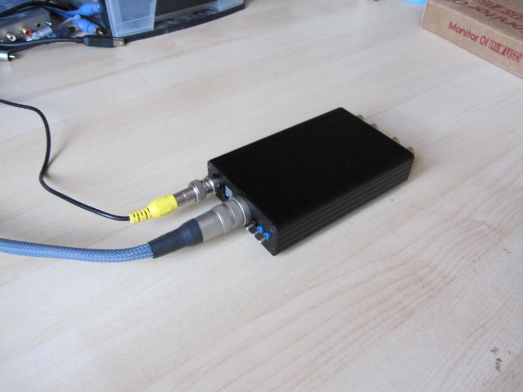

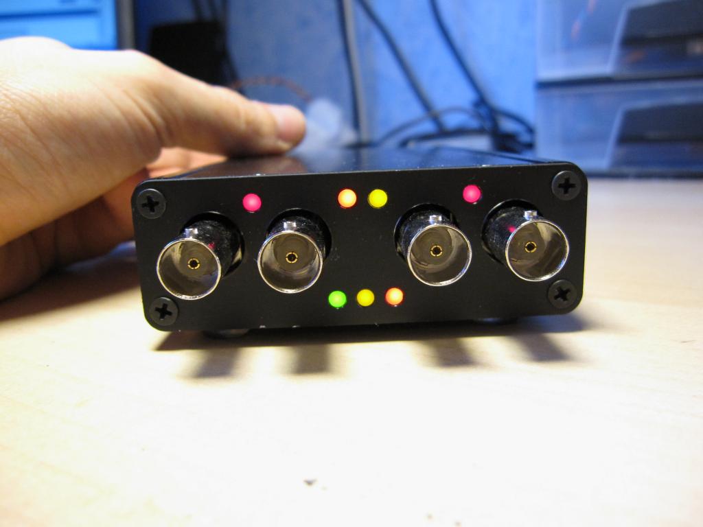

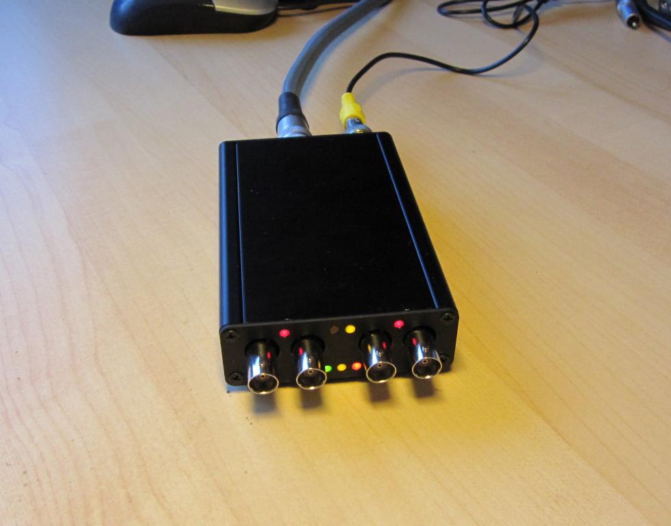

I post some pictures of the converter in it's box.
It's look fine 🙂
Frex.
- FFT resolution = 1Mpts
- Average=10 (exponential)
- Fs =48kHz
- 0dB of Spectrum is 0dBFS of ADC,
- corresponding to 7.07Vrms for full-scale at the input of ADC.
AA5381v1noisefloor48k

Hi
So, two 50 Ohm resistors per channel ( + & - to ground ) ?
Will do 48kHz tests to compare.
Gary
Gary

Hello,
Ghg, yes, i use a 50 Ohms cap on each inputs (in+ and in-).
The noise introduce by them is negligible.
At 48kHz, i reach nearly the spec of CS5381 giving 117dB of noise floor typical (111dB min).
The input buffer used allow to connect very high impedance source,
because the bias current of the buffer is very low.
It's very convenient for a universal measurement tool.
The disadvantage is that OPA134 have slightly higher voltage noise density (8nV/sqrtHz). This explain why the noise floor not reach exactly datasheet value.
In the PCM4222EVM, the input buffer is a OPA1632 fully differential amplifier.
It is a very low noise OPAMP (1.3nV/sqrtHz).
But, if you connect high-Z source, the noise will be much higher because the current noise dominate (In=1pA/sqrtHz) while OPA134 exhibit an extremely low current noise (0.003pA/sqrtHz).
A major problem also with this amplifier is the bias current (6µA max).
When connecting a source with impedance of 100kOhms, the created DC offset is 600mV ! In some applications it can be an issue.
Used this type of amplifier is justified only if the source impedance is always know and very low (less than about 1kOhms).
For the converter IC, it seem that the PCM4222 have performance a little better than CS5381.
When i had designed the ADC, i had need to make a choice .... :b
I just have receive the low jitter TentLab XO, i will mount it in place of the SMD XO. I will continue measurements this week-end.
Frex

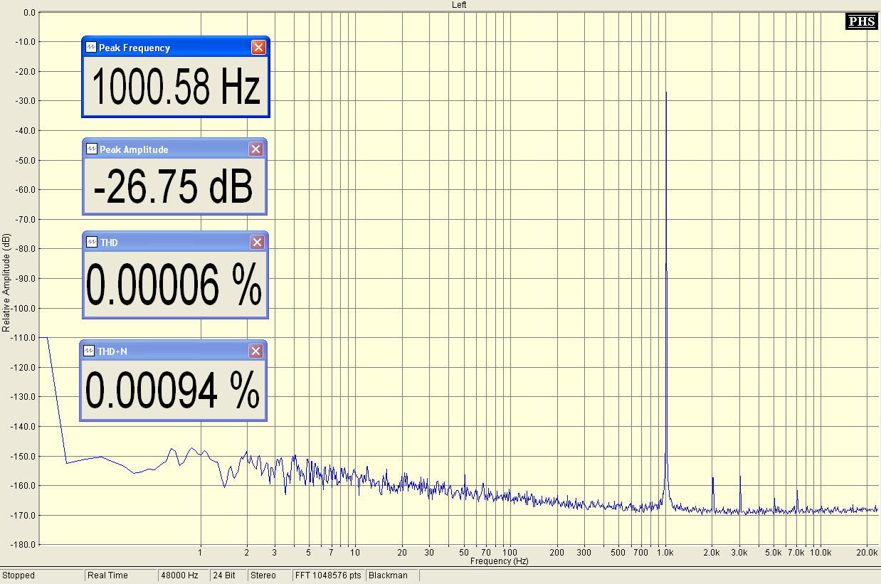

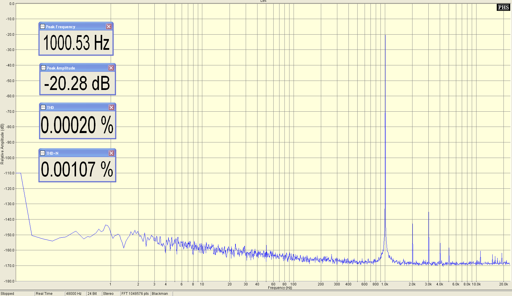

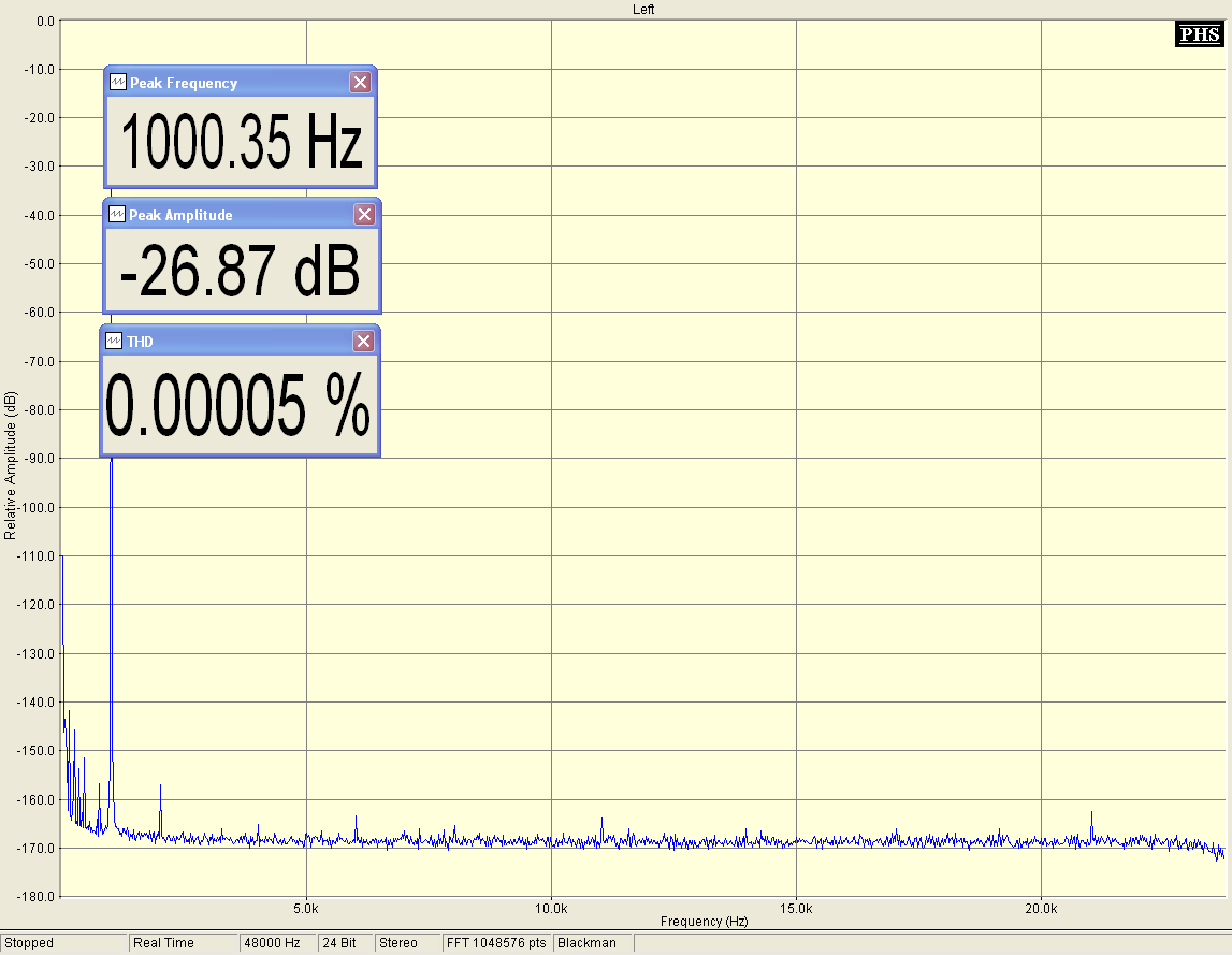

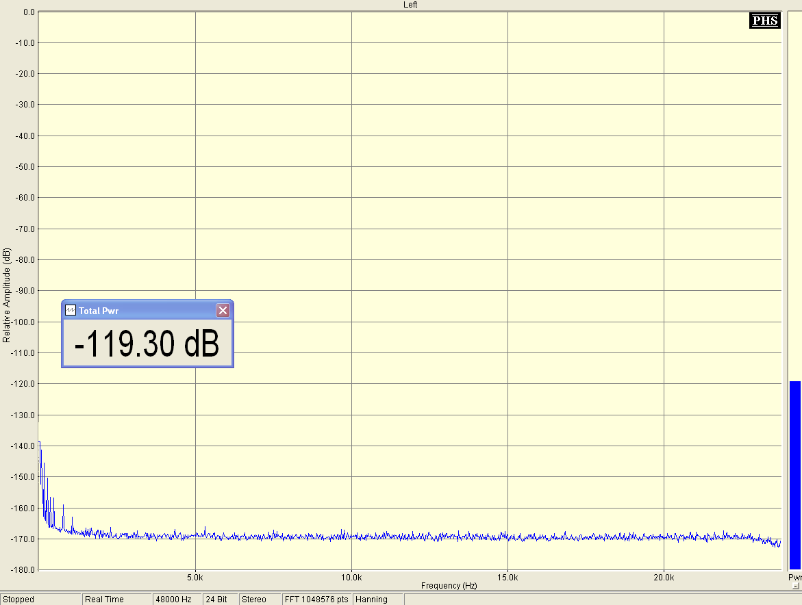

Yeah, current noise or voltage noise choice, all depends on the source resistance.
So, for comparison, I added the dual OPA134 ( OPA 2134 ) as a buffer to the balanced input,
switched to 48kHz and did the 1kHz/sweetspot and 50 Ohm differential noise test.

Thank for those measurements, Ghg.
I don't have done mine.
I don't have a Krohn-Hite or equivalent generator, so i can only test it at 10kHz, using an ultra-low THD "DIY" oscillator.(It is the oscillator described in AN67 from Linear Technology).
This 10kHz generator have 4Vpp output voltage (single ended or 8Vpp in diff mode).
It is powered with same DC source from ADC (JSR06).
I have made measurements with the AA5381 new ADC, and my old design wich use the AK5394A ADC from AKM.
I have find an issue when testing the AA5381 ADC, because the enclosure
had been fully "floating". It degrade the THD performance.
I will fix it this week (adding a direct ground connexion to the box).
I will post all results very soon.
Just in conclusion, my old ADC design outperform all measurements of AA5381..I'm little disappointed... 🙂
Frex

I would like to see it, the ultra-low THD "DIY" oscillator. I know of only a couple of them in existence!
I'd like to ask for a favour please, if you could post the thd+n of the same 48kHz sampling rate and 1kHz/sweetspot. The thd and noise floor of this are quite amazing.
Here we are, and I added a -20dB plot too, according to the datasheet THD+N should be typically -100dB, looks consistent.

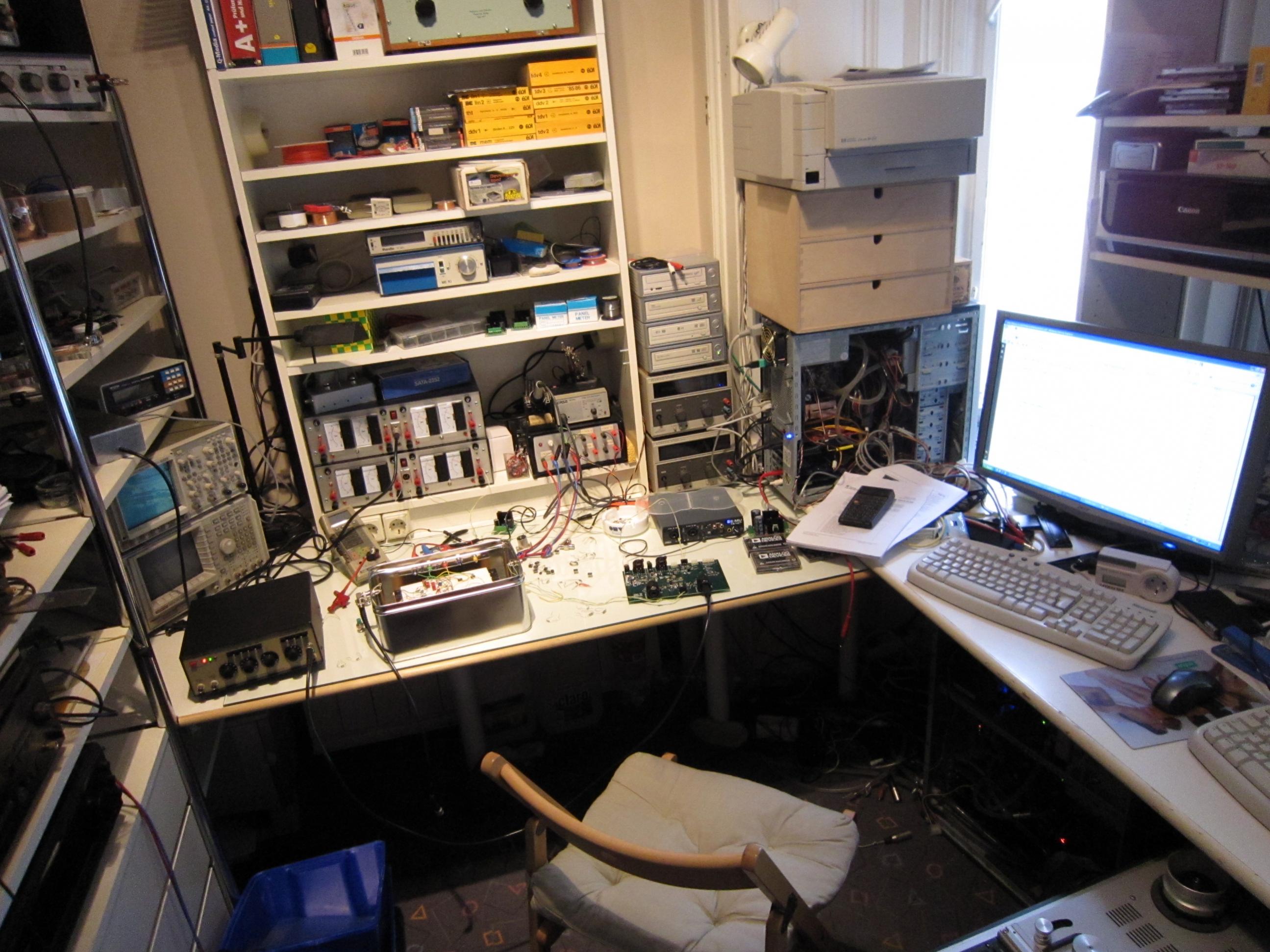

And now I'll have to clean the messy workplace, hardly room for a chair ...

So, 10kHz/5V into TEK, k2 marker gives 567nV at the HP, but where and why was an 20dB attenuator used ? I am confused ...
Maybe you added a +20dB amp after the TEK monitor-out to the HP ?
This would give k2@-119dB ? Impressive @10kHz
