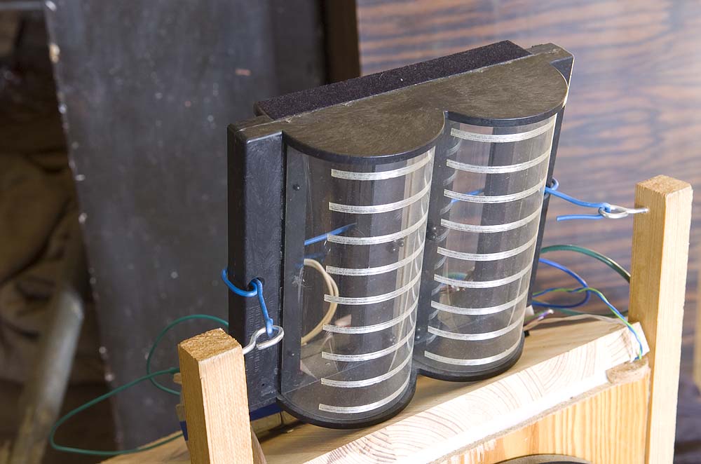

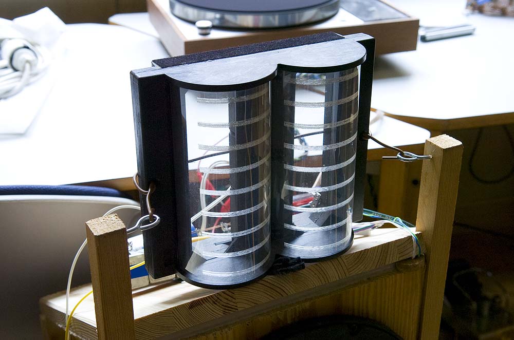

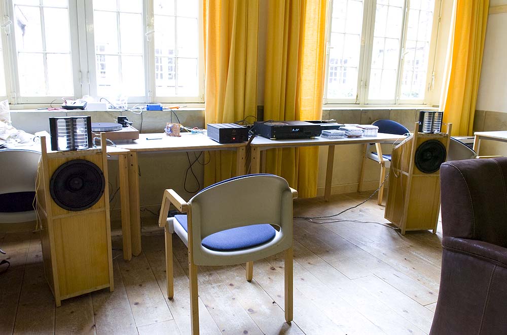

I have made someting similar:
This one is with 5 ribbon and vertical.
The new idea is horisontal with 3 AMT´s.
Bernt
But i like my own idea,and have not seen this idea used.Could be fun.
![URL]](/community/proxy.php?image=http%3A%2F%2F%5BURL%3Dhttp%3A%2F%2Fimg825.imageshack.us%2Fi%2Fbillede049.jpg%2F%5D%5BIMGDEAD%5Dhttp%3A%2F%2Fimg825.imageshack.us%2Fimg825%2F5247%2Fbillede049.jpg%5B%2FIMGDEAD%5D%5B%2FURL%5D&hash=792c1e7d379c4940527bb20fdcb9663b)
Bernt

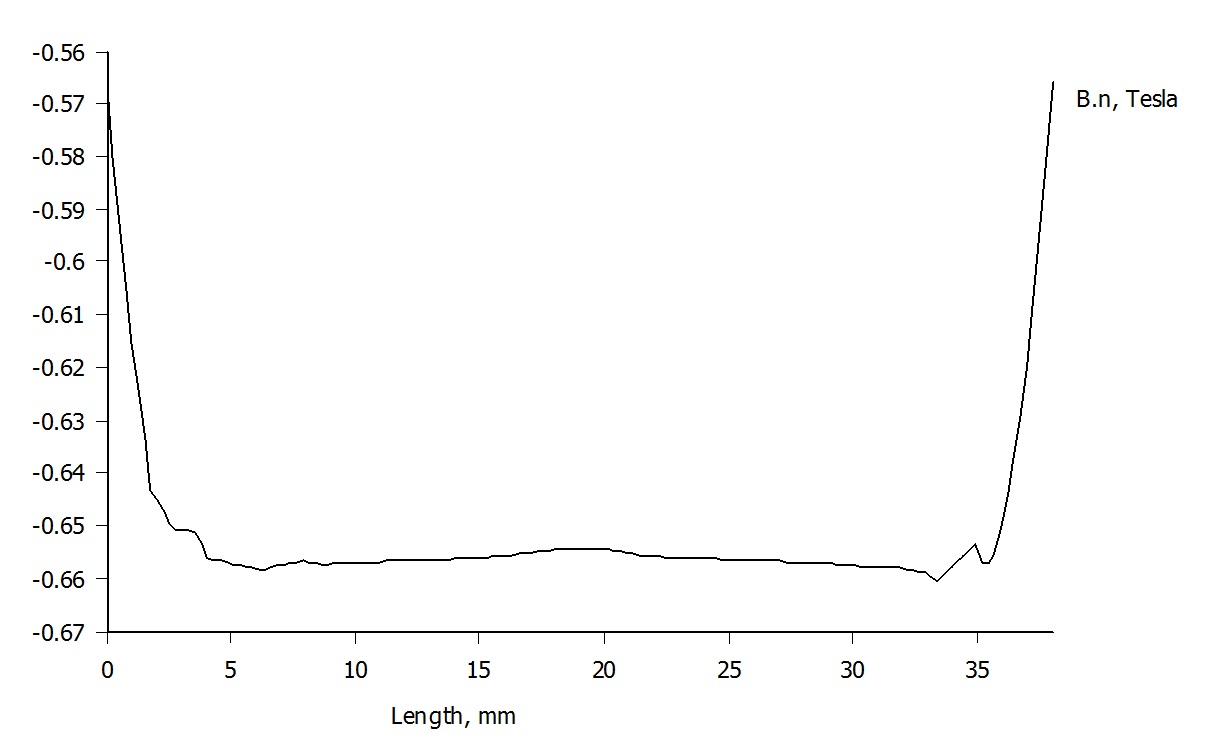

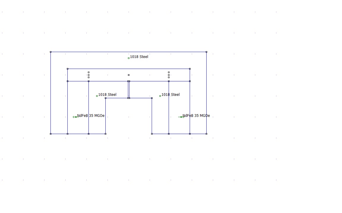

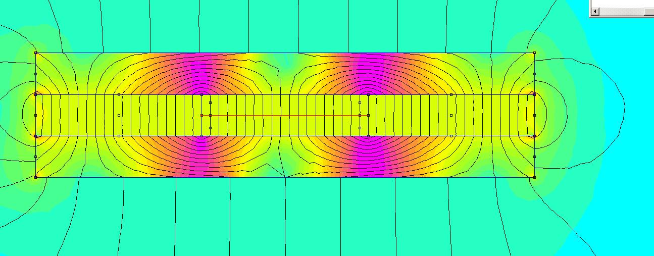

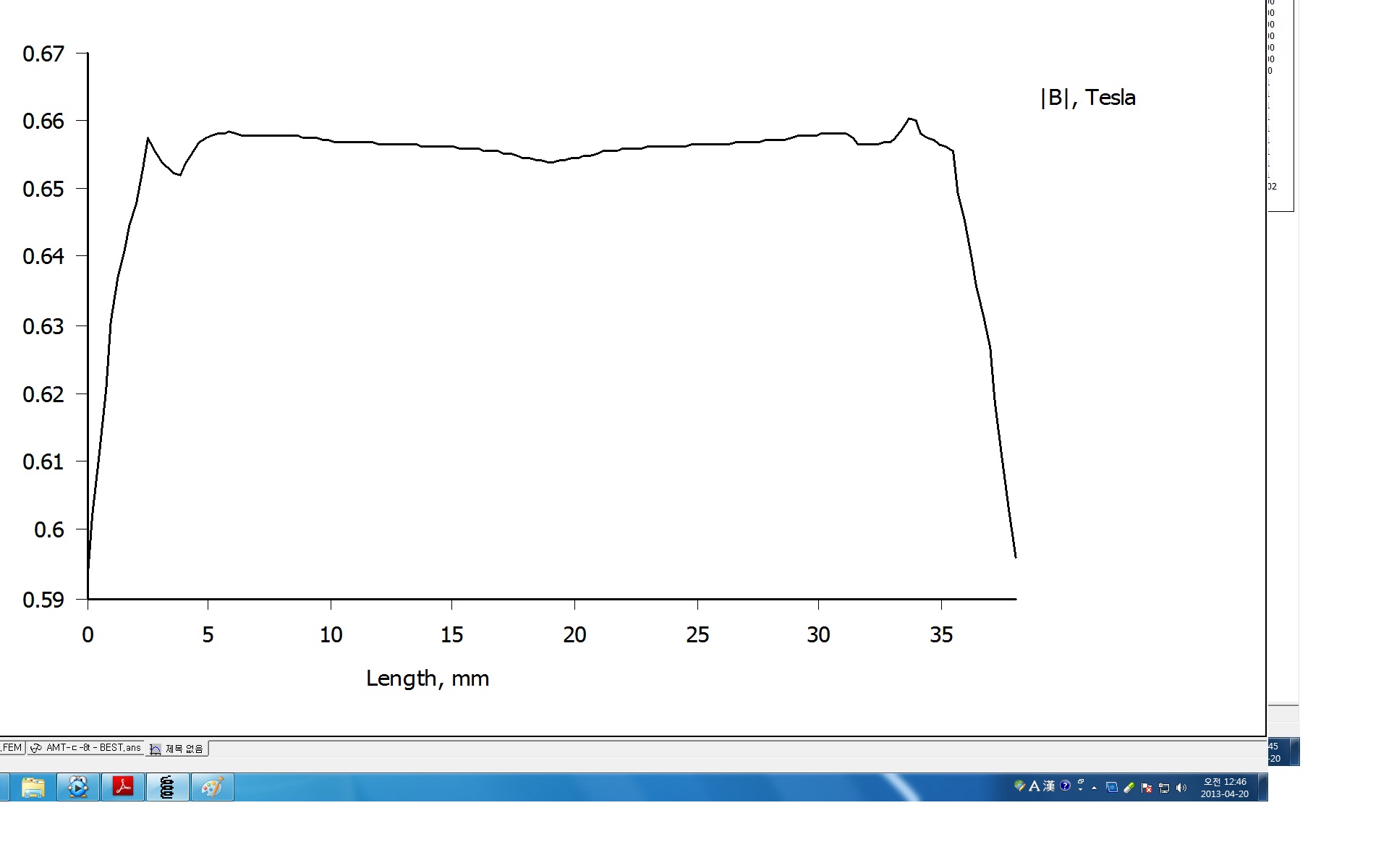

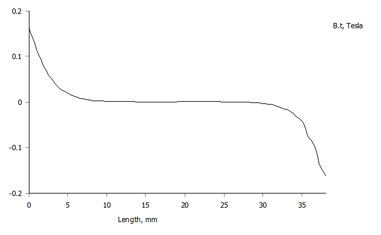

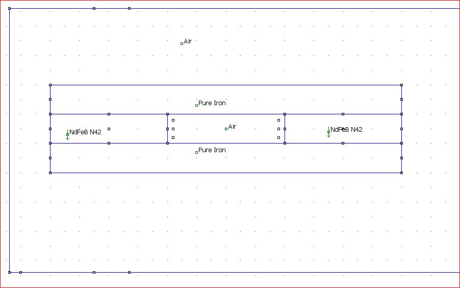

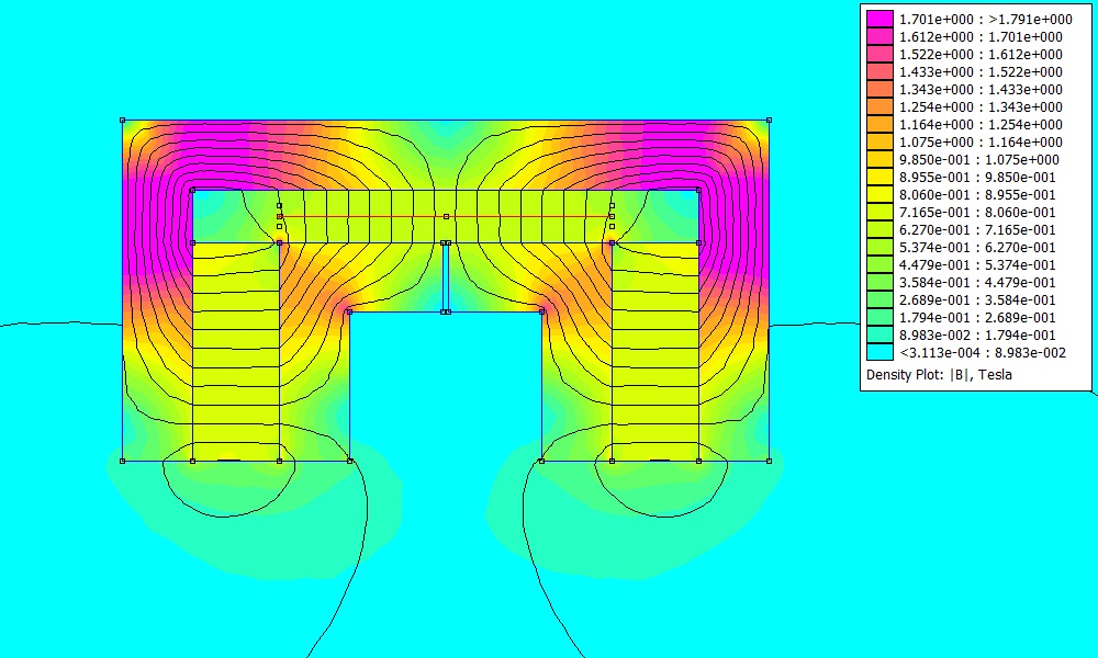

I´m not familiar of the Mundorf system. Could you explain for example what´s magnetes and what´s pole pieces?
The field looks strong and even. Could you simulate b.t and b.n separately?
I would like to see the femm.drawing too,and as solhaga wrote,it looks good.
I prefer the open model I use myself,but this one has stronger and more homogen field.
Bernt
Bernt
Attached my magnet system in detail.
There are 6 magnets of 40x25X10mm, N35 and the inner steels are separated each other to be attached on the magnets perfectly.
The gap between the inner steels doesn't affect to the flux density so much.

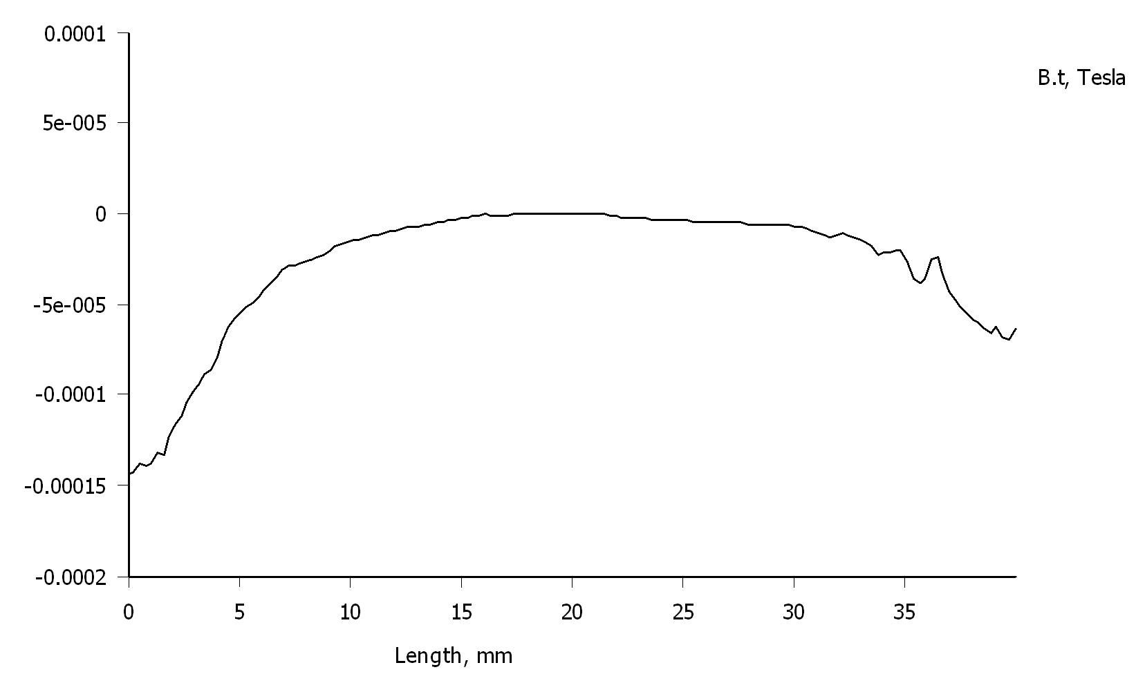

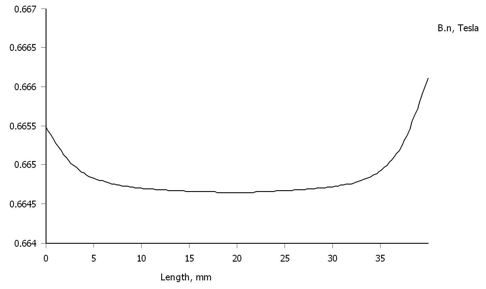

Just did a simulation of a much slimmer design of my AMT with an air gap of only 40 mm.
I get the same b.n strength as yours but even in the whole gap 0 - 40 mm.
The b.t field is zero in the whole gap 0 - 40 mm.
It is also much easier to make with straight rods everywhere.
Thanks for your reply !
Truly, the U-shaped magnet structure is not so simple to make.
I'd like to see your simulation.
Could you introduce your slimmer design ?
