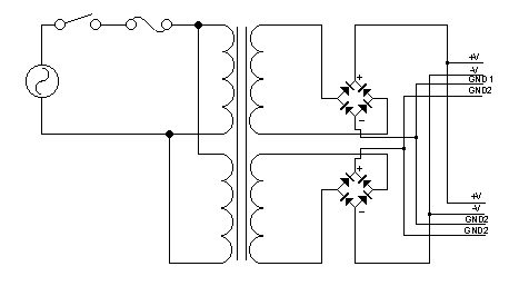

so looking at this schematic http://home.student.utwente.nl/f.s.bouwman/audio/images/invertedLM3875.gif
i see that the schematic gives 2 grounds and one V+ and one V- .. am i correct?
but .. the schematic uses both of the secondaries? which confuses me ..
seems to work for one channel, what happens for the second channel???
or is that for use with two torroids? (i'm planning on having one 400VA)
oh, so you mean looking at the previous power supply i just branch V+, V- and the two grounds (i guess you could call it y-splitting?) and then run each through a separate wire to the amps?

decided to take another look at the power supply .. so i decided maybe i'll apply what i've learned so far (the little i did), use someone else's PS scheme (can't remember whose .. posted a link earlier) .. and this is what i came up with
Does this look good to you Peter? (Or someone else?) Or am I missing something?

I use the same, except that the 2 gnd are connected together
why do you use 2?
peter recommended at some point in time (and earlier in this thread) to use 2 separate grounds, which are not connected until star ground in the amps themselves ..

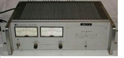

mbe it bears repeating -- start with an old HP power supply
if you want to build an inexpensive high end amplifier -- start with one of the older HP, Kepco, Fluke, Lambda, Systron Donner programmable analog power supplies -- a supply rated for 100 watts is rated for 100 watts industrial, not 100 watts by Pioneer or Sony -- these supplies are used by GE, Boeing, GM, etc. for continuous testing. Because many of these units used separate binary encoders (often lost in the shuffle) they can be had for $10 to $30. My last acquisition was an HP6130 for $19 just this week.
You get a first class chasis, first class power interconnects, fusing relays, meters -- and a big butt transformer (sometimes 2). As many of these power supplies are amplifiers in reality, there is plenty of room to modify and add the guts of a very nice modern amp inside.
