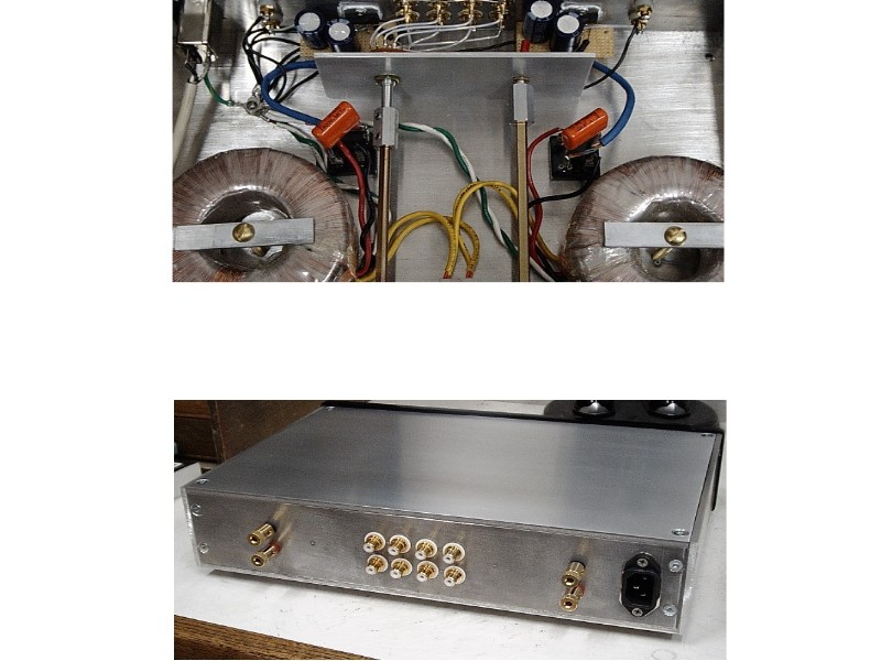

All my many GCs are built using good quality off the shelf parts, Evox rifa for the small caps, Rubicon ZL for the electrolytics, and standard metal film resistors. This was because I was more interested in comparing the different chips, and if I had spent £40 on parts for each one then I would be even more broke than I am currently!
The finished results compare favorably with commercial £1000 amps, even tho I prefer OPA chips to the LMs. If you want to know why, read Peter Daniel's comments in the NJAGC thread, his experiences are similar to mine, we just come to opposite conclusions from a taste point of view😉

I have changed a few things since these picks, like using MSR860 diodes and done some dampening of the transformer mountings. I will be changing out the binding posts soon but that will require some additional drilling of the back plate and downtime I don't want to have. 😉

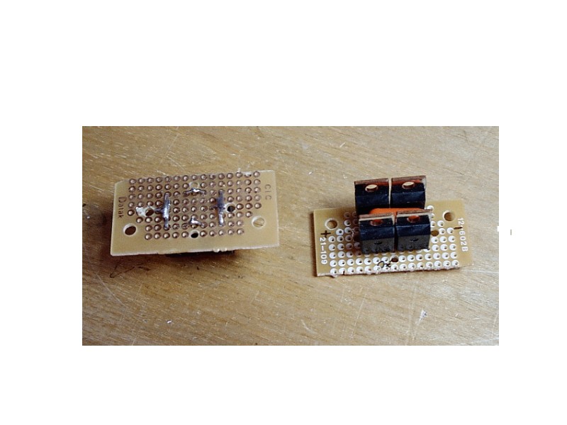

Here a pick of my rectifiers. Four of these are going into an intergrated AlephX/BOSOZ/APOX-1 unit I am thinking about... ok, ok dreaming about. Look at the datafile for the diodes you have for the orientation and build it from that.
