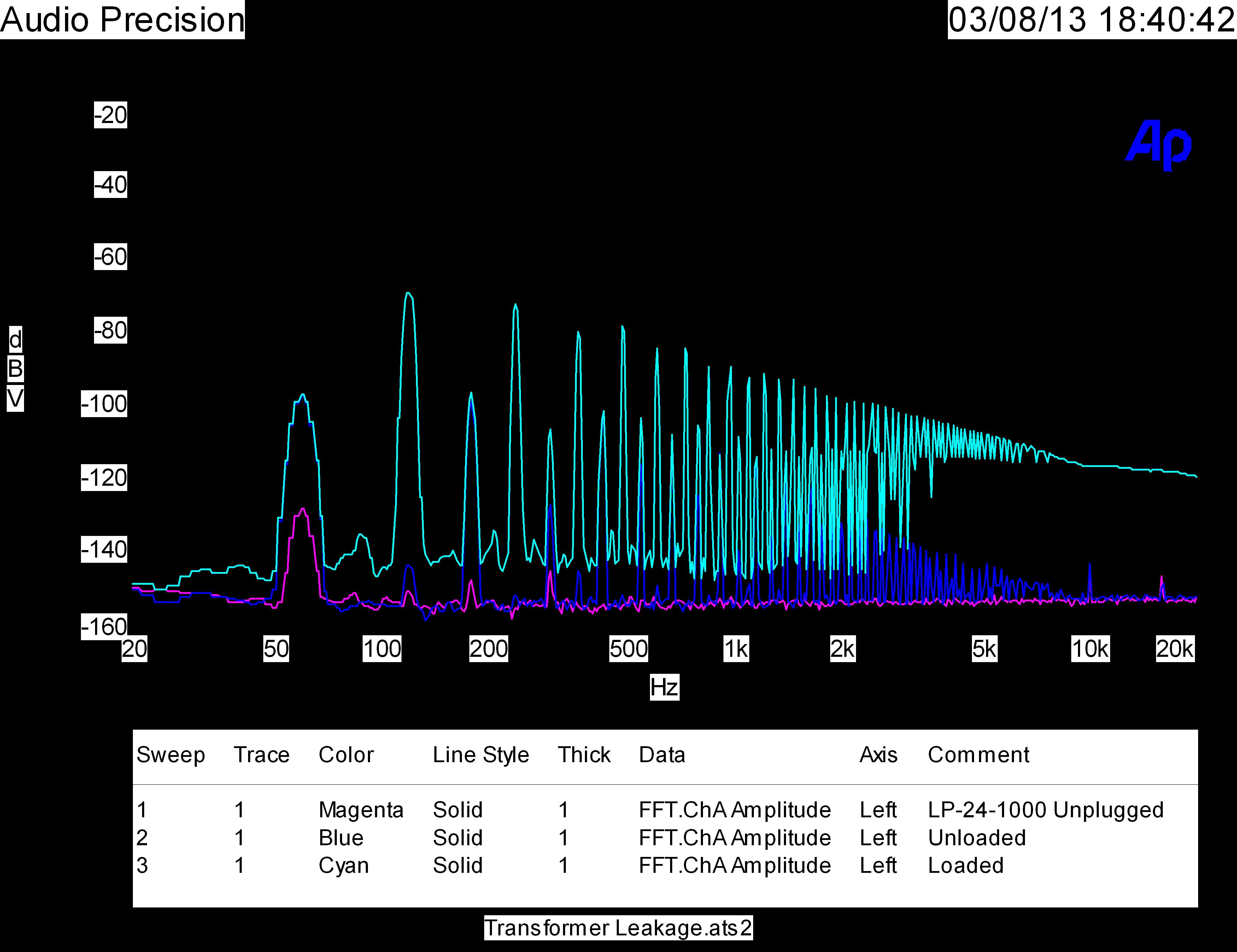

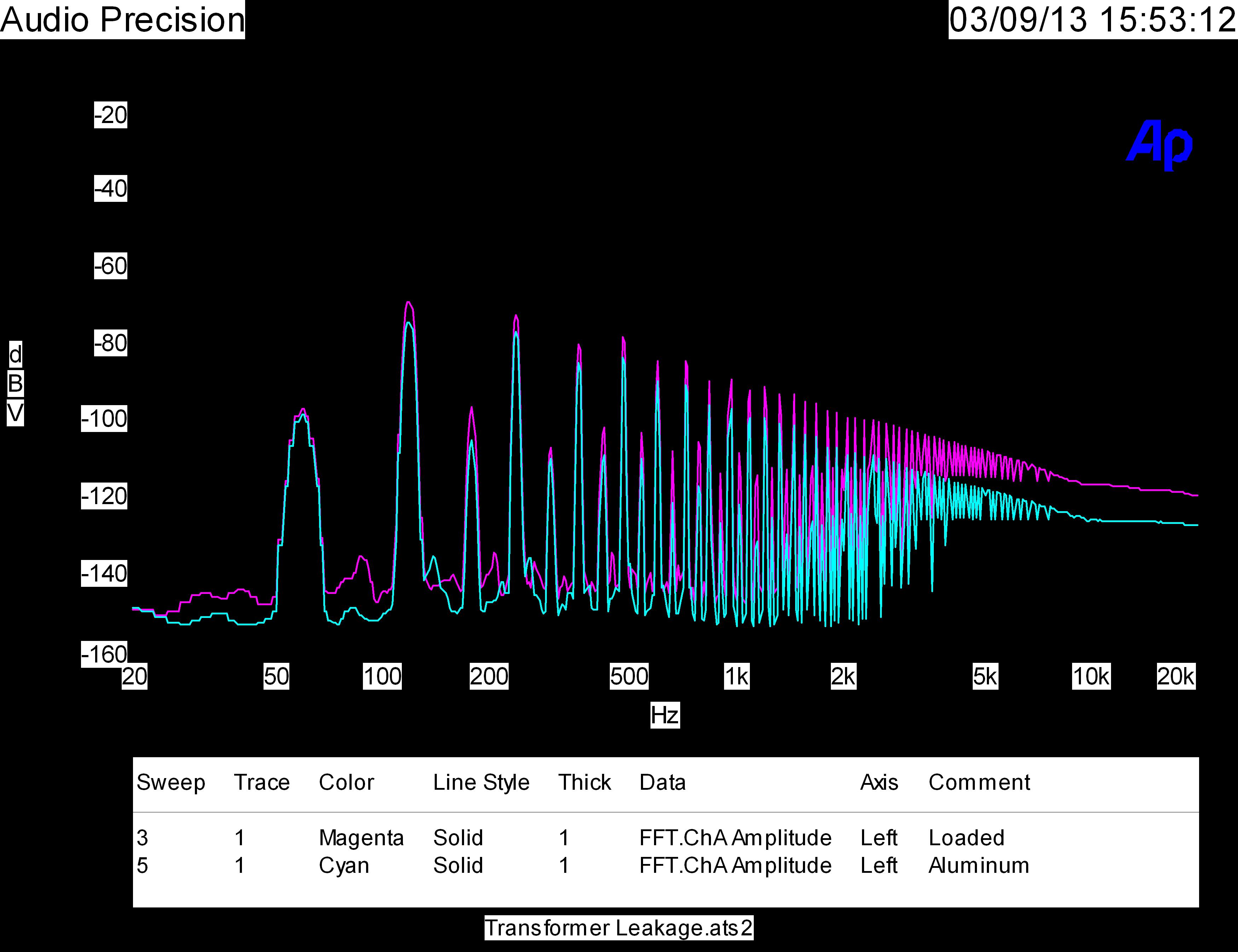

AP doesn't build audio gear, they build test equipment. They still have issues with AC line frequencies drifting into measurements. It looks bad on the plots.
But not as much an issue with real audio gear as clean 60 Hz is hard to hear. The harmonics are what are picked up.
ATTACHED ARE MY MEASUREMENTS using my AP and the same transformer on both a steel and aluminum chassis. Note the baseline measurement on the first plot. That is the limit of the test setup.
