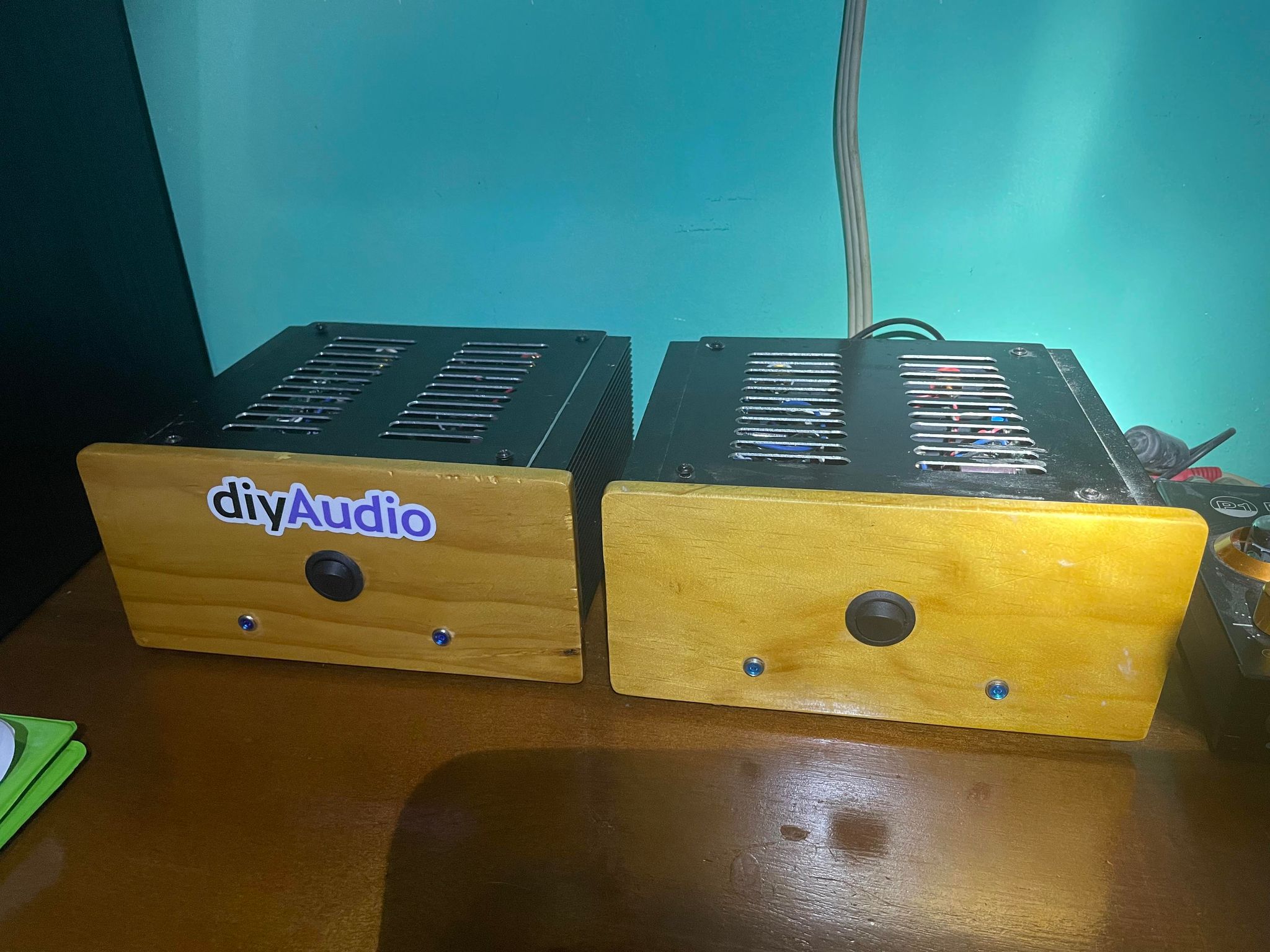

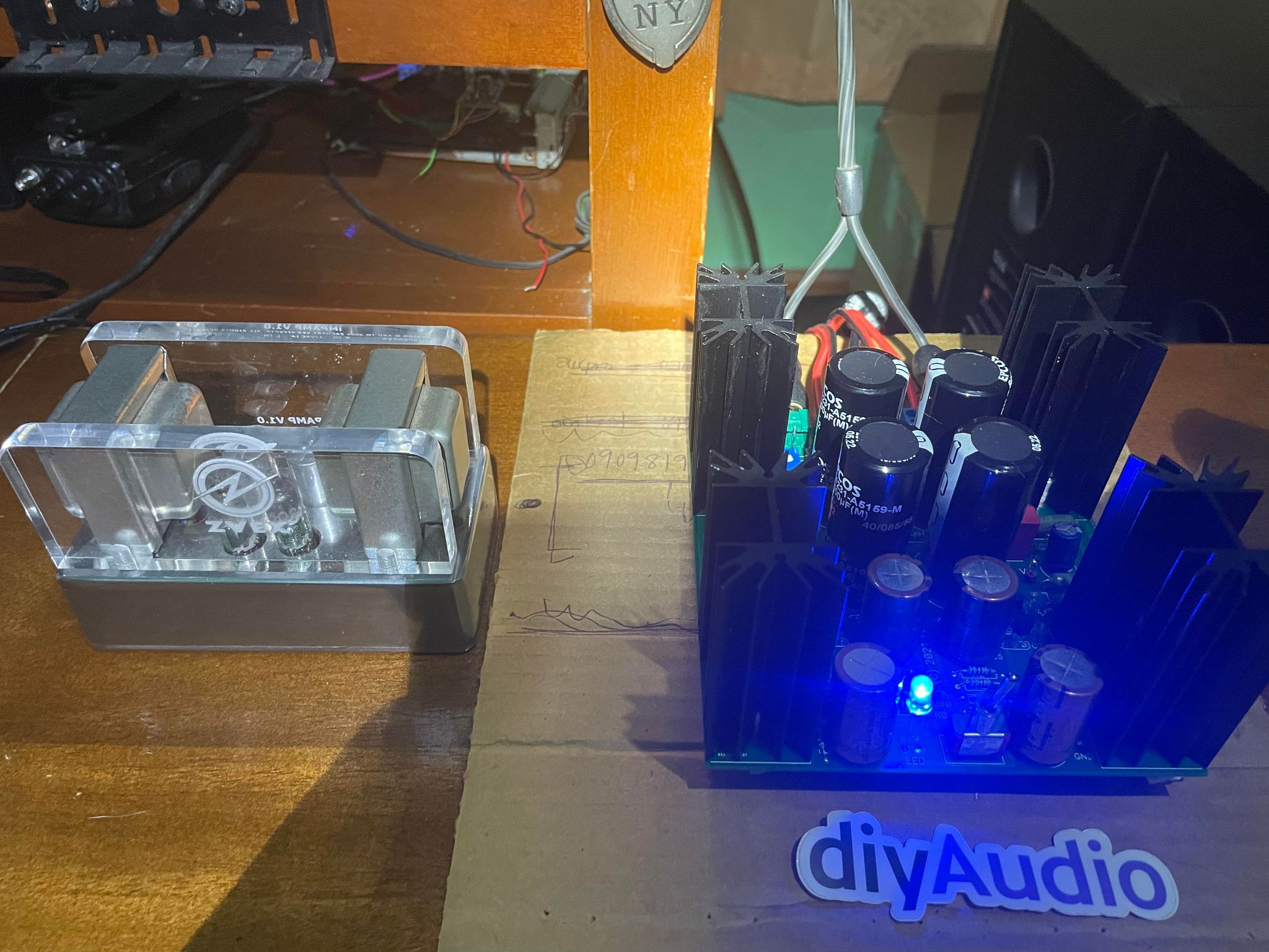

Finally added papa Nelson's ACA mini to my hifi audio amplifiers collection. The ACA-mini class A push pull design runs with SL 24V 48W (energy efficient).
My next project is to have a good wooden case for the ACA-mini and start building the ACP+ preamp. Cheers everyone. Enjoy music and the hobby.
