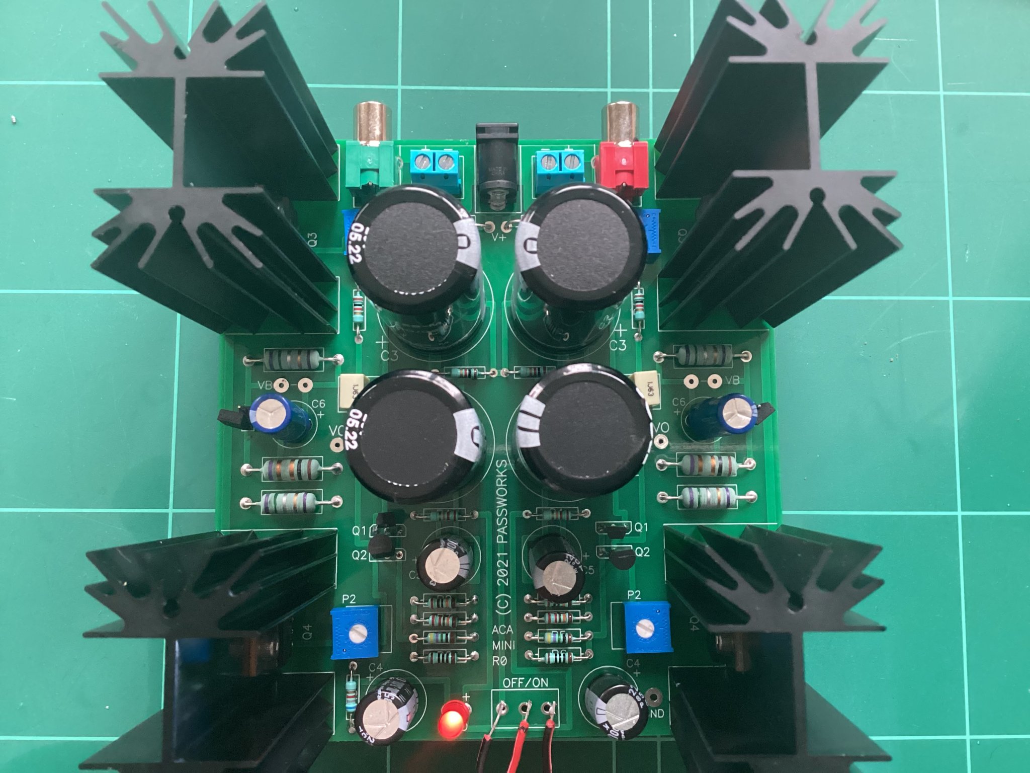

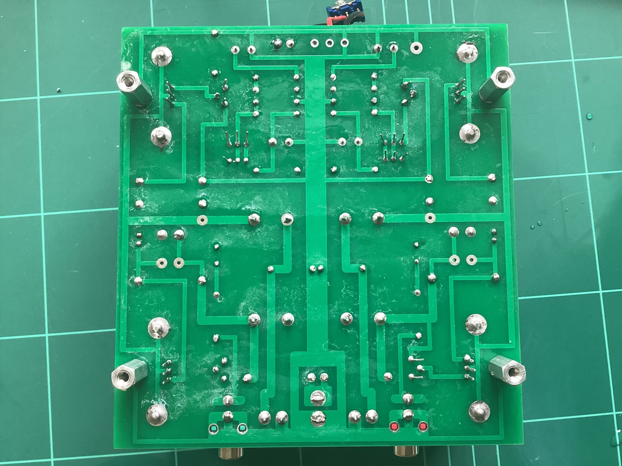

My first amp amp mini from a kit from DIYaudio (I’ve got two to build) and I’ve got a ‘noobie’ problem…
when powering up the amplifier, the voltage at vb is 24v instead of a few hundred mv. I’ve obviously got an error somewhere, but can I see it?😡
Please help!😀
