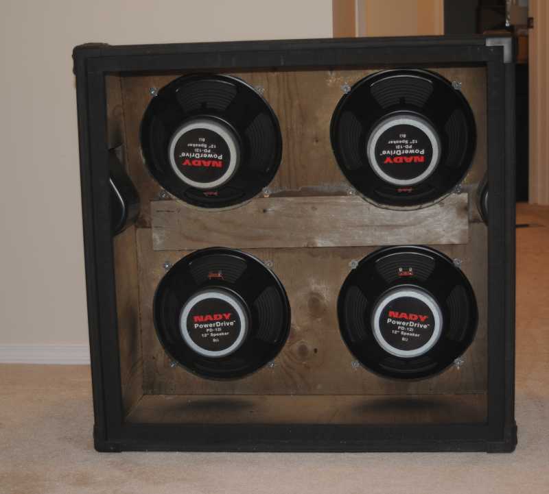

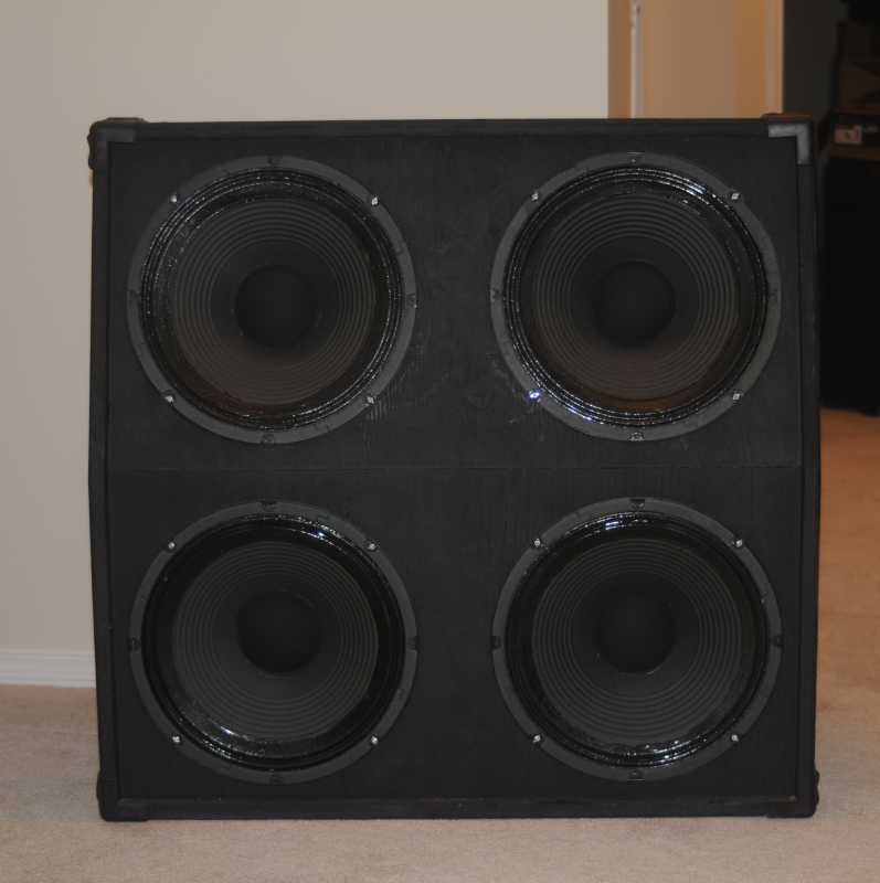

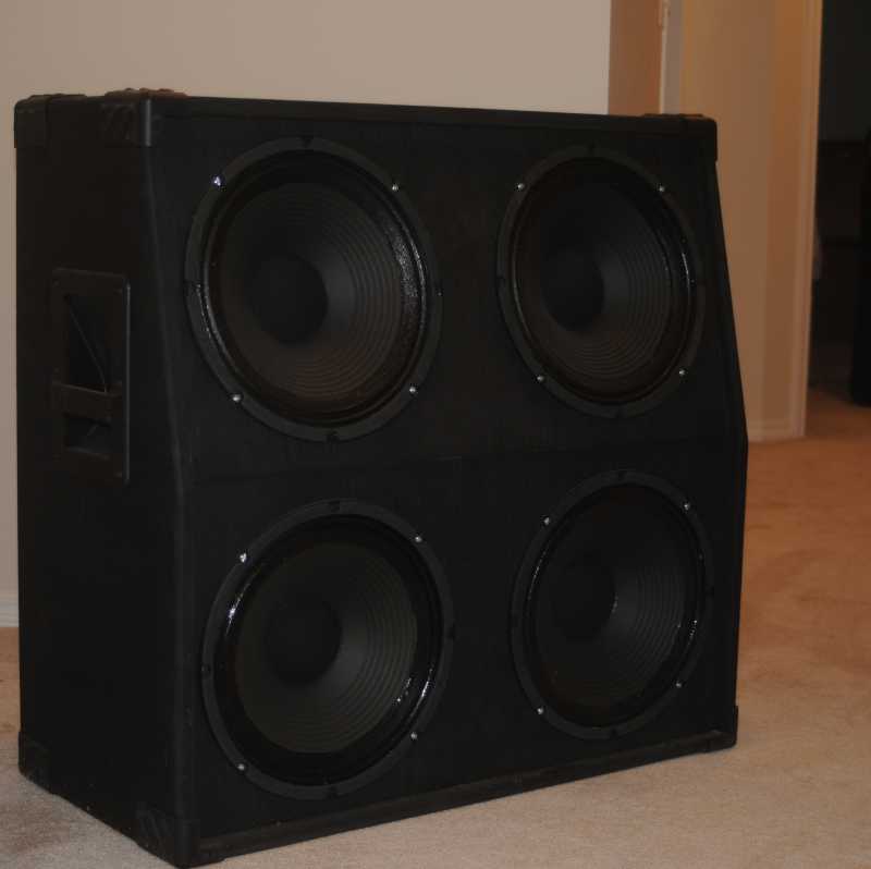

I'm attaching pics of my 4X12. It is built to roughly Marshall 1960A dimensions but nothing like it in construction: it is a simple glued box.

cool thanks im thinking of making it a straight cab with a removable back do you think this work well? and if you have a pic of the wiring of your cab could you post that please thanks
you might think about mixing up the distribution of the two varieties for a better mix of sound too. i.e. a tonker and gov on top and the reverse for the bottom. I say this because unless the box is elevated you will hear more of the high end from just the top 2 speakers. Also, and I know its more of a hassle to build but, if you only have one cab its pretty nice to have a slanted.
In response to your power/speakon jack question, speakons only really matter if you're going to consume that kind of power(something tells me you're not going to run a 400w amp into this thing and run it to clipping). Also, if you're going to play live spare speakon cords are harder to come by then spare 1/4 in if you happen to kill/lose one.
