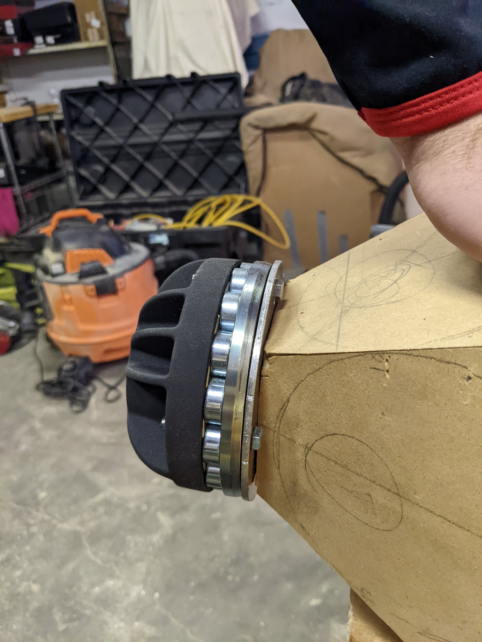

I too have built a DIY version. Was curious, how did you mount the compression driver? Any pics or details on that? I used a PRV D290P with a 1-3/8"-18 TPI Screw-On. As I have learned, this does not get the Mid and The horn driver close enough and creates a null.

You could try rounding out the squared off sides of the horn throat inside the mounting plate circle.
I found any step or irregularities on the higher frequency drivers to have a very detrimental effectv on sound on my 12 sided conicals.
Ideally a nice smooth transition aka the AH-400 horns.
I achieved that with a smidge of filler to make the angles of throat rounder, then transitioning to 12 sided or however many.
Same thing if a round throat, say tractrix or Le Cléac'h is slightly misaligned to the driver.
Causes soundwave mayhem.

We ended up using some filler to smooth the throat plate step to the 3D-printed throat transition. The scans were good enough using filler and we avoided grinding the plate without proper machinist tools.
