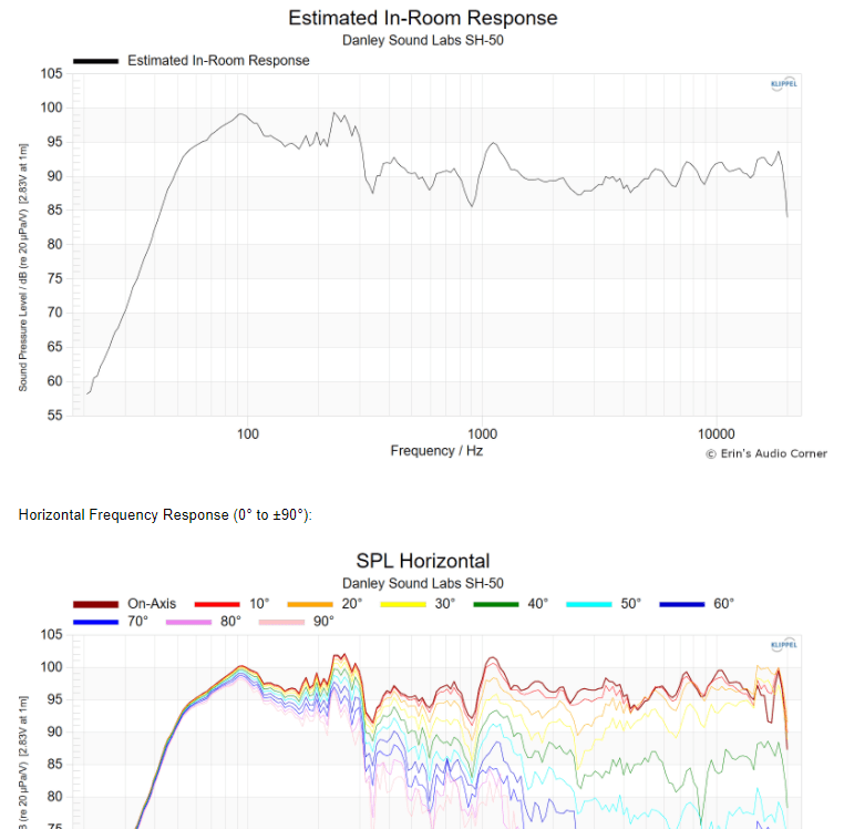

Problem with only single frequency response measurement is that it does not represent the in-room response (in general) and can contain issues that are not meaningful to adjust with EQ, or vice versa hides issues that could be EQ:d. Perhaps for the OP application and given the narrow dispersion of such construct single measurement is fine. You are right this info is all over the forum so no point rehashing it here, Allen asked and got answers 😉
edit. Erin has measured SH50 here https://www.erinsaudiocorner.com/loudspeakers/danley_sh50/
If one compares on-axis response to the Estimated In Room response they look almost the same on a quick glimpse. Perhaps single measurement is enough in case of the particular speaker.

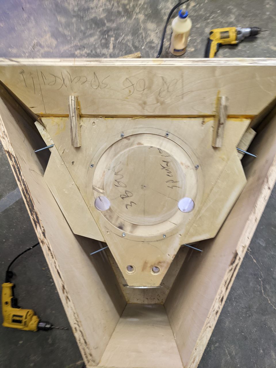

To the OP: if you want to stiffen up the entire box, Danley uses through bolts and pre-stresses everything (tension) such that the entire box/horn is very inert and non-resonant. There are long Allen head countersunk bolts and Allen head end ("tee") nuts attaching from the inside of their horns to the outside of the box--significantly strengthening and stiffening the assembly without adding weight, shown below in red color (that I added to the photos):
The countersunk bolts don't detract from the acoustic performance of the horn, because they're too small and too far away from the throat to be acoustically relevant.
The woofers in an SH-50 are on the top and bottom of the horn (symmetrical at 50 degrees coverage, but with flat/level top and bottom sides. It's tight inside the box, however, and they add an extra access port per top and bottom near the front of the box to be removable such that the box can be disassembled/reassembled from the horn without clearance problems with the woofers. I think they make it so tight so they can array these in side-to-side top-to-bottom bunches for arenas, etc.

Thanks for pointing this out! I was struggling to find a good mounting system that didn't depend on tons of wood screws and still be serviceable. I like how the design leverages geometry to self-support and stiffen the box system.To the OP: if you want to stiffen up the entire box, Danley uses through bolts and pre-stresses everything (tension) such that the entire box/horn is very inert and non-resonant. There are long Allen head countersunk bolts and Allen head end ("tee") nuts attaching from the inside of their horns to the outside of the box--significantly strengthening and stiffening the assembly without adding weight, shown below in red color (that I added to the photos):

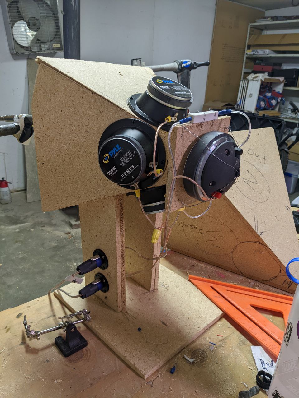

Prototype #1
Incorrect bevels, incorrect amp for the CD, particleboard, terrible craftsmanship, but it was great for feasibility testing and part selection. Five prototypes later.....
Im probably going to replace the 5" Pyles of Sh#$ with some sealed back 6.5" Eminence drivers and replace the PRV CD with Faital Pro HF108's. This pair of speakers is going to be used for marathon outdoor DJ sets and pushed hard.

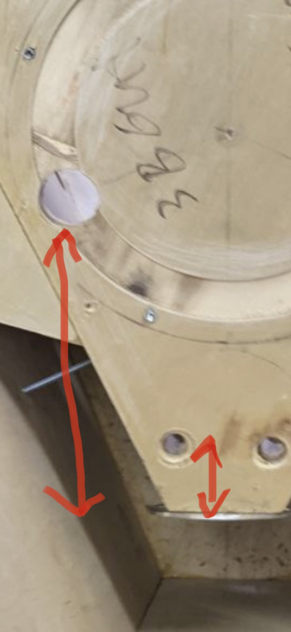

This was a great tip and I ended up using this bolt pattern in our final build. Its obvious in hindsight , but I initially failed to realize that the cabinet parallels the inside horn perfectly so the bolts are normal to the sides. Its super secure and I don't see any need for baffling/filling material now.To the OP: if you want to stiffen up the entire box, Danley uses through bolts and pre-stresses everything (tension) such that the entire box/horn is very inert and non-resonant. There are long Allen head countersunk bolts and Allen head end ("tee") nuts attaching from the inside of their horns to the outside of the box--significantly strengthening and stiffening the assembly without adding weight, shown below in red color (that I added to the photos):

Just put one up!Nice. Do you have any pictures of the bolt arrangement?

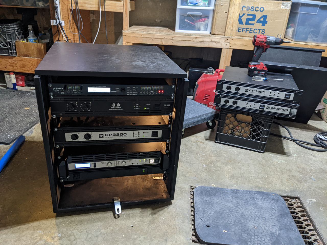

Final driver and amp configuration:
1 x Faital Pro HF144 - XO@1khz
4 x Pyle PDMR5, xo @ 1Kz and 350hz
2 x Faital Pro 12HF5010, xo @ 350hz and 50hz
1 x Dynacord CL800
1 x EV CP2200
1 x EX TG-7
We played with each XO slope until square waves were represented as accurately as possible at the XO frequency
