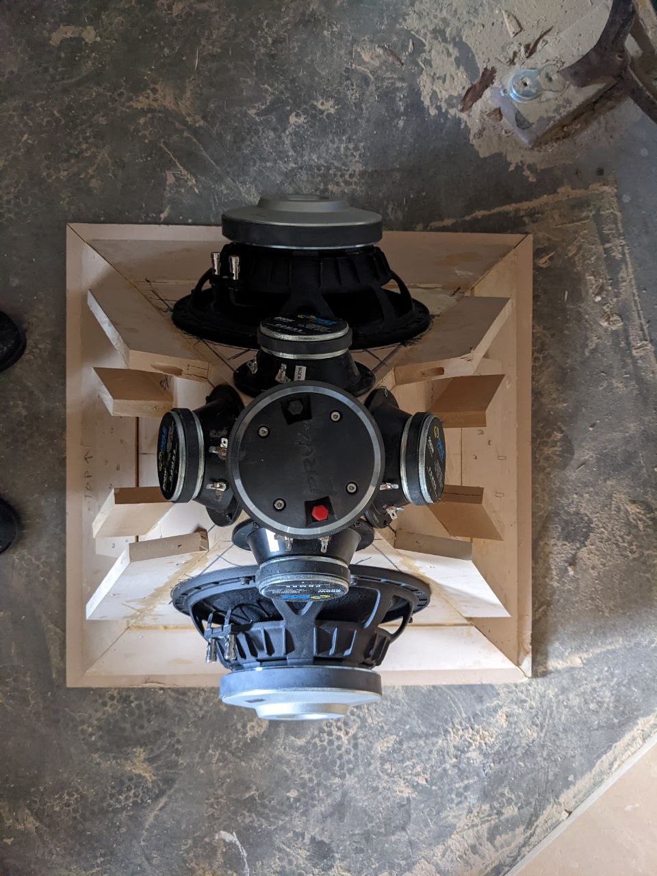

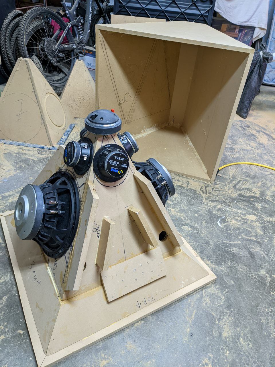

Hello and thanks for tuning in to this thread. This is my first speaker build and post on the forum, so please excuse my ignorance of some of the finer points of speaker design.
This prototype build is a tri-amp clone of the Danley Sh-50 with active DSP processing. My goal is to get 60hz to 16khz with a pretty flat response and operate around 130dBc @ 1m.

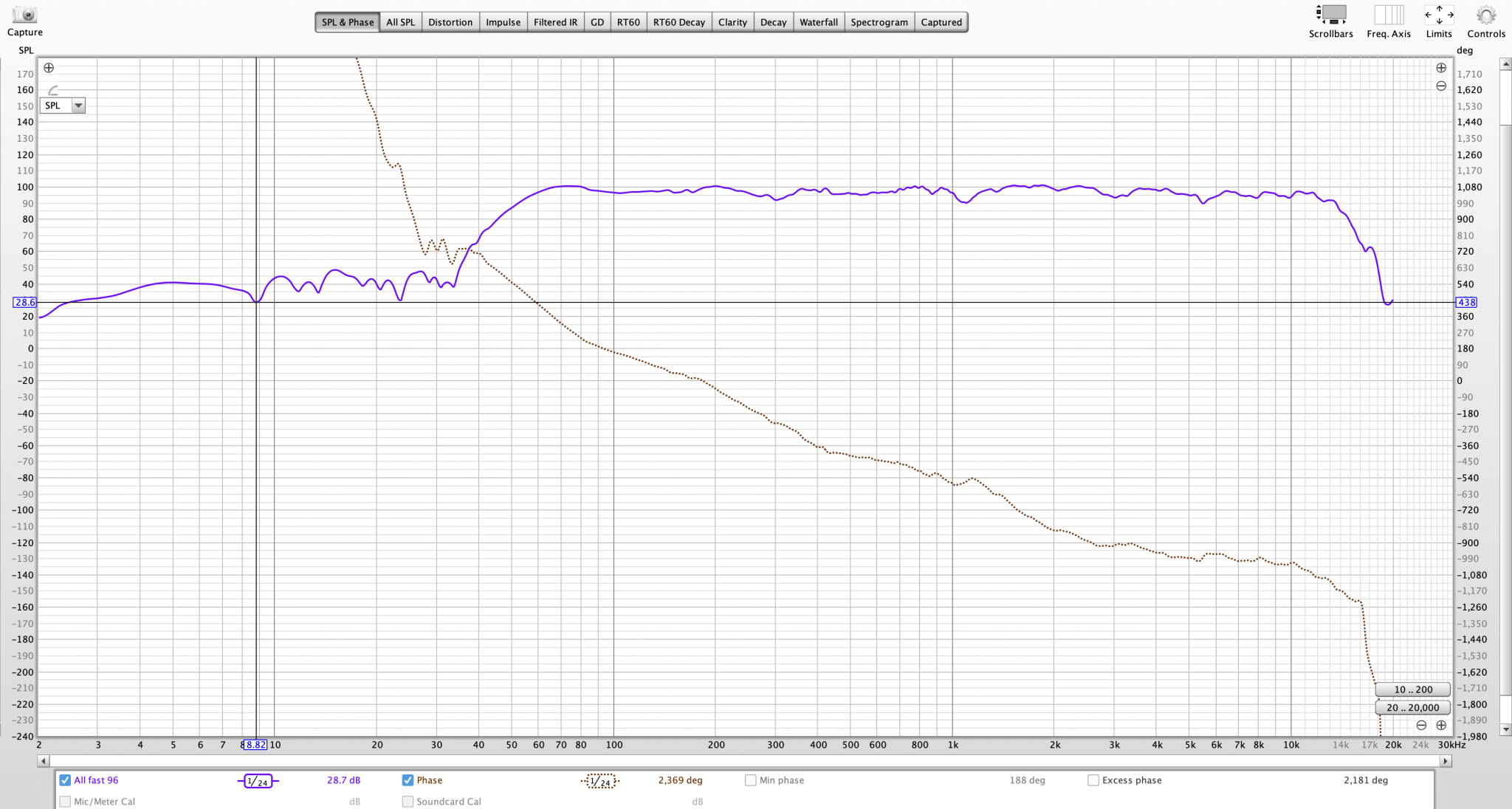

So far everything is working great at the desired volumes but I would like to improve the phase of the speaker and maybe get some feedback on ways I can improve this build before I commit to building the final pair in 3/4 Birch. Any comments are appreciated!
Attached is a picture of the SPL/ Phase response in REW, measured at the center of the horn opening with calibrated levels and RTA mic.
XO: CD (HP -48 Linkw @1350hz), MIds (-12db Butter Low Pass @ 1350hz and HP -12 DB Butter @ 350hz), Sub (HP -48 Linkw @ 60hz and LP -48 Linkw @350hz)

IMAGE 2022-03-08 15:26:47.jpg
IMAGE 2022-03-08 15:28:13.jpg
Very nice proto! Methinks you are ready to build the finals.🙂
I like the way you made an outer shell, ala Danley style. I think that's necessary to get the rear volume needed for the bass-reflex ports to work.
I've never been willing to do that, but solely due to wanting to avoid weight. What do estimate you builds will weigh?

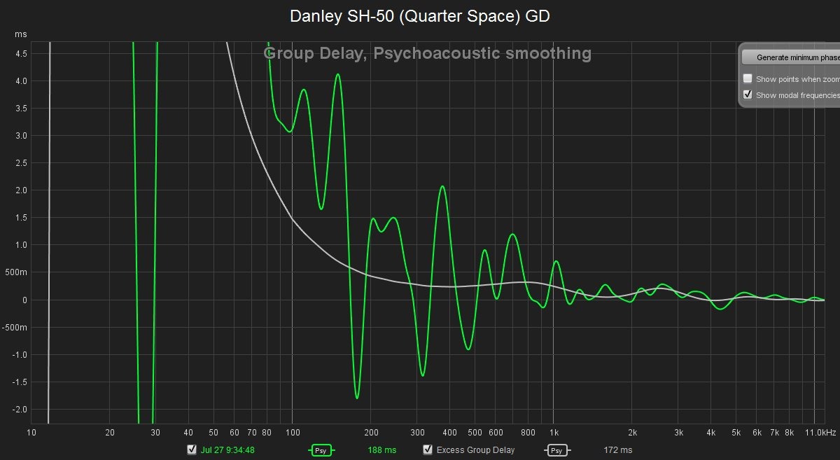

Your tri-amped SH-50 clone looks like the actual SH-50 in terms of its phase response (including the group delay rise below 200 Hz due to its bass reflex design , and your SPL response is flatter than the SH-50 in-room--comparing to my own measurements (note the vertical scale in milliseconds/microseconds):
Oooff these def are not light! I would guess they are around 140lbs easy. I dont mind the weight because this clone will replace four 2-way 15" powered speakers that weigh as much in total.

Thanks for sharing your measurements they are very interesting! I didnt have access to much data on the actual SH-50 other than what was shared in the patents. I noticed in the actual SH-50 the total degrees of phase rotation is less than 360 degrees, does that even matter? I was able to get much better group delay by recording click/impulse track in ableton live and visually adjusting the delay time for each frequency band independently. I couldnt get as good of results using REW's tools.
Nice work! since you have DSP as crossover you can achieve much flatter respobse. The scale of frequency response plot is crazy 5db per line, the response seems to be +/-5db and you can do a lot better with DSP I think, +/-1db.
Thanks for the tip on the axis. I only did two eq boosts so it would be easier to diagnose problems with the spectrum. I didn't really think about leveraging all the processing power to get the response super flat like that but its a good idea to try out!
share the raw driver responses?
from my experience using lots of PEQs to hammer a response flat sounds great as long as the underlying measurements are good (no reflections) the crossovers are good (large phase overlap region, meeting target slopes, time aligned) and your not trying to boost nulls due to acoustic cancellation. In a Synergy you may need to have differing high and low pass slopes to get a good phase overlap.
Yeah the differing high and low pass slopes at crossover points seemed to improve the magnitude response significantly. My measurements are not perfect either, and could def benefit from an anechoic chamber at times!

Certainly, lets see how the thread evolves, nugget of info at a time 🙂 Measuring at least listening window and perhaps even 0-180 would help. It is symmetric device so full set of measurements is just 0-180, input them to VituixCAD and bam, graphs to see what should and what should not be EQd.
