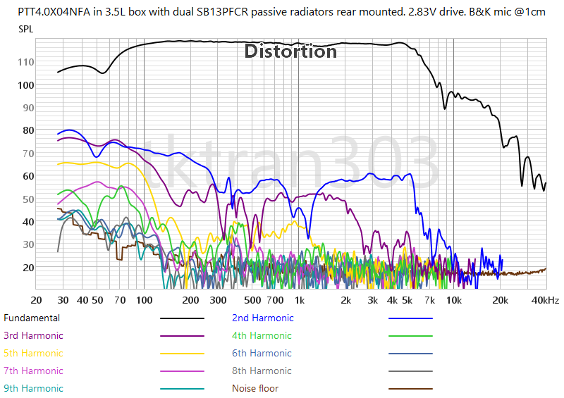

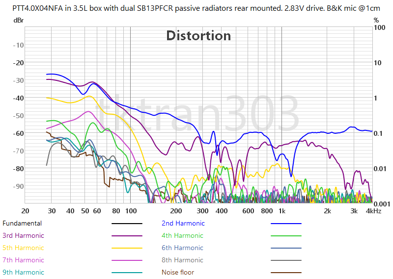

BEFORE:
using Sonarworks Xref20 electret condenser mic, model details here:
AFTER:
using Brüel & Kjær 4191/2669 microphone, model details here:
another view:
LESSON:
The electret condenser microphone may NOT be suitable to measure distortion in the nearfield.

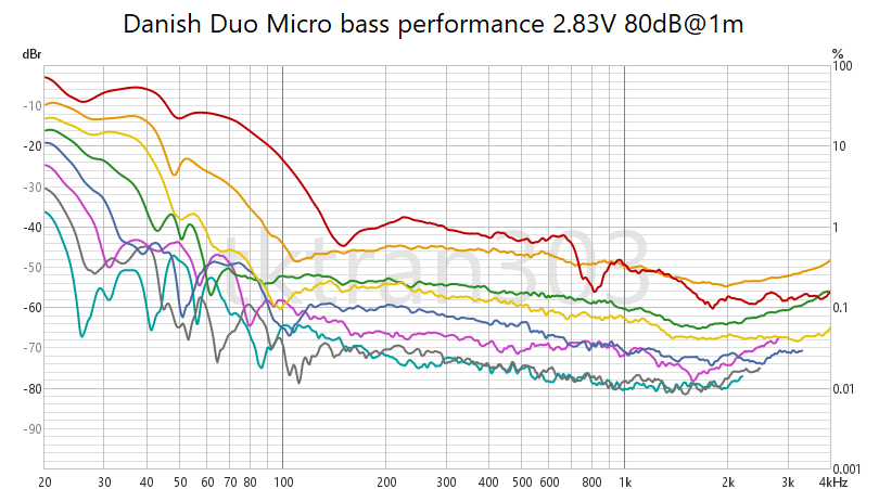

LESSON:
That is an incomplete conclusion and shall not and cannot be used a an absolute definitive answer without context.
In fact, in my opinion it's not even a correct conclusion as an absolute statement.
Electret condenser microphones have their limits and threshold, like literally anything else!
As long as you respect those limits, or know how to look around them, they still have their usage.
Maybe not for the sport called pixel peeping, but it WILL show you when the distortion of a tweeter starts to ramp up or where certain distortion modes are from like cone break-ups.
So saying that electret microphones are not suitable for measuring distortion, is just simply incorrect.
Shown by already those two arguments.
Which is what's needed for 99% of loudspeaker designs.
It's only a very small and select group of people that really care about those very low numbers.
If we wanna actually stick to real science and engineering, we MUST also ask the question if those numbers are not totally swallowed up by things like background noise etc?
Knowing relevance, significance and orders of magnitude is an absolute essential part with any experiment.
Giving any conclusions without providing those is by definition already extremely debatable and in some cases completely false.
It's important to give the entire context to a certain statement and/or conclusion.
