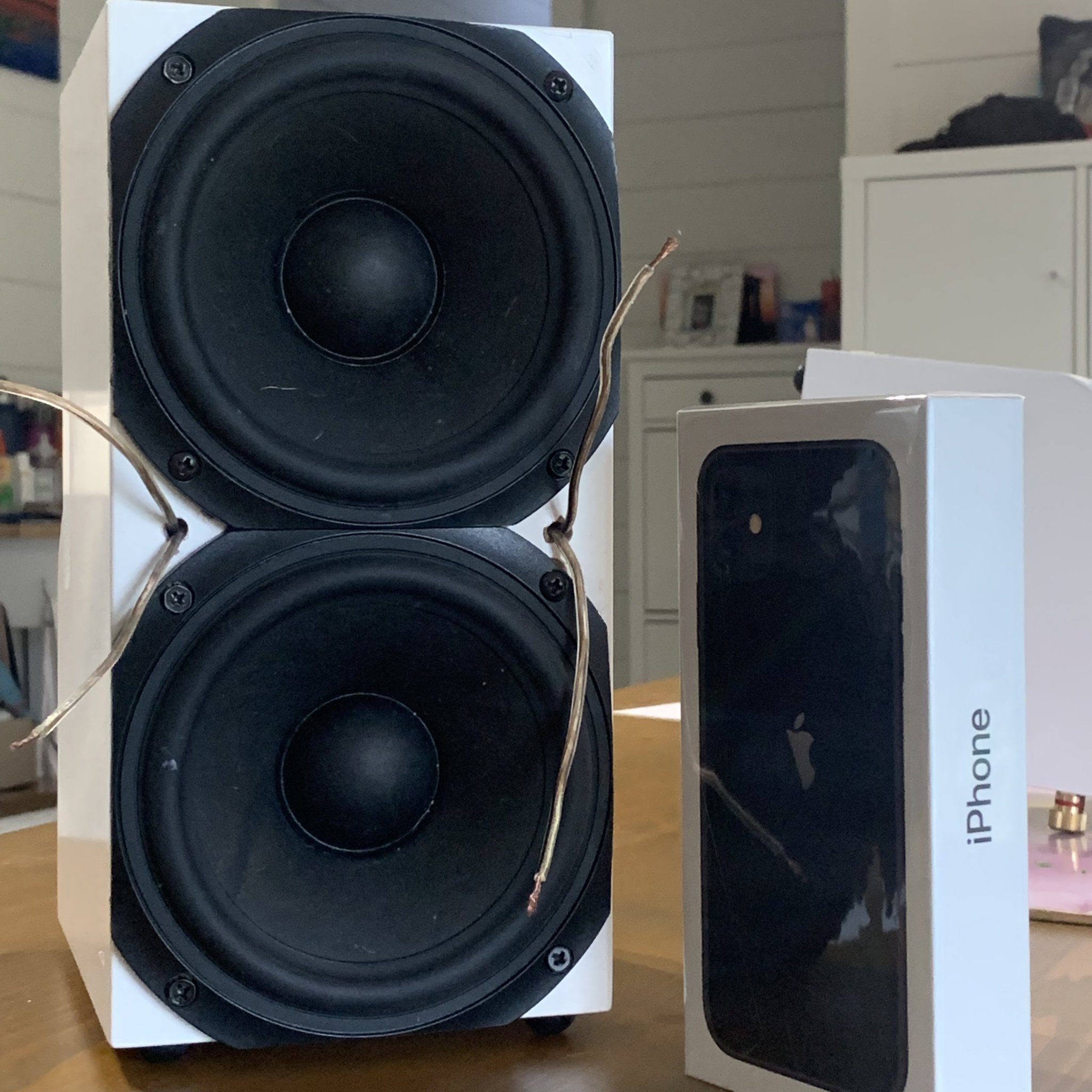

Here is a photo of rear of the smallest prototype, next to an standard sized iPhone (non-Max, non Plus) case.
If one were to build a plate amp version (TBD) on the back panel, the passive radiators can be moved to side panel, adjacent to the tweeter with little impact on the bass response. Aesthetically I much prefer hidden passive radiators/ports.

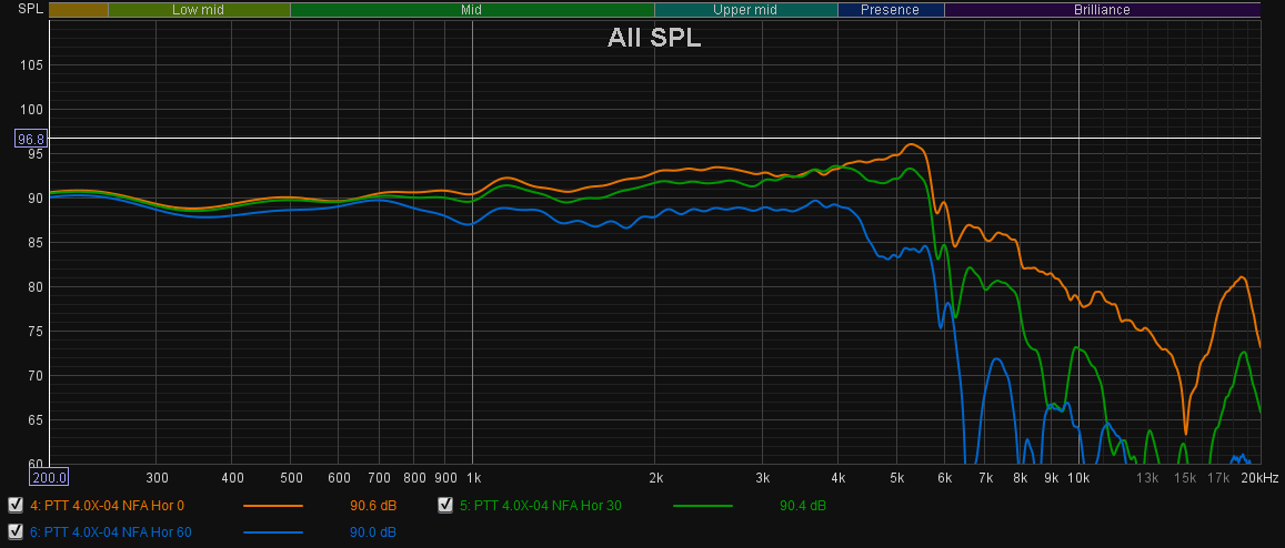

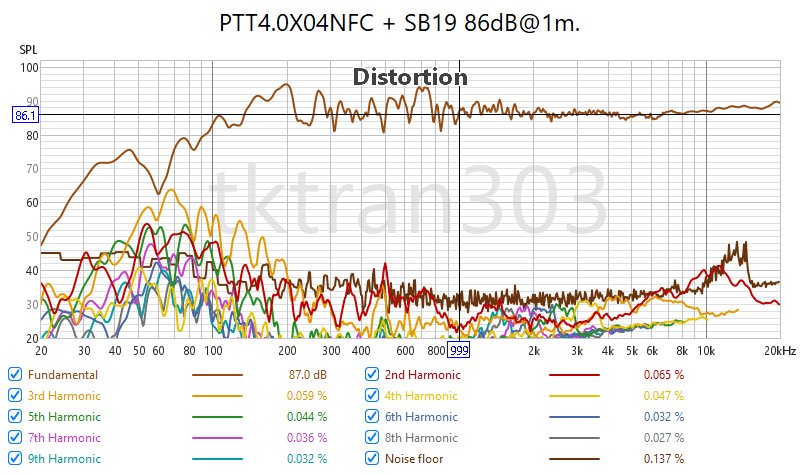

So I measured it- here's the PTT4.0X-04 in this cabinet, measured with a gate of 6ms.

I already have the old passive radiators and have lots of experience tuning it.
As you can see from the frequency response measurement it is VERY well behaved, without a crossover, or even baffle step compensation. It misses the top two octaves (4-16KHz) that a tweeter provides, but is very listenable as is.

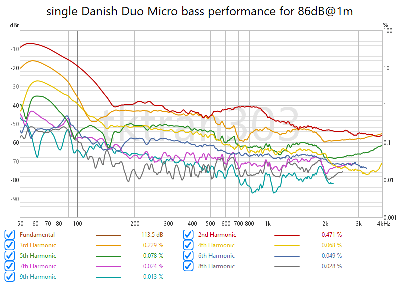

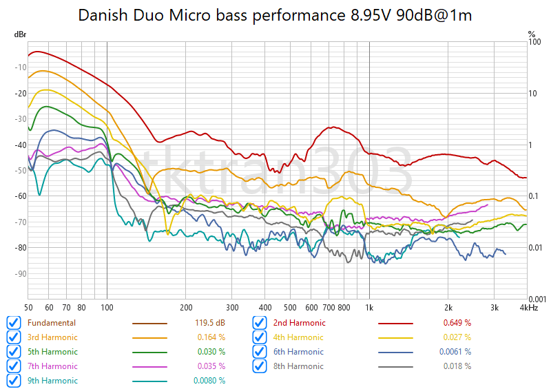

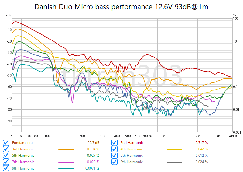

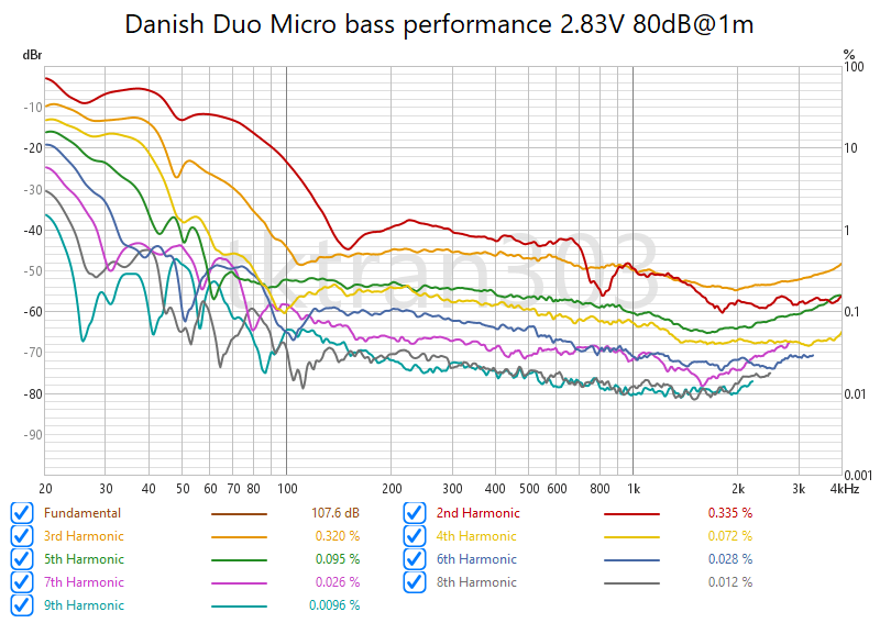

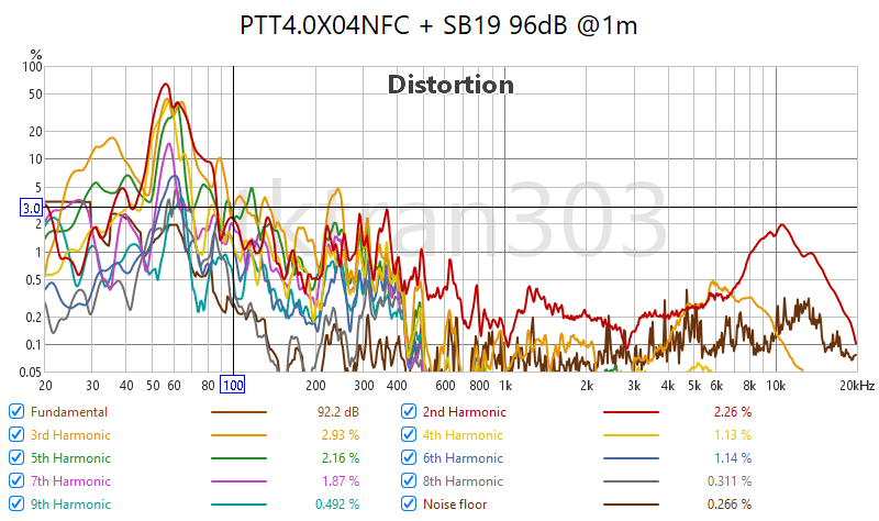

Lots of queries about the tiny speaker.
Here's the frequency response + harmonics + noise floor. NB. The dip at 60Hz is the from the room.
Cabinet is 3.5L internal.
f3 51 Hz
f6 47 Hz
f10 412 Hz
Twin SB13PFCR passive radiators may be rear mounted (-> invisible) or side mounted (-> force cancellation)

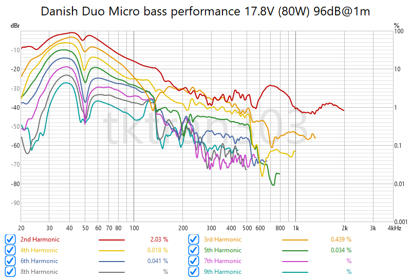

As you can see, this speaker is one for Spinal Tap- these go to 11:
