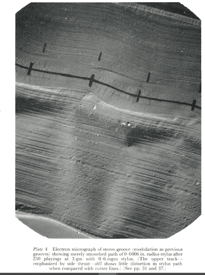

I wonder if you guys would care to comment on temperature rise in the vinyl caused by deformation. Back in the 1970s it was Received Wisdom that instantaneous temperature of the vinyl could reach 400F caused by the tons per square inch contact pressure. A few years ago I mentioned this in the Blowtorch threads and got a lot of push-back from strict evidence-only folk. Couldn't find any references in my library or on the web, but not everything makes it onto the web (yet), or is behind the AES wall.
Since y'all were able to make a credible estimate of deformation I wonder if this number can be translated into an instantaneous temperature?

Someone did the maths on here a while back (which I forgot to save) and the conclusion was that there isn't enough contact time with any patch of vinyl to melt it. Add to that the fact that diamond is a better conductor of heat than PVC and your cartrige would get very hot. As ever happy to be proven wrong!
The idea, back in the 1970s, went that contact pressure would temporarily melt a teeny-tiny depth of vinyl, which would re-freeze quickly. The stylus would ride along a temporarily melted track, like an ice skate. It seemed fantastic, but who knows? If significantly true it would have had implications for record wear and stylus contamination, but the whole theory depended critically on actual temperature rise.
Much thanks, and all good fortune,
Chris

Attached is an electron microscope picture showing a groove after 250 plays at 3g tracking force from Walton's book. No sign of melting. Note that this was done before scanning microscopes were available so I still haven't fully worked out how this was done.
